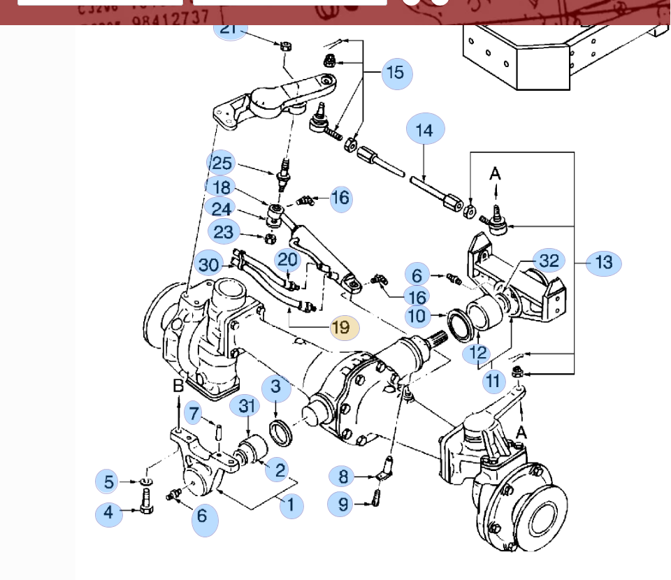

Gentlemen-I stand amazed at the level of knowledge here. I THINK I have searched for this subject but-if failed-please direct me to the correct location.
I removed my steering cylinder(2003 New Holland TC-29D-not super steer) for rebuild but in my haste I failed to mark cylinder hose connections at thru-frame fittings just rear of radiator. Am hoping someone can provide which hose (longer or shorter) goes to which fitting thru frame-the one closest to radiator or not. I had the repair shop replace hoses when rebuilding cylinder.

I don't know if this helps you or not but checking Messicks parts diagrams, it shows the hose #19 being the 500 mm long one, while the #20 is the shorter one at 400mm.
The worst it can happen is for you to steer left and it goes right and vice versa. It's just a matter of swapping hoses around.

Thank you sooo much-was thinkin of that but not sure about any possible damage-will do this asap and follow up!.
