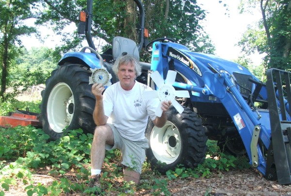

thanks again tractor friends, see picture of old and new fan below
<img src="http://www.richmondrugby.net/fan_fan.JPG">
By the way, I had to remove the spacer shaft/hub from the pulley to install new fan. I would need extra joints in my arms or special tools to bolt the fan onto the hub while the shaft and hub were still on the tractor.

I would use the one on my right, your left. :p
