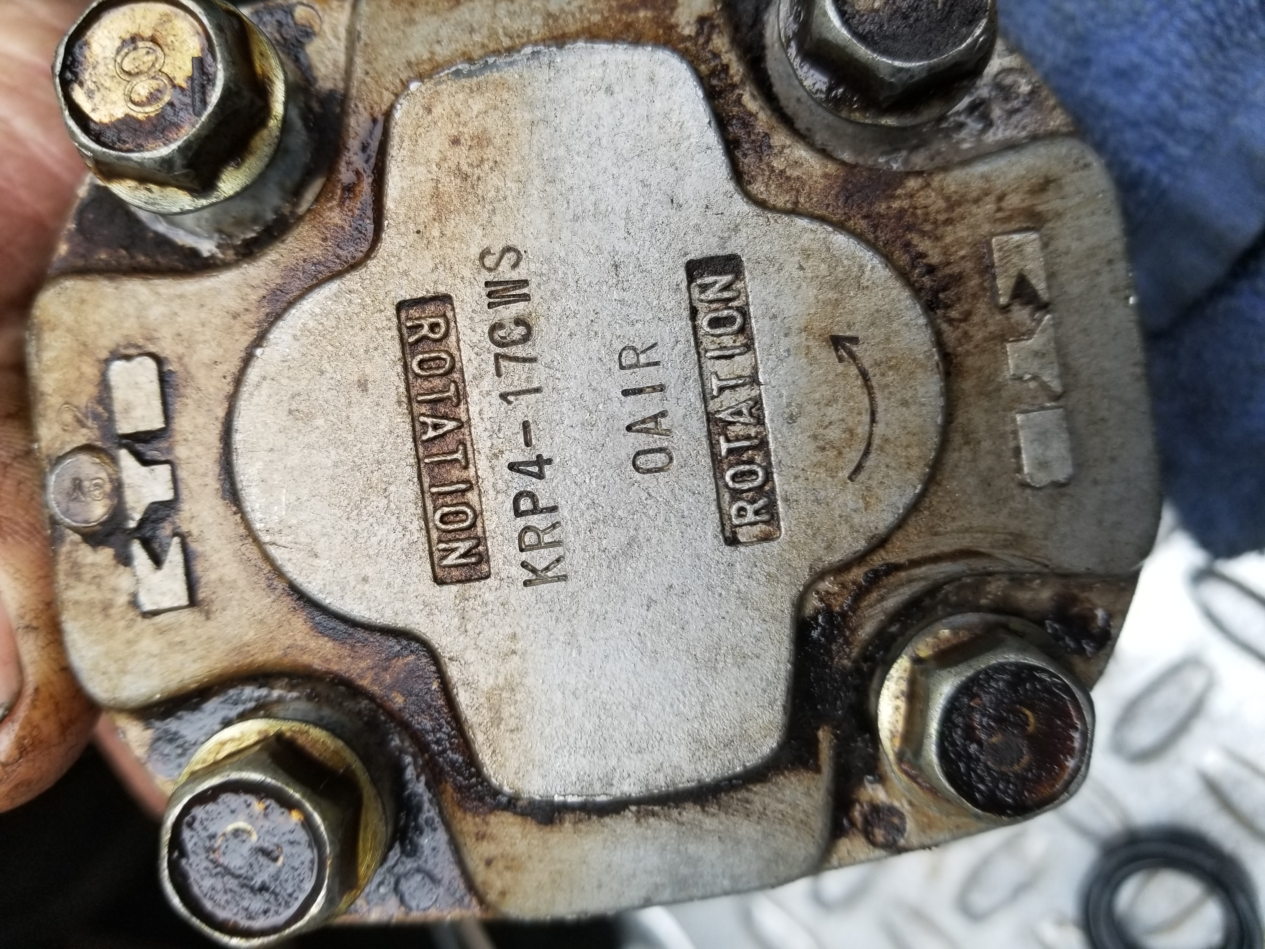

Hi Dwayne,
I got the pump out. There is only one seal? Jinman mentions 2 seals? Where can I find the squared off o-rings? Does anyone have an exploded view/ schematic of the pump? Much appreciation in advance!

Hi Steve,
The attached may help, not totally sure if its exactly for your pump. If all else fails you can take your pump to a dealer like Jinman did to have it rebuilt.
Good luck.

Thank you very much THClimer,
I have contacted Messick's in hopes of obtaining the seal and o-ring kit for this. See image of pump id numbers below.

Hi Steve,
Good luck.
I didn't have any trouble locating the seal kit on new Hollands parts site. Plus a very good exploded view of the pump.

I would like to thank all of you for your help. I was able to find the seal and gaskets for 1/10 the cost through a hydraulics supplier. And with your help was able to fix the thing, it is like new now. Thanks a million all of you!!!!!
   / Tc-35 Major oil blow/blow by out problem, from soft over flow tube on top of engine. #36
You did disassemble the pump completely and replace all the internal seals? If you didn't it will blow the shaft seal again.

Yes, everything replaced!
