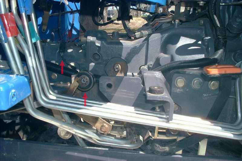

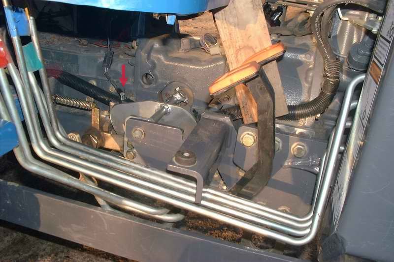

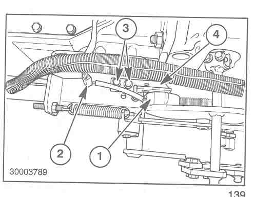

well after a long talk with the owner I agreed to the full price,Oh and the rears are loaded, he did tell me after taking it in for a recall in 2006 and got it back, he found that the cruise did not work, he called the dealer (who was quite a way away and they said they most likely forgot to re-hook the wires , bring it back and they would fix it, but since he never used it and he would have to hire to return it he didn't do it, so what should I be checking on that before i hand over a check, (not that I would use it much either) He used the 8 foot box blade for pulling snow.down the drive then used the FEL to pile it up.

...he did tell me after taking it in for a recall in 2006 and got it back, he found that the cruise did not work, he called the dealer (who was quite a way away and they said they most likely forgot to re-hook the wires. . . so what should I be checking on that before i hand over a check, (not that I would use it much either)
See the diagram below: #1 is the "donut" magnet and #2 is the plug on the end of he pigtail. This view is from the top and you won't be able to see it this way because of the operator platform. When you look up from the bottom, you will see a big plate like a "B" laying on it's side. Behind that plate is the magnet. See the second picture below with the plug being near the arrow. The third photo is with the "B" plate removed and you can see the magnet clearly. You'll need a good flashlight to inspect this area when laying under the tractor while looking up.

well, I final got it home, yah, but I had to give it to my wife for a 26th wedding anniversary present, but she loves me so much she let me move some dirt and put the brush hog I got her for Christmas last year, I hope tomorrow night to check the cruise stuff out, green light comes on, but doesn't stay on or make the cruise work.
