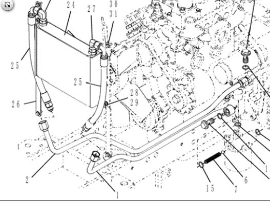

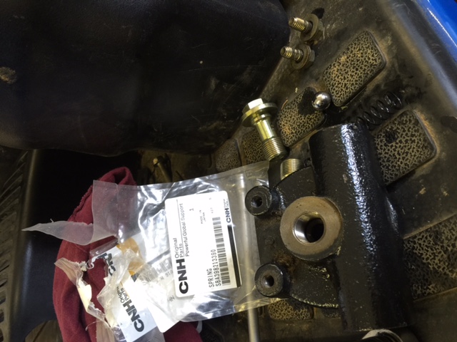

This is a old thread but, Im going to chime in and say that I have the T2310 07' model which replaces the TC40DA. I bought my tractor used and have been concerned with the chatter and noise being described here. I have done a lot of digging on filter heads ect. Im going to order parts from Messicks the parts I'm ordering are the following numbers. Spring#SBA398213390 price is $7.22 this spring is shown on under the (hydro and HST piping diagram.) Under the oil cooler diagram they show same filter head with a spring and a different part number. 86532703 price $2.90. The ball is part number 110680 price $1.33.
I'm going to compare the springs and install the stiffer of the two if there is a difference.

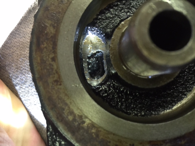

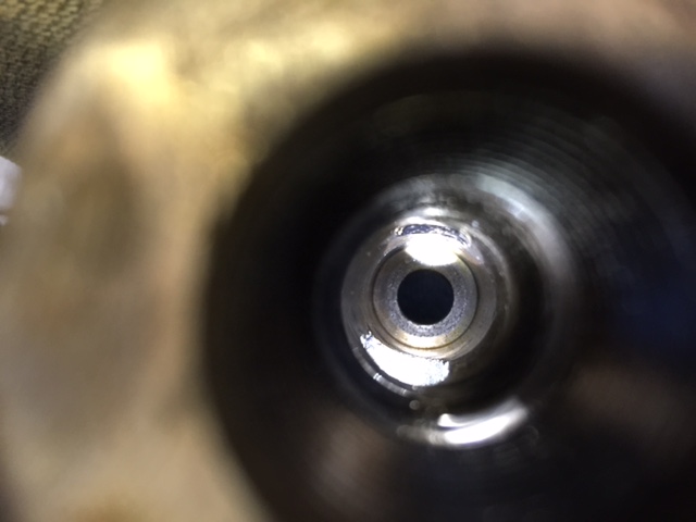

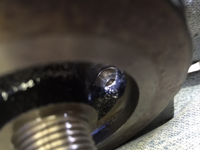

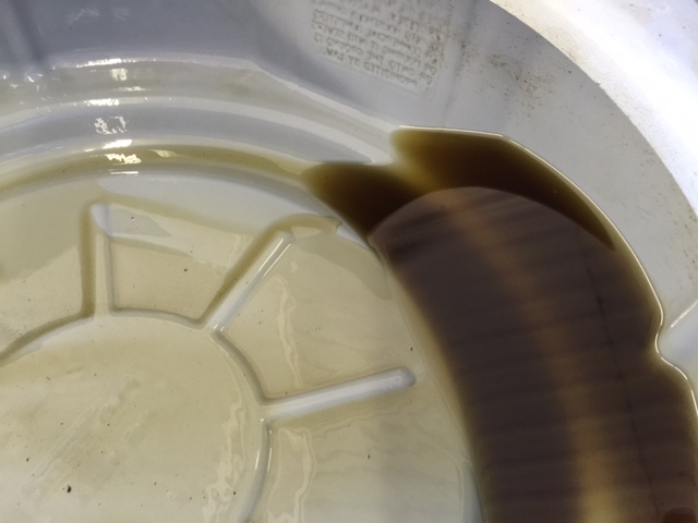

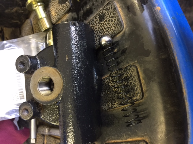

Took the tractor apart yesterday afternoon and here are my findings. HST has been bypassing for some time looks like judging on the pitts seen in the picture of the filter head. The two part numbers I gave are indeed two part numbers but are really the same spring. The tractor has 380 hours on it now and the filters look to have been changed because of the date codes on the base of the filters. I have a new HST filter with all new Case IH fluid and I suppose i would try a new suction filter as well while I'm at it they are 60.00 bucks but that's cheap if it works. I know color of fluid does not mean much but, the fluid I pulled out was darkish and has some smell to it. the new fluid is very red and looks more like ATF. I took original spring and lengthened it just because i had another one to use it seems to help some but, the unit is still bypassing.
Debating on keeping it simple and dumping all fluid and starting fresh with new Suction filter and HST filter and see where that gets me. for all I know the previous owner may have use OEM filters but used knock off oil or oil not spec'd to run in this tractor.
If i wanted to really get serious i was thinking of bypassing cooler as a test with a piece of pipe to verify its not clogged. leaning away from this because of the low hours.
The filter head does have some pitts in the ball seat and the repair manual states that if there is damage there to replace it with new filter head ball and spring.
long and the short of it to be continued.

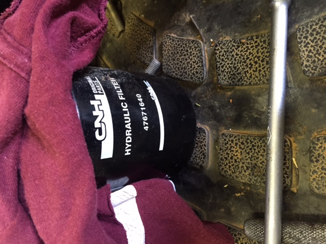

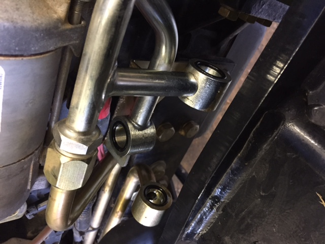

Here is a pic of the current filter on the unit and the area where i removed the filter head. Just a note you can remove the filter head with loader and frame on tractor you just have to have long arms and patience.

Here is something else for thought. the model TC40DA year 03 through end of production I think 06 shows a smaller oil cooler than is listed for the T2310-T2330 series.
The T series coolers take up the full size of the engine radiator. attached is a pic of the smaller cooler. Here is a theory and im by no means a pro hydro mechanic. The large cooler in my mind would take more volume and pressure of fluid going through it than the smaller unit simply because there is more restriction. CNH has updated the coolers to a larger size but, has not updated the HST bypass spring in the filter head. The pitts Im seeing in the filter head tell the story that the tractor has certainly been bypassing since new. Im going to go to a hydo shop tom. and try and source a stouter spring. I will then have to test everything to make sure that its not to stiff of a spring. Small_cooler.JPG

1.)I changed fluid and filters this made things better. The fluid that was in the tractor looked,smelled and felt different than the new fluid CNH HY-Tran ultratraction fluid. The fluid in the tractor smelled more like AW32 or something. The CNH Fluid is very thin almost like ATF.
2.)I went to a local hydraulic shop and bought a few check springs. I measured the spring with a gauge and came up with somewhere in the 17 to 18 lbs to defect the spring. the stock spring was only 6lbs if that.
I reassembled and things were improved more.
