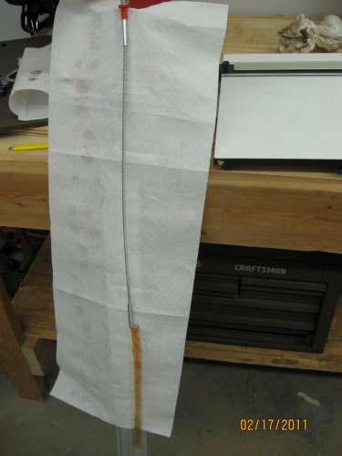

WOO WHOOOO!!!!! Got that bugger!!!
Gave up on tearing the top off. Took a pen light and shined it down the dip stick port (after removing the holder and d.s.). Could barely see into the filler port what with fuel tank in the way. Sooo, unbolted same and put a couple rachet straps around it and the ROP and jacked it up. Peeked down the port and there it was, still standing up. BUT, it was wedged in the gears under the dip stick area (must have turned as I put it in). If I had engaged the PTO I probably would have chewed it up. Any way, after much contortions and eye strain I snagged it. Glad that's out of there. Have to button it all up tomorrow.
Also tomorrow, I'm going to find a 5 gal. bucket pump (as previously suggested). No more tempting fate.
Thanks for all the suggestions, especially the "gizmo". Wasn't easy but it worked.
Later,

   / TC 40D "Into the unknown" #17
Really glad you found it! I admire your perseverance and ingenuity. Thanks for sharing your adventure.

"The "GIZMO" and the offending tube"
WAY TO GO! Your persisitance paid off! Glad you snagged it. Check out Harbor Freight. thay have bucket pumps for under $20, I believe. That's where got mine and it's perfect for adding UTF to tractor reserviors.
