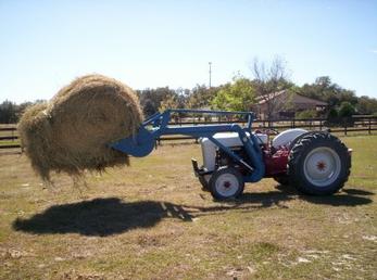

I move round bales in the 700-1200# range with an old 1955 ford 850 with 1-arm loader.. no power steering. IE.. you can't turn the steering wheel unless you are rolling. Drive my tractor for a week and you will love that 55...
And no.. that pic isn't photoshopped. What you can't see is that I have about a 400-500# concrete counterweight tub on the rear 3pt.. actually.. you can just make out the edge of it int he pic.. etc..

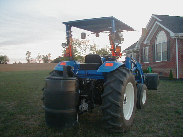

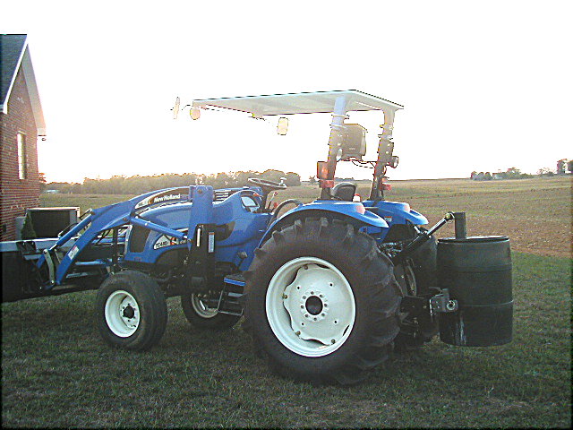

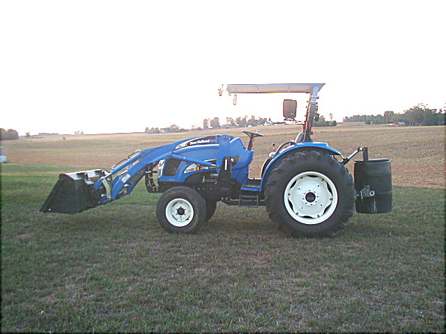

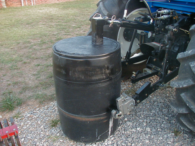

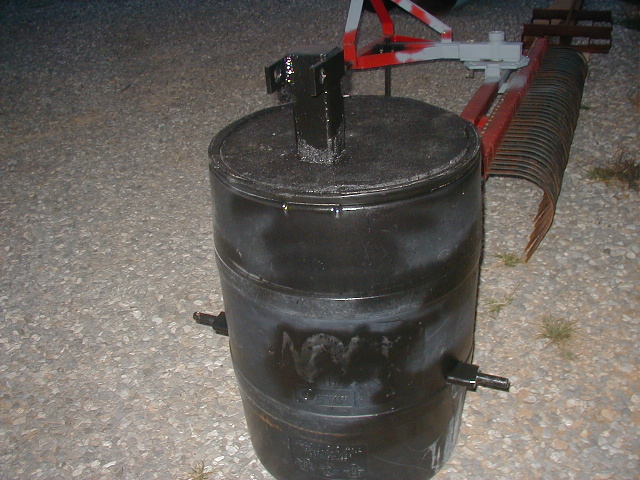

I agree 100%. Most of the round bales I deal with range between 1800 to 2200 lbs (depending on moisture). My 1200 lbs rear ballast works rather well. Take it off and the loaded tires is not enough. The rear fills real lite carry 1800 to 2200 lbs of hay on the front end loader. And I use a front end loader bale spear.
