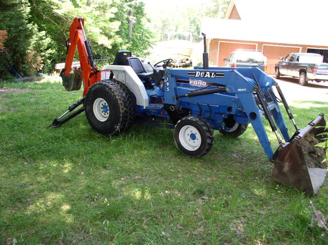

Shaley, Those skid steer fronts probably help you a lot since they are wide and very flat.
I was thinking of using skid steers on the front of mine if I could find rims....

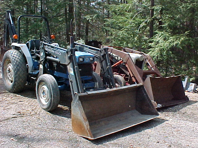

Dog, I've never seen those type of tires on a 2120. What option is that.
Here is my R3 2120
   / TC 55DA hard to turn when using the loader #18
Nice setup!
Yeah, the current wheel setup on mine has a lot to be desired. A cemetery contractor had owned mine prior to me. I would guess that he received it from the dealer new with 13.6x28 on the back and 8x18 on the front, both R-1's. Then switched to the 13.6x28 R-3's on the back to be less damaging to the turf, but had no tire options for the 18" fronts. So he put standard 2wd tri rib on the front. It actually works fairly well, but the tri-rib's are still a little too large on the outside diameter. I need to do something soon and change it around.
