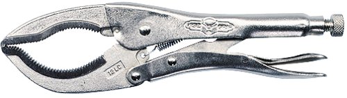

Don,here's a pic of that tool. dass
   / TC!8 Engine bogging down #18
That is one of the handiest tools I ever bought. It'll fit on most everything you want to put on or take off. dass

Jason, I think the filter was the fix, but thanks for the info about the solenoid - if I need it, it's nice to have the part numbers and stuff.
David, attached is the tool I ended up getting - not quite as ideal for the job as yours, and probably a lot more money because it's an official Vice Grip (about $18 at HD), but it did the job, and I wanted it Right Now! /forums/images/graemlins/grin.gif
