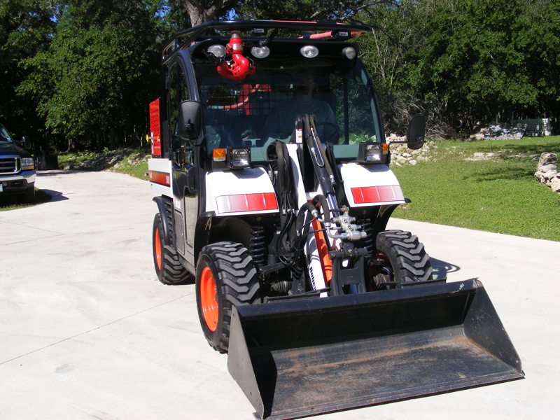

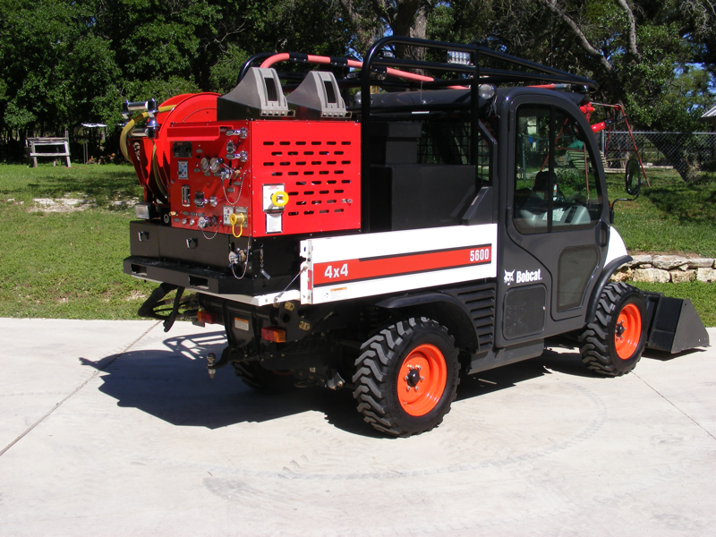

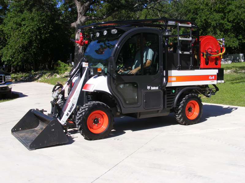

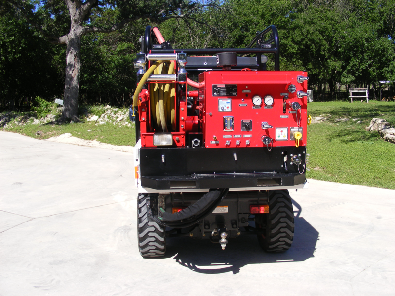

I agree. It is definitely not a 1st out apparatus but still think it would be a good support vehicle. We do several prescribed burns in my area so I have decided to build a small skid unit for the bed using extra parts from some of our trucks we have sold. The next time we burn I will take it out and test it to see if the department would want to follow through on such an investment. By the way I just found out I am not the first to think of this or even build one. there is a guy in south Texas that has been working with bobcat for the last 2 years in their testin facility and has a patten for a firefighting toolcat. He even designed a CAFS system and front monitor so the driver can control the entire thing from inside the cab and never have to get out to squirt water. Check out the monitor nozzle on the headache rack and in one of the pictures you can see the joystick that controls it.
