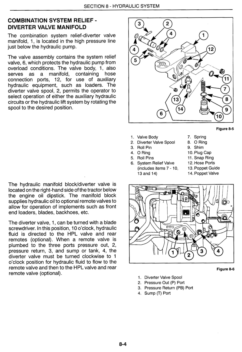

I want to add a new hydraulic valve to my TC18 and believe I can plug it directly into the manifold/diverter valve. My questions is do I simply run a line from the Pressure Out Port (#2) to the in port on the valve and then run a line from the out port on the valve to the Pressure Return Port (#3) on the diverter spool valve as shown on the bottom of the attached manual page?

I believe you have it right. You run from the pressure port to the remote valve and then from PB (power beyond) on the remote valve back to the PB port on the diverter valve. If your remotes have a "T" port, you plumb that all together and then to the "T" tank port on the diverter. Some valves have excess fluid that returns to the "T" port. The diverter slot placed at the 1:00 o'clock position will route pressure directly to the pressure port you've connected. It has to go to the remote valve and return before going to the HPL. I think it's confusing that they are calling the return the "PB" port. However, it would not be right to call the pressure port PB either because of the diverter function.

Steve, I looked at the description in my TC45D repair manual and it confirms the routing as you and I both stated. I think you are good to go. If you ever add a loader, you'll need to route the line from the PB port on your new remotes to the loader valve pressure side and then its PB port back to the PB port on the diverter. In that case, you'll have run a line up from the "T" port too. I think most dual loader valves require a "T" port.

Yeah, Steve, there was really nothing wrong with the way it was plumbed, just the materials used and how it was not secured properly. In effect, you'll be plumbing it before the HPL for the 3PH and the prior way it was after the 3PH. The way it was plumbed before, the diverter valve slot stayed in the 10 o'clock position. With the way you are plumbing it, the flow will divert to your remote valves first because the slot will be rotated CW to the 1-2 o'clock position.
