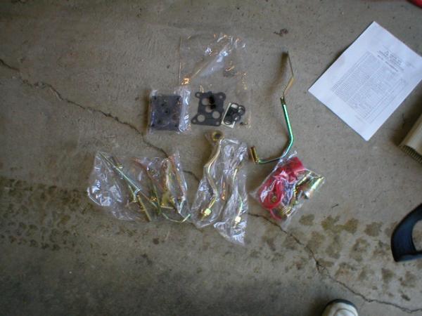

Picked up my remote kit today for the TC18. Bud, who delivered my tractor last year, offered last week to help me install them when I was ready. Of course he was off work today and I was ready TODAY.
Here are all the parts as taken out of the box.
Seat was removed to make life simpler.

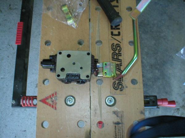

This is the new valve with the control lever attached. 2 roll pins are used to keep it on. NH suggests installing it before you install the valve. I think they were right on this one. It would have been very ackward to install the lever afterwards. I remeber reading here about removing the tire, but that was on a larger tractor. That wouldnt have helped at all on a TC18.

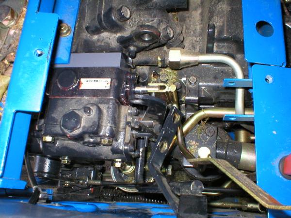

Old valve has been removed and gasket scraped off. Probably should have gotten rid of the grass while I was at it, but now I had an open hydraulic system and didnt want to get grass inside.

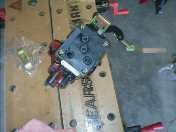

Old valve with original o-rings re-used, new valve, spacer and gasket ready to put back on. You get new o-rings for the new valve and spacer.

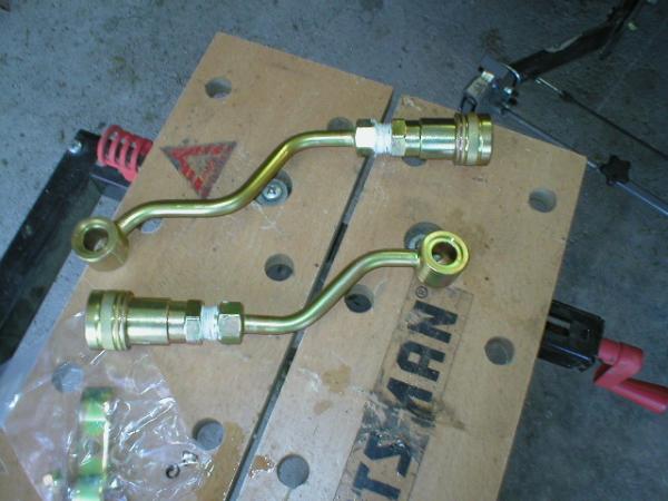

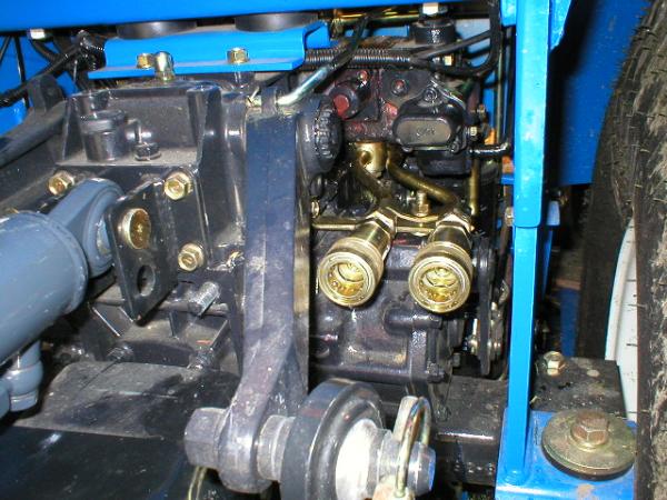

Oil lines ready to install after female half of couplers installed.
   / TC18 Rear Remotes
Oil lines installed. Man what a hassle. You dont have enough room to get the eyebolts in from the back, from the front, from on top. I finally inlisted help from my wife and a 24" extension to get them in from below. Thats after I jacked the rear of the tractor up to be able to get the extension in there. Of course this is also after one of the o-rings fell out when I dropped an eyebolt. Looked for that thing for about 30 mins. There are certain places on a TC18 you just cant get your hands in.

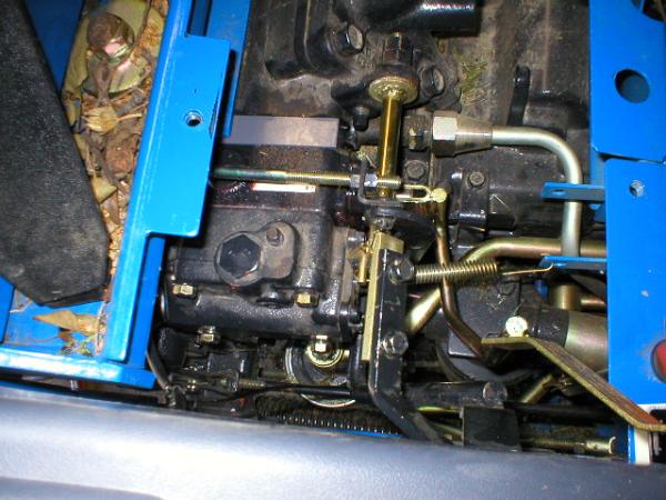

Because of the new valve and spacer shifting the old valve out farther, they give you new control rods and arms in the kit. See why the seat needs removed?

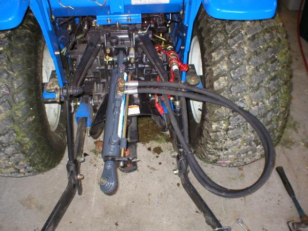

Everthing installed along with the hydraulic top link I got from Jim McCuan at http://www.topandtilt.com
I may need to shorten the hoses some.
