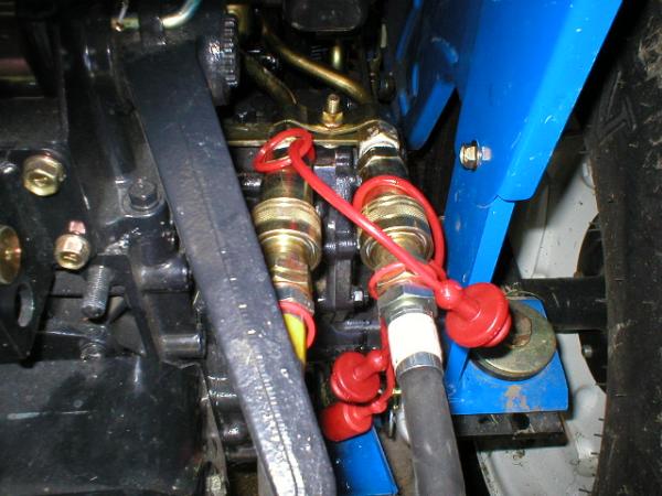

Closer picture of the couplers. Yes I should have put the ring on dust boot straps on the oil lines before I installed them, but no way was that coming back off at this point. I looped them around the lines and ran the cap back through, That will keep them on anyway.

All in all, it took maybe 3 hours, 2 sore knees, and 1 aching back. The instructions are a joke in my opinion. Nowhere does it tell you to re-use the old 0-rings from the old valve, but someone else here found that out....thanks for letting us know. Nowhere does it tell you where to mount the bracket. The picture makes it look like it mounts to fender mount. No you filp it over from what they show and it bolts to the casting. You're shown new lock washers on the mounting bolts and the remote bracket. That totals 5 washers, they give you 4. Thats okay because you remove 4 from the old bolts.

Inspector that is a clean installation. Did you need the restrictor on your cylinder to slow down the speed of travel? How do you like those extra long 60" hoses. I had the two for the side cylinder shortened by my NH dealer and the next time I go back I'll have the 2 for the top cylinder shortened as well. When they are too long they are bound to get caught on something and do damage elsewhere.
You are going to love the operation of the hydraulic cylinder. Fine tuning of a box-blade is a snap.

Haven't used the box blade yet, but the travel on the cylinder doesn't seem to fast right now. Might be due to the lower flow on a TC18.

Wow! That is a good price my dealer wanted $600 for the kit. Needless to say I think I will try somewhere else. Does your do mail order?
The female end on the left looks a little close to the lift arm. Is there plenty of room for things?
