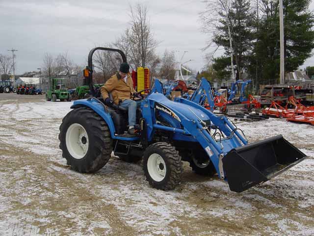

How much time do you have on your hands? The 10-11 acres of field mowing will take you 8+ hours with a 4' cutter.
Here are some pics mowing my Dad's acreage in Maine field mowin in maine
Dad has since bought a TC40 with 6' cutter (see attached)
I'd look at the Class 2 (TC33) or Class 3 (TC40) machines...
