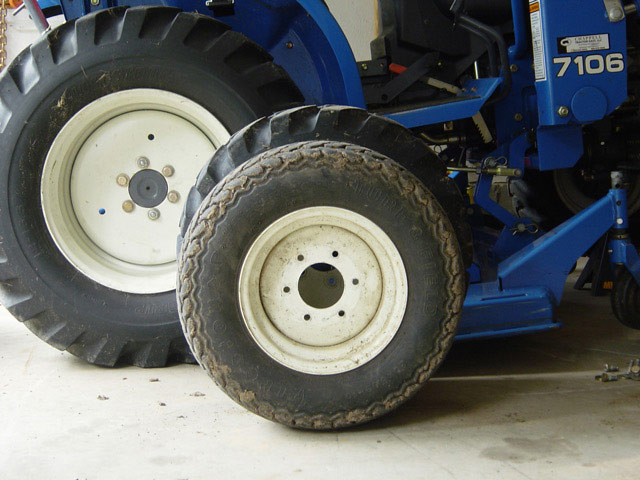

I have R4s and turfs for my TC18. The turfs are significantly smaller diameter than the R4s (see attached) and they squish to a smaller "effective" diameter under load. I can climb the hill up from the backyard in high range with the turfs, have to switch to low range with the R4s....
