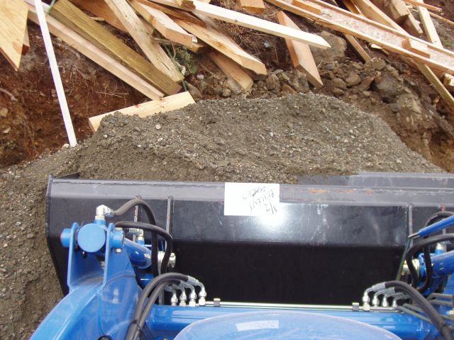

Jinman, that ditch you posted a picture of makes me laugh at my feeble attempts to fill the bucket so far. I've got a couple yards of D1 I've been playing with and the first few tries have seemed pretty sad. So far when I dump the bucket it seems like I could've moved as much w/ a big coffee can ...but I'll stay after it and we'll see what happens.
I've attached my first attempt at filling the bucket just so you all could cackle at how what you take for granted actually doesn't come naturally. Be gentle, and remember that this is a maiden experience we're looking at here.
Thanks again for the comments ...and I'll keep my seatbelt on!

<font color="blue"> I've attached my first attempt at filling the bucket just so you all could cackle at how what you take for granted actually doesn't come naturally </font>
Been there, done that. It's not so long ago. Within a few months you'll be cackling at yourself. What I can tell you is the first time you actually get a full bucket in one scoop, you'll get such a warm feeling that you won't mind the Alaska cold! No point in running off to get someone else to appreciate your accomplishment, though - they just won't understand. Fortunately, I have a son-in-law next door who is obligated to show appreciation of such feats or I won't let him use the tractor... /forums/images/graemlins/wink.gif

Don't worry on filling that bucket. Dad taught me when I was much younger, best is to hit the pile with your bucket tilted just a wee bit forward and as you go into the pile start rolling your bucket back. You will fill that bucket right up and sometimes you will fill it with more than you want depending on what your filling. Dirt and manure can pretty heavy and becomes unsafe.
murph

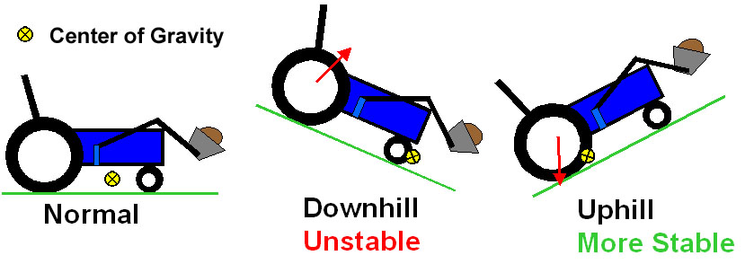

I had to "drop in" again on the subject of safe operation of your tractor on a slope. I'm not sure how cold it gets in the winter, but even in Texas we put anti-freeze with the water we add to our tires. Yours might have to be a 50-50 mix or you could use some other liquid other than water which would not freeze. I don't have filled tires on my tractor, but I carry a pretty heavy boxblade on the 3PH. If you don't like the idea of loading your tires, the wheel weights might be your best option. From the looks of your pictures, I think your tractor will see plenty of hours working on slopes.
I've also attached a simple sketch to illustrate what center-of-gravity does on a flat surface, downhill, and uphill. Think of it like a pendulum suspended from a point just about your hood. When you go down a hill, the pendulum moves forward and the rear wheels tend to lift. If you are going uphill, the pendulum moves backward and the rear wheels actually carry more weight than on a flat surface. I can't put a number to it, but at some angle, the rearward weight will be so much that you overcome the friction of the tires and you will slide backwards. I don't think you are anywhere near to that point yet.
Finally, if you switch your wheels side to side, you will have to reverse your tires or the cleats will be backward and all your traction will be in reverse instead of going forward. Nothing is ever simple. /forums/images/graemlins/crazy.gif

Xlnt sketch, Jinman. Thank you very much. As far as your comment about "nothing's ever simple", I beg to differ. I know for a fact that there's a fairly simple connector between the seat and the steering wheel on my TC24 anytime I'm on it /forums/images/graemlins/tongue.gif ...and JWStewar, I was thinking the same thing.
I know how stable it is on a hillside and it looks like I'll see how stable it is w/ both rear wheels off.
