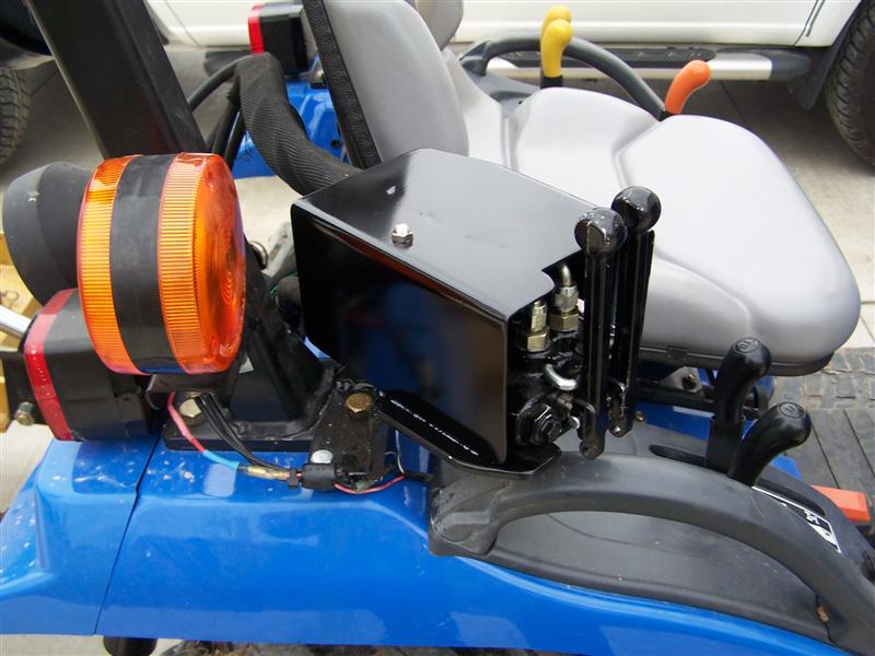

The valve protection cover was fabbbed up yesterday and painted last night.
   / TC24DA Top and Tilt.
#22
Another view.

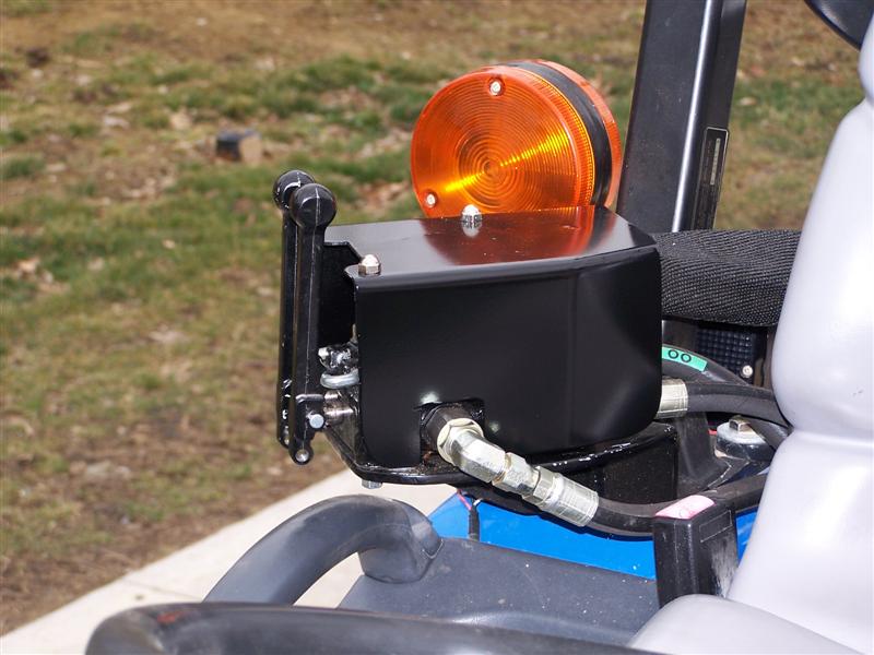

#23
And another.

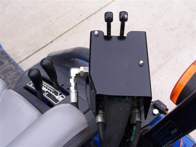

#24
Last one. This has been working really good and I'm very happy with how it all turned out.
   / TC24DA Top and Tilt. #25
Ok - thanks! I was a bit bewildered by the oreintation of your valves, & what the cover was going to be all about. Now I get it - that way works then! Never thought of pulling over the valve body, & putting an armrest on, typically those valves are 180 degrees the other way. Cool project, thanks for all the pics & info.
--->Paul
#26
Paul,
The angled position of the valve puts the levers right at the finger tips, especially when I'm turned sideways looking over my right shoulder. I did not want it to stick out too far past the fender and yet still leave room for when I get around to getting the armrests from New Holland.
   / TC24DA Top and Tilt. #27
Yea - outside the box thinking. /forums/images/graemlins/smile.gif Would also keep your forearm warm in winter with the oil under you. Tho hauling manure here in summer would get a little warm. /forums/images/graemlins/smile.gif
--->Paul
