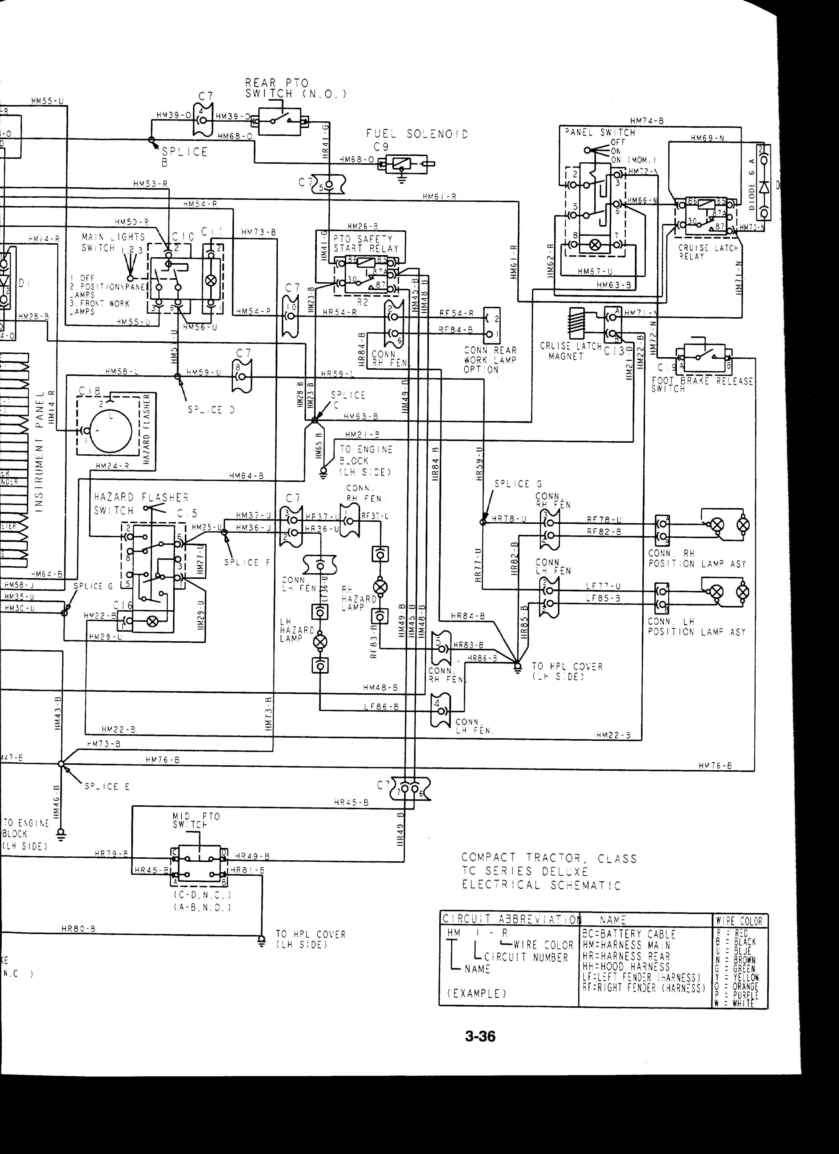

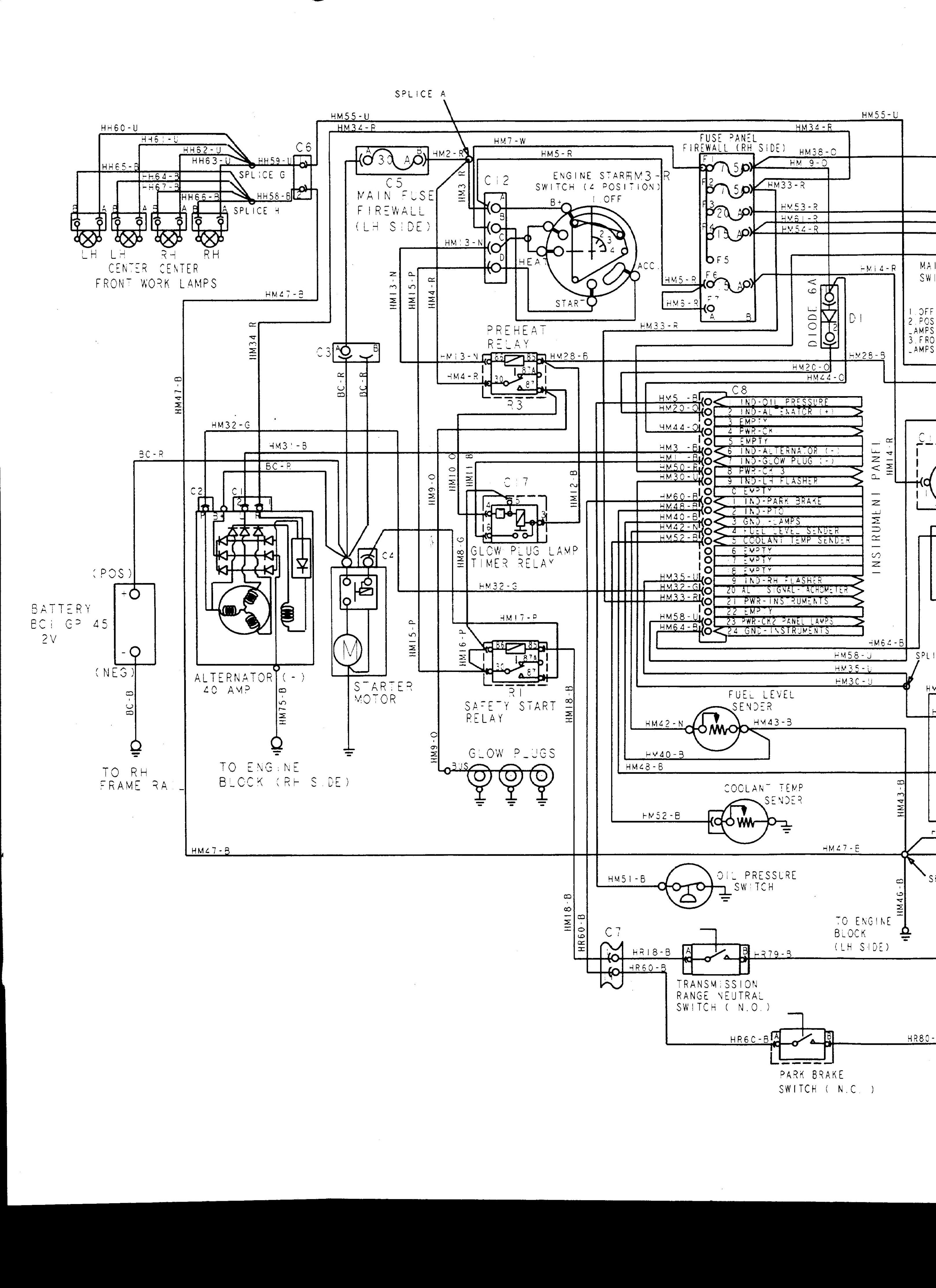

It's been awhile since you had a problem. Could you send the wiring diagram? I have a 2003 TC33D that keeps blowing #5 fuse.
Thanks,
   / TC25D - Fuse #5 Blowing #13
Here is the wiring diagram for your TC 33. I had the same issue that started for no apparent reason. Retracing my steps prior to the repeatedly blowing the 30 amp fuse, I found I had removed the ignition key and reinserted it upside down and that is when the problem began. I now have it marked with a top and bottom and have not had a blown fuse since. Other suggestions for the problem is a self-resetting circuit breaker in place of the fuse and possibly gong to a 40 amp fuse that the later models have. BUT FIRST check the key.
   / TC25D - Fuse #5 Blowing #14
View attachment 384612View attachment 384613
Can you explain how the orientation of the key causes the fuse to blow? I am researching a repeated blown 30a fuse on my TC25 and came across this thread.
In my case I went to start the tractor last week and had no power like a dead or missing battery, no lights, nothing had power. Last time the tractor ran and I put it away without incident. After locating the cause (or so I thought) I got a replacement 30A fuse and installed it. When I turned the key to energize the glow plugs the fuse popped in less than 2 seconds. It was cool (about 50°F) that day. So two blown fuses with no apparent reason I am looking for answers before I put another fuse in. I've had the tractor a couple years and never popped any fuses, don't understand why now without warning this fuse blows.
   / TC25D - Fuse #5 Blowing #15
I can not explain why the up-side-down key makes a difference and can not see a noticeable difference in one side compared to the other, but it obviously makes a difference in the start switch. I do know that if I tried to start the tractor today with the key up-side-down, it will blow the 30 amp fuse. I went through a box (5-6) of fuses before I retraced my steps and reversed the key.
