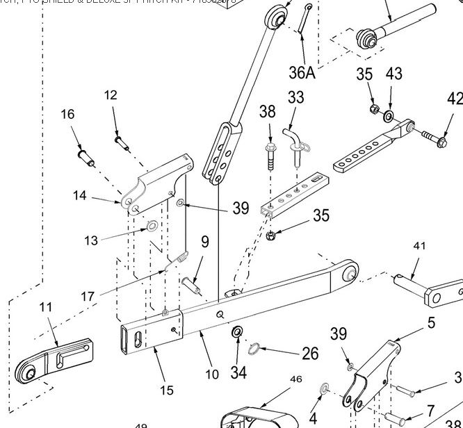

One thing for sure, the extendable arms on the 3PH need lots of attention. Don mentioned that the "dust cover" was missing off the left side. That is NOT a dust cover. It is a spring loaded release sleeve that operates the bolt that drops into the slot on the extendable arm section. The front of the cover has a spring under it. You press down on the front of the cover and it pivots on the front pin and raises the locking bolt out of the slot. When you release the sleeve, the spring pushes it back up and locks the extendable arm when it moves forward to the operating position. Don's left side extendable link must be locked in place or the locking bolt is loose enough to move up and down by hand. If that's the case, only gravity and weight of the bolt is holding it in place. I can see on the left arm that the front pivot pin is completely gone as is the sleeve and spring. See the illustration below.
Now we're cookin' on the front burner...I am missing the springs. I couldn't figure out what held the assembly in the correct position
and it has to be the missing springs. Thanks Jinman!
