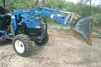

   / TC29D Grill Guard #3
I just got my TC33DA with a grill gaurd. They tell me that the frames on the TC33 and 29 are the same and that the front end on the old models and the new DA's are the same. I'd think one should be available for your TC29. Maybe try another dealer?
Jim
   / TC29D Grill Guard #4
When I bought the new tractors for my business and home I ordered 2 grill guards to fit the TC40D .........The one for a TC40d was a direct bolt on with absolutely no modifications to my TC33D...........Should also fit the TC 29 too.........Tom
   / TC29D Grill Guard #5
Jsheds:
Could you post a photo? I think we just stumbled upon a discovery! To my prior understanding, NH did not offer a grille guard for Class IIs, just the Class IIIs. Could it be that the same part fits BOTH TRACTOR CLASSES, but since the 16LA Loader can be mounted with it inplace and the 7308 can not, NH lists it as available for Class III ONLY? How about those owners who don't have a loader? How about those owners who would not mind adding & removing the bumper as they add & remove the 7308? I, for one, would get one for my TC33D (with 7308) if it fit well and did not interfere with headlights etc. Just my own $0.02
   / TC29D Grill Guard #6
Here's a pic, I don't have a close up handy.
I'll try to remember to get a better picture for you.
Jim

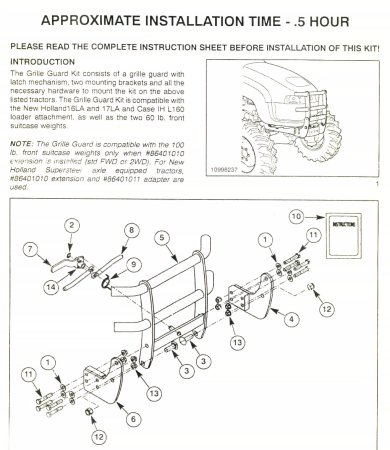

MGRIGGS this is a exploded picture of the Class III guard. I don't know if it will work for your purpose or not.
   / TC29D Grill Guard #9
That looks just like the one on my TC33DA. I've got the 14LA loader, maybe it doesn't fit with the 7308?
Jim
   / TC29D Grill Guard #10
The installation instructions list the following models.
New Holland:
TC35
TC35D
TC40
TC40D
TC45
TC45D
Case IH Models
D35
DX35
D40
DX40
D45
DX45
