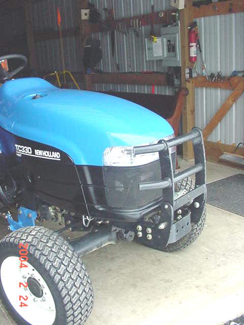

Attached is a picture of a TC40 grill guard installed on my TC33D. The TC29 is the same tractor with less HP. As you will see , it's a direct bolt on with NO modifications. I don't use my TC33D for loader work, so I can't say if the guard will interfere with the loader arms or not..............I have around 200 large pines bordering my property and my wife loves to mow close............The plastic hood would be gone if not for the guard...........Hopes this helps..........Tom

Another view of mounting area from the side...........

This is true it will work without a loader but the center bar on an older 7308 loader will hit the guard if used with a loader.

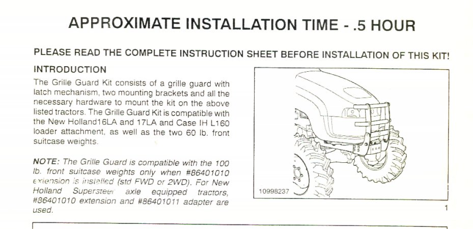

PineRidge: Thank you for posting that exploded view! It was very helpfull. I wish that I could read the Note about compatability, but it is too small and somewhat obliterated. Is there a way for you to post a larger version, or post the wordage that applies to front weights and Supersteer. I have both 100# suitcase weights and Supersteer to deal with. Thanks again,

Arthur see it this is readable. If not let me know and I will type it. /forums/images/graemlins/grin.gif
