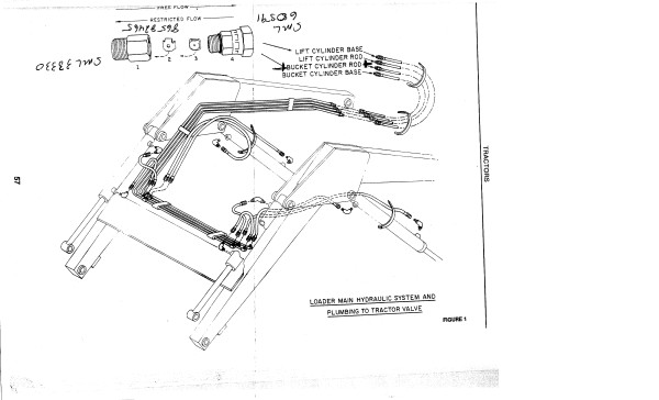

Just curious to know what you found out about the fix. Did you get your problem resolved yet?
   / TC30 Loader Waving In The Wind
#12
I haven't got it fixed yet. Some parts are in but not the orfice. I found out about the problem by trying to back drag with the bucket and had no pressure to hold the bucket in position. When I called the dealer about the problem, they called New Holland, they knew about the problem and suggested the fix. When the orfice comes in I'm going to install it myself and I'll post the results.
#13
the fix is in. part numbers are 1-fitting, SML 60591, 1-fitting SML 33330 and 1-orfice 86585465. Very easy to replace. It goes at the control lever box. Dissconnect the bucket cylinder rod hose and put the new fittings between the hose and the control box. This is a NH fix and they are well aware of the problem. The parts were covered under warranty. i'm going to try and attach an diagram.
   / TC30 Loader Waving In The Wind #14
I missed your earlier posts but just caught up. My TC18 with 12LA loader is exhibiting some of the same symptoms. I wonder if the same kit works with the 12LA? Did you contact NH directly, or did your dealer do it?
#15
i called the dealer and explained the problem. they contacted NH and now there is a repair notice on it. the dealer was explaing that Nh has a new system that they pop a problem into a computer system and it checks worldwide for the same problem and finds the repair. if the problem hasn't been noted yet the techs look into it and come up with a solution. when they get enough complaints on the same problem they put a tech bulletin out with the fix, as they did with my problem. at any rate, i'm rambling here, they know about the problem and have the fix. i don't know if the tc18 uses the same orfice though.
#16
i was unable to post the picture on the forum but i did put a scanned image of the fittings and hydraulic lines in my photo forum. if someones gives me a heads up on how to get a picture into the forum i will do it. thanks.
