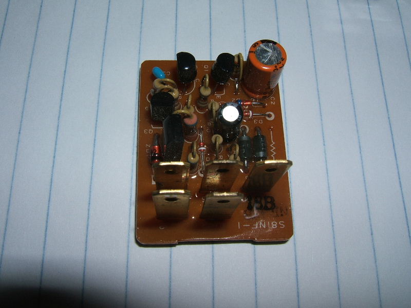

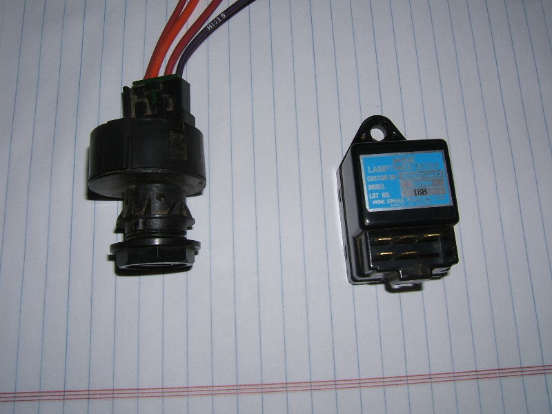

Well, I finally got around to replacing my ignition switch and in the process I believe I found my intermittent glow plug problem (with turning the ignition switch to the first position the glow plugs would not power up).
Due to previous starting issues I had removed and disassemble the OEM switch only to find out how flimsy it was (see attached pictures). Some of the plastic pieces (which is mostly what the switch is made of) were even melted. Since I needed to run the tractor that day I put the pieces back together the best I could and amazingly it worked. Now with the weather being nice I decided to perform the ignition switch swap before the snow starts flying and the wind whipping.
I replaced the OEM switch with one I purchased at NAPA like others have done. I put everything back together and my intermittent glow plug problem was back. So I opened up everything and started turning the ignition switch and wiggling wires. Come to find out, by wiggling wires to the glow plug timer relay I cold get the glow plugs to come on and go off. So I thought must be a loose wire connection, but no, turns out the circuit board inside the relay was flexing causing a loose connection.
So now with a new glow plug timer ($52) everything is working just fine and I'm sure my tractor will be much happier starting when its 20 below, me too since I won't be out there shoveling snow by hand.

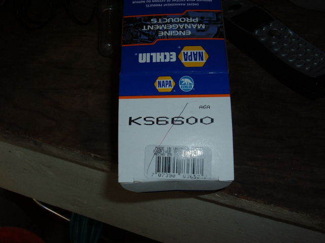

Can you share a picture of the NAPA ignition switch and a part number?
/ TC33D Glow Plug Problem Fixed
I used the same NAPA switch (Part Number KS6600) that 泥AVCON used in his post dated 10-15-06. I didn稚 take any pictures so here are the ones DAVCON took. I connected mine the same except I connected both my red wires to the BAT terminal, Purple to ST terminal and the Orange to IGN terminal.
This is a very beffy switch.

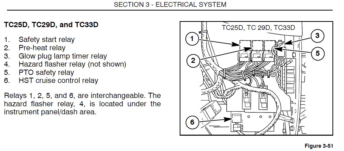

where is glow plug timer located on tc33da
#13
