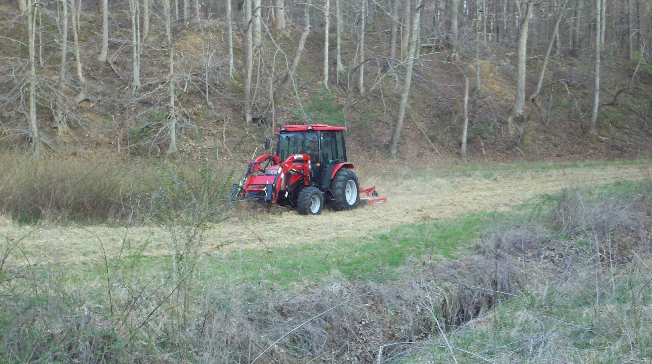

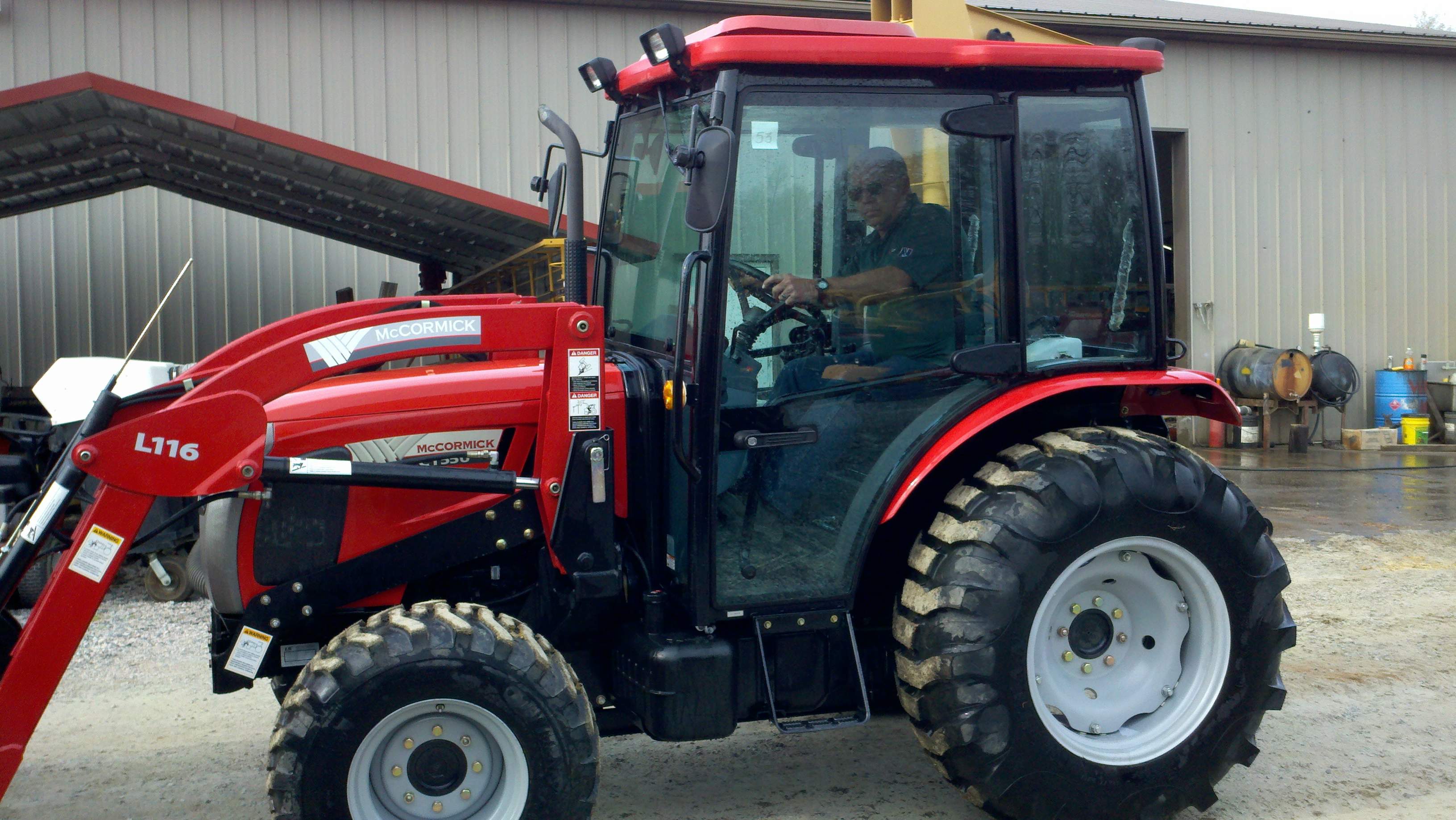

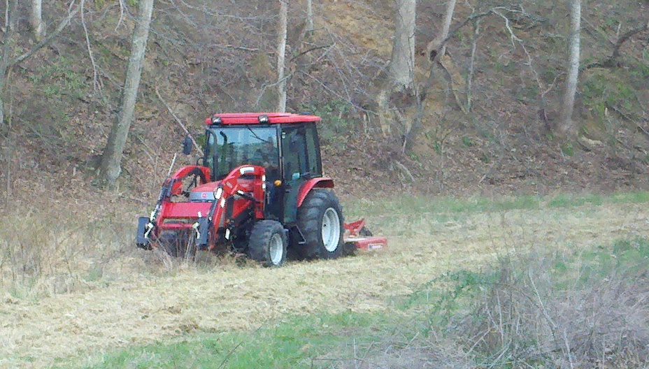

Hey guys heres the new CT55U the reason the New Holland TC33D now resides in my building LOL.:thumbsup:

Nice McCormick! I'm amazed at how closely the L116 loader looks like the New Holland loaders.
