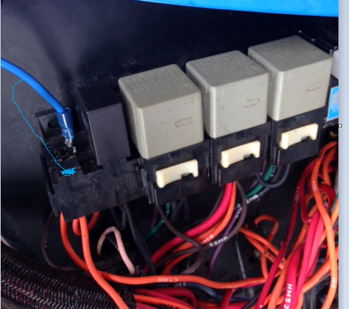

I tried to attach the picture of my relays, but it is not coming up. Capture.PNG. OK it is going to come up.
I removed the first relay and made a small blue jumper with spade ends. Everything seems to be working fine now, but it is not the way I like to fix things. Since my manual does not have my particular wiring harness I do not know where all the of wires go to. I will mess with it as the weather gets better, but I get more confused and angry trying to figure things out without the wiring diagram. Palmetto fared well with that storm not even the first palm fron fell out of a tree. I bought this tractor from a guy in Ruskin. Got a great deal and this is really a great tractor.

I just copied the photo, thank you. I can't tell where the other end of the jumper goes from the picture. Can you advise?

Hey Paul
The blue wire goes where I drew blue line, I am pretty sure it is in the first slot closest to you on the relay. I will take a picture of the jumper installed and send it to you when I get home later.

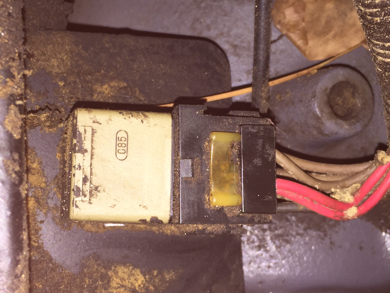

Well, I'm sorry to have to join this thread.... it means my TC33D is also not starting. I have power, 12.85 volts at the recently replaced battery and similar voltage at the starter positive cable. Voltage drops a tad to 12.5 when the key is turned and all I can hear is a click from the area where the 3 bosch grey relays (Image attached) Lights dim only very slightly when trying to start.
Also the plug to the right of the bank of 3 - not sure if this is some type of regulator? Does it have anything to do with the starting or glow plug circuits?
There is also one more bosch relay about 10" below the main electrical group. (Image attached) also - what is the right way to remove these without damage? - Do you just pull them straight up or is there some type of release.?
All the fuses in the fuse block look OK. There is one inline fuse that is OK by the starter but I think there may be another one behind/below the alternator that I have not gotten to yetIMG_4435.JPGIMG_4433.JPG. I ran this tractor with no problems this morning and have never had an issue aside from a couple of occasions where I have had to jiggle/re- tighten the key switch. The only issue with starting I've ever had is the starter "likes" the neutral position between 1st and 2nd range but not so much the neutral between 1st and 3rd. When I look at this switch under the fender, it has a little white wheel on a spring that rides like a lobe on the shifter linkage - maybe the plastic wheel has worn and not depressing enough? I tried to push it down manually while my wife tried the key but nothing happened - can it be bypassed to test if the switch is working?
