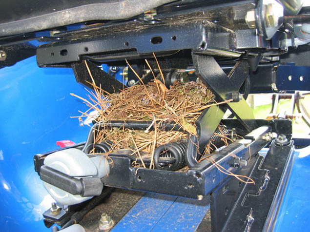

My TC 29D has been sitting outside, unused for about a month. Went to start it yesterday and it wouldn't start. Just like others on this post, mine is new (bought in May) and only has about 14 hrs on it. When I turn the key, the normal dashboard indicator lights come on, the preheater light goes out after the appropriate amount of time but when I turn the key to start, nothing happens. I checked the range selector - took it out of and then put it back into neutral, reset the parking brake. As I am writing this, I realize I didn't try the other neutral position and I recall reading here that sometimes this helps. The question I have is - does this sound like a fuse-related issue? Seems to me that if it were a fuse I would not have had any indicator lights come on. But I readily admit that I am a moron and don't claim to fully understand circuits, tractors, or pretty much anything at all.
So, can anyone offer some guidance here? Thanks in advance.

When I got home this afternoon, I checked into TBN to see what had been posted. After reading your reply, I was ready to take out the battery and charge it up. So, I changed clothes and went out to solve this problem. When I looked at the battery terminals, they were perfectly clean with no corrosion. Hmmm. I decided to look around before taking the battery out and charging it for a few hours. In looking around I discovered a new addition to the tractor. <font color="blue"> See attachment. </font>
Well, I immediately thought that this was interfering with the seat switch and, thus, the cause of my problem. Once I looked closer, I realized that this bird's nest was nowhere near the seat switch. After cleaning it out, the tractor would still not start.
So, I did what i should have done first and pulled out the owner's manual. Looked up the fuse panel and immediately saw that the dashboard indicator lights are on a different circuit than the fuel shutoff solonoid/operator seat switch/ range neutral safety start switch. So, I go out to look and sure enough, I had a blown fuse. A quick trip to the auto parts store and I was back in buisness.
So, I apologize for wasting your time by asking a question before doing my homework first. The maxim that common things occur commly certainly applies here. But in the end, everything worked out and those who are interested got to see a photo of a nest built by a tractor-loving bird.
