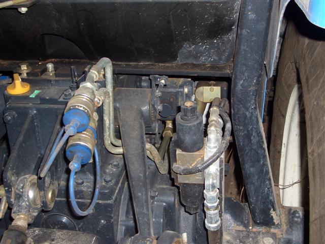

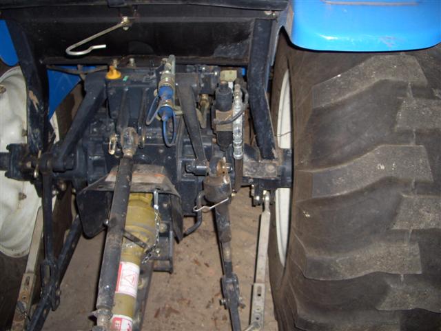

try a WR Long Electric over hyd kit. it goes in-line with the loader and allows control of the grapple as a third function on the joystick. you can lift, curl and close the grapple at the same time. The valve mounts on the rear axle under the remote valve block. Joystick ball replaced with new handle with rocker switch.
Jeff

I went through this process this spring while removing stumps. Uncoupling hoses under the tractor to switch between the grapple and backhoe got old very quickly. My dealer installed a power beyond kit on the backhoe itself. Now I can operate the grapple and backhoe without recoupling hoses. The 3 point hitch will remain functional so I would recommend a lock-out lever to prevent accidental use of the 3-pt. By the way Worksaver makes a compact tractor duty grapple. I'm very pleased with the new setup. Good luck!

Thanks for the replies and pictures.
