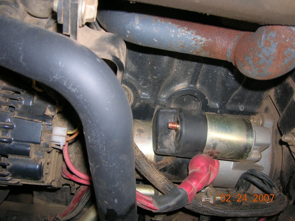

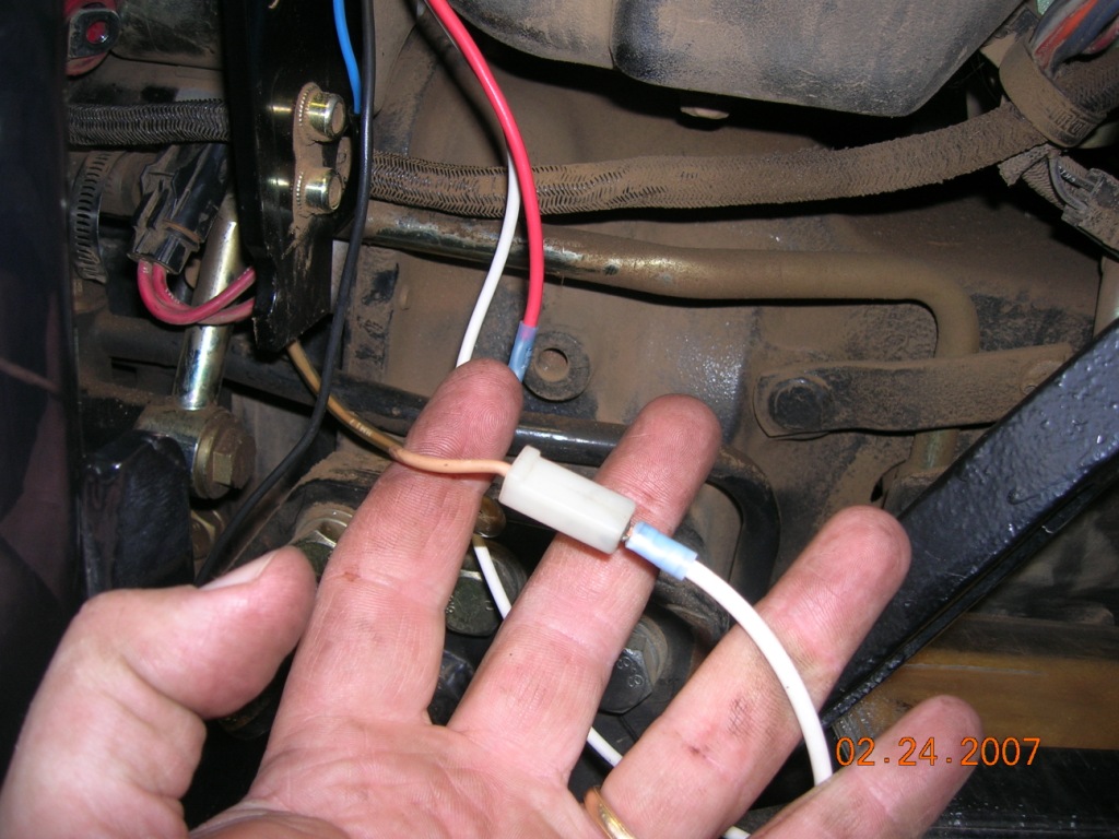

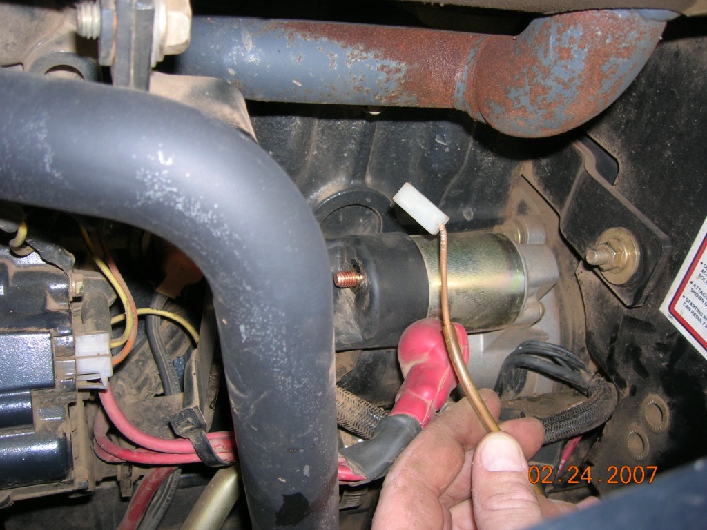

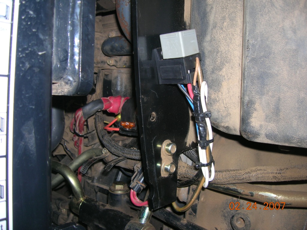

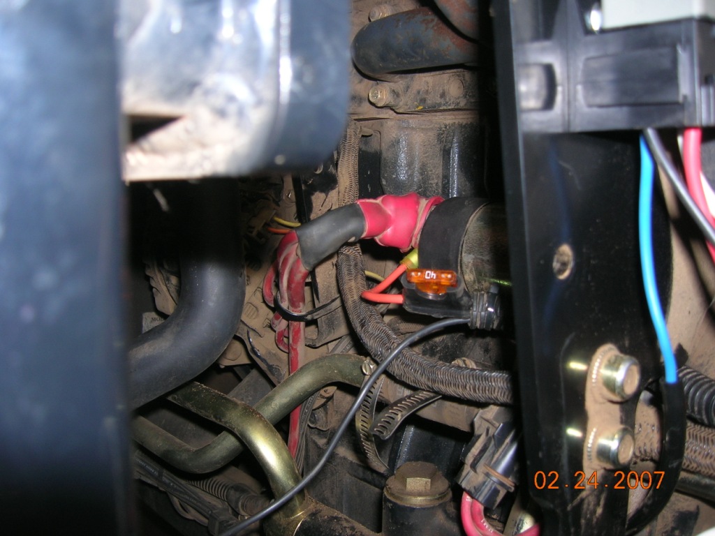

Here a a few better pictures;
1 - Instructions from the dealer.
2 - Instructions with relay pin numbers.
3 - Disconnect the battery and remove the cable from the stud on the starter.
4 - Take the 'purple' wire off the starter solenoid. It looks tan to me.
6 - I installed the relay base under the plastic on the left side.
7 - Connect the blue wire from the relay base to the starter solenoid.
8 - Connect the 'purple' wire from the starter solenoid to the white wire on the relay base.
9 - You need a large ring terminal on the fused (40 Amp!) red wire from the relay base.
10 - The red wire gets bolted onto the starter stud.
11 - Relay installed and wiring bundled.
12 - Connect the black wire to ground.
It would make a lot of sense to remove the loader before tackling this project. Others have reported problems with the key switch, but this has solved my starting problems.
