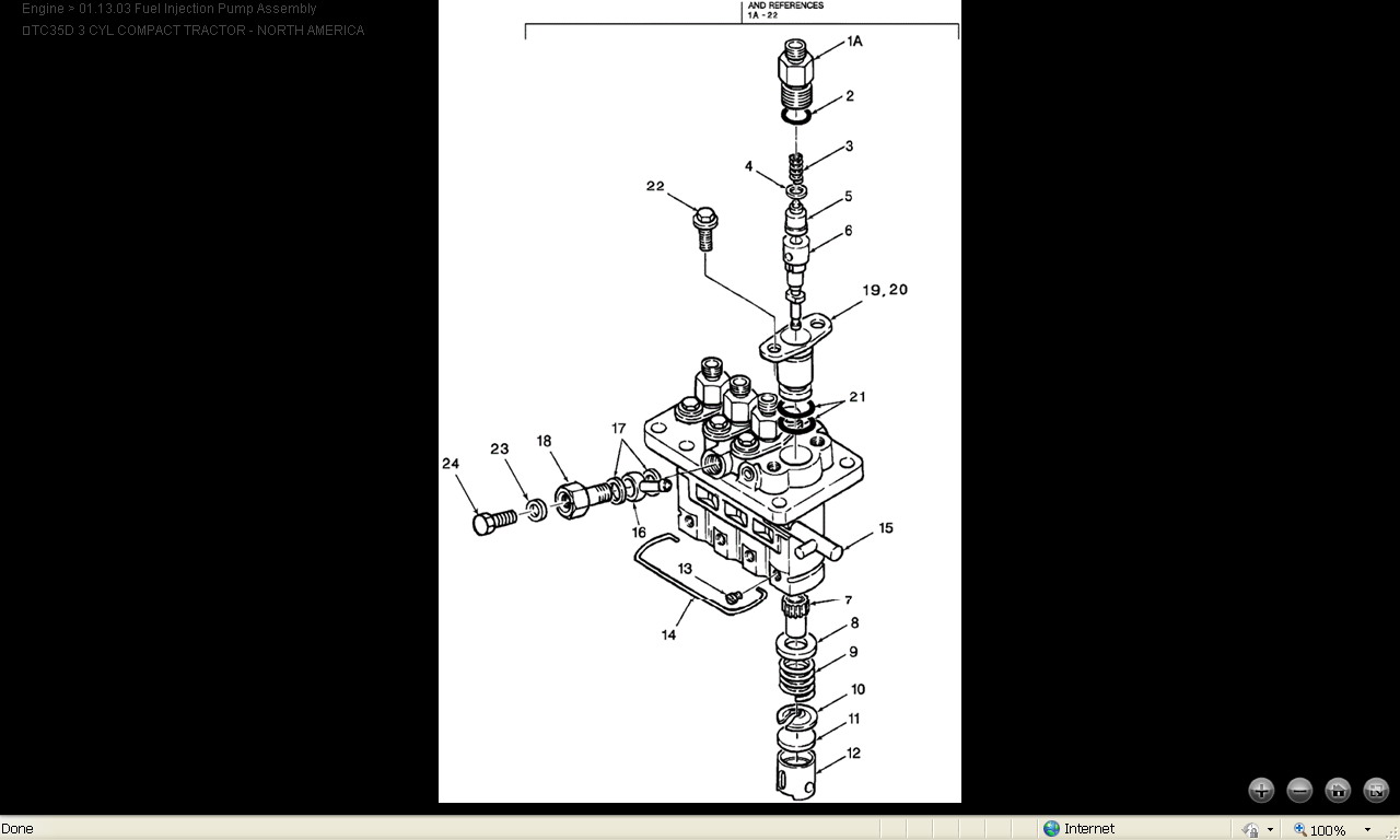

I developed a fuel leak at the pump on my job on Saturday. It looks to be coming from the hold-downs with pentagon-headed bolts. I have a tractor job on Monday, so I checked that everything is tight, and everything is. Couldn't really check the pentagon bolts since I didn't want to booger them up. I have a bunch of tools...but a pentagon shaped wrench???
Anyone run into this one before? Is there a gasket or o-ring under the hold-down?
/ TC35 Fuel Leak #2
There is an o-ring under the large hex nut fitting that holds the delivery valve in place and two o-rings on the bottom of the flange tube held in place by the 5-sided bolt heads. Obviously, they don't want you to take those out. Here is an illustration from Messicks.com. Items #2 and #21 are the seals.

Thanks Jim! Just what I needed.

Having the same fuel leak issue on my TC35D. After trying all kinds of wrenches I finally received a 10mm Penta Socket from Australia today. I tightened the bolts hoping the leak would at least be less with no luck (pretty darn tight to begin with) guess I need to order the gaskets / o rings. I'm no mechanic; do you think its safe to pursue on my own? As mentioned earlier in the thread at least $500 is the max... I don't want to create a $1000 problem.
/ TC35 Fuel Leak #14
It's probably not a good idea. The pump will have to be removed and the individual pump elements will have to be disassembled.
From the illustration sleeve(19) cannot be removed until retainer(10) is removed from plunger(6).
