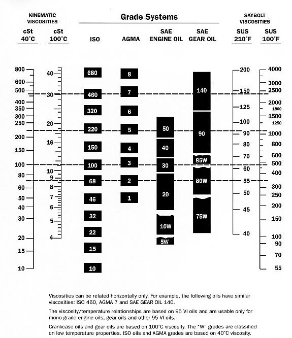

It's a common misconception that 80-90w is much heavier than hydraulic transmission oil.
It's really not.
Motor oil and hydraulic oil, are not measured on the same scale as gear oil.
The viscosity of different brands within a given weight, varies. Most hydraulic transmission oils are about the same viscosity as most 80-90w gear oils.
If you do side by side pour test, you can easily see it for yourself.
Both products are actually gear oil, that's why they are often interchangeable.
