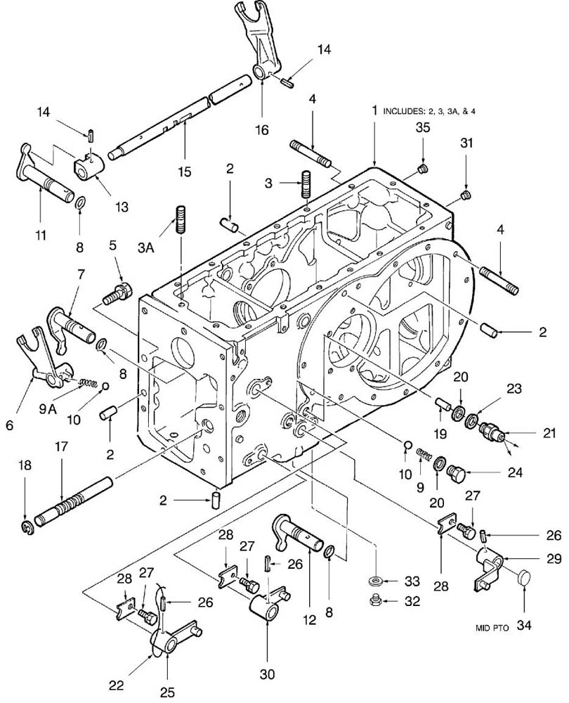

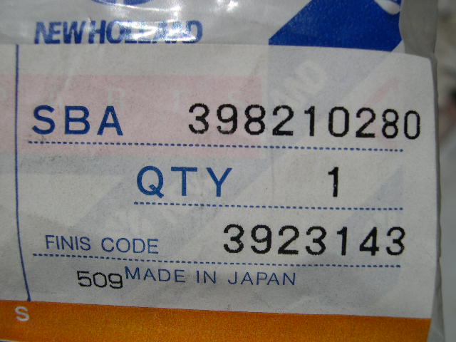

When I first bought my TC34DA in 2007, I think it was, I had a similar problem.
I say similar because I am not sure it is, was exactly the same. There is a spring that holds a detent ball in a groove in a shaft. Internal in the transmission. The spring was too stiff. IT is accessible behind a bolt screwed into the side of the transmission. There is a pn for the new spring, Changed the spring , fixed everything. Now I have to go find the info.
I cannot find the thread .
The spring is no 9 on the exploded view and the new spring .pn is in the other picture.
I cannot remember if this was the 4 wheel drive or the rear PTO and it is a different tractor of course. The dealer had no information on the problem but did have the new spring in stock.
Maybe something to look at
I just looked at the TC35 transmission. Did not see any detent springs in the transmission like on the TC34.
