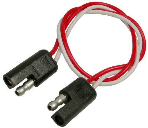

A block heater is probably around $30 from New Holland. Not terrible to install - just pop out the proper frost plug and install - just don't drill through the block! I've always thought the TC35 was kind of a sleeper. It is built on a large frame with larger tires and bigger wheels so it has more traction than say a TC33. Those are low enough hours and it looks like you still have more than a little life on the tires (the front tires usually wear out first). It is easy to install some LED lights on the ROPS, as there is a power plug under the seat. Have fun!

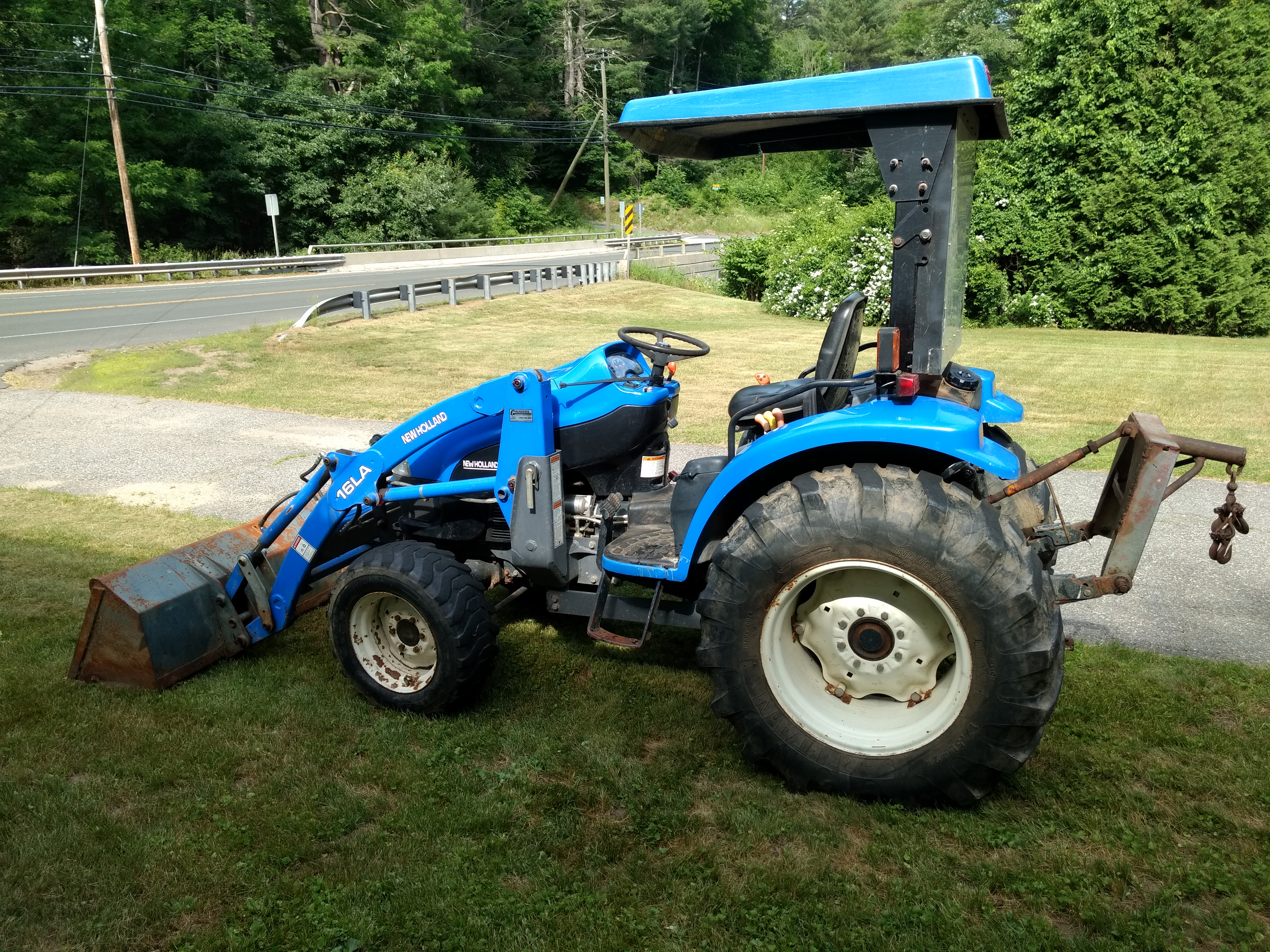

IMG_20180616_161833658.jpgI had looked at a TC33DA that had a lot less hours but they wanted $14000 for it and it was leaking fluid from the transmission and the front axel. the dealer ended up fixing the leaks but it was still too much money. the tires are worn but certainly not worn out. the fronts are worn more but they are also cheaper to replace. it's a little scary to start pulling out freeze plugs but I might try it. I think the block heater might be a good idea. I didn't see a power plug under the seat.. I'll have to look for it. Yesterday I went to put the range lever in gear and the part on the transmission broke off.. now I'm waiting for parts.

Here is a pic of what that work light plug under the seat should look like, only it will be black.

I wouldn't worry about tires just yet. Use it for a while and see how it goes. In a weird sort of way, sometimes the more worn tire has better traction than a newer one. If/when you do buy new front tires, get at least 6 ply and maybe 8 ply if possible. A full bucket of dirt makes em bulge.
