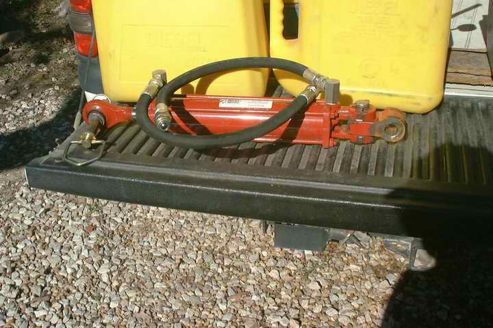

Kevin, you sent me an private message requesting photos of my toplink, but your info doesn't list your email, so I can't send the photos back to you. I'll post them here, and in the next two posts. See the attachments.
