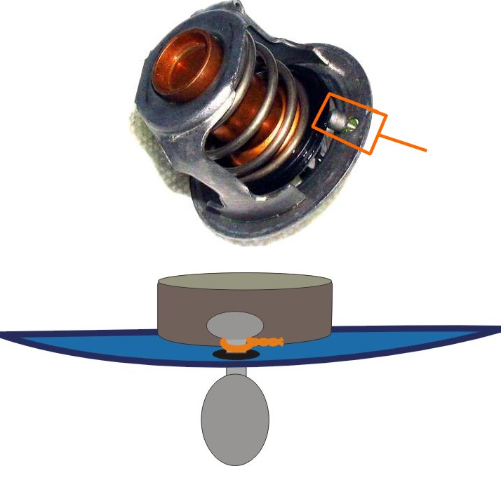

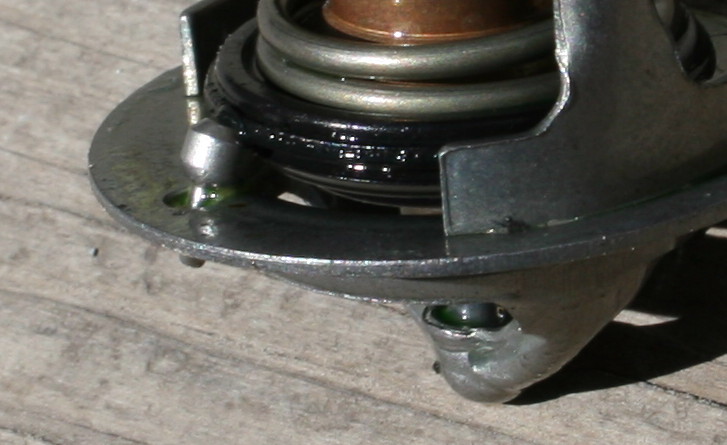

   / TC35D run problem #15
This forum is amazing, for it saves much mileage and frustration. I purchased a TC45D(one of the first ones made) last fall. I had read about the temperature control problems, and the fixes(never heating up). Last weekend, I put a valve in the drain line, which didn't help. I then took off the thermostat. Attached is a picture of what I found. There is another picture of that same part in the same position from 5 years ago in previous threads.
If I had to troubleshoot this from scratch, the tractor would still be running cold. The thing about this is that the tractor was well maintained, and the fix cost less than 10$ and 30 minutes. The reason it was still like that was the lack of dissemination of information. This is not just a NH problem.

   / TC35D run problem #16
Hmm...I think I know the other picture very well. It's from my tractor.:D
Isn't it amazing how such a little thing can cause such a big problem. I just wound safety wire around the top of that little checkvalve so it could not rock over so far. I've not had a problem since. (my fix attached)

I have had lots of trouble with my TC33D with the temp gauge, and while in the process of checking things, the dealer told me I might have that same problem. I really don't see why that jinmans fix will not work, or just snip it off and put a screw in it to close it off altogether. There are millions of thermostats without that pin.
   / TC35D run problem #18
I just snipped it off(the valve). It works as designed now. It just amazed me that the it was still a problem 7 years after it was built!
