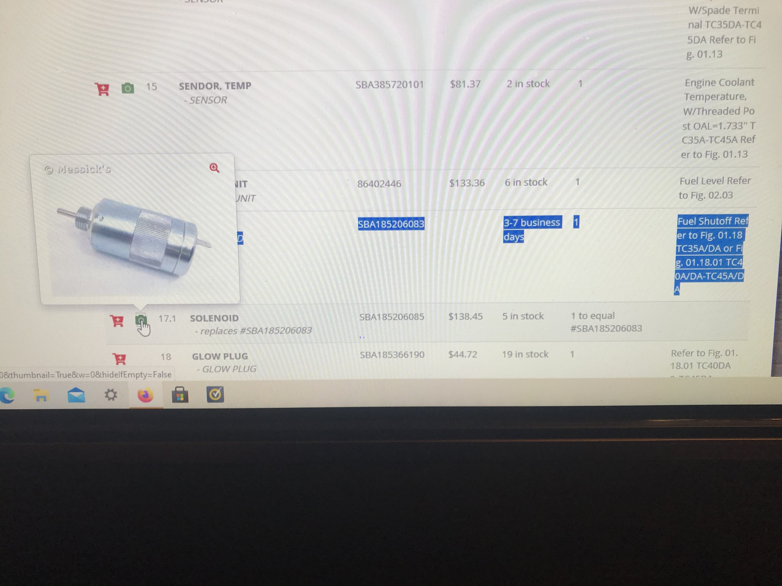

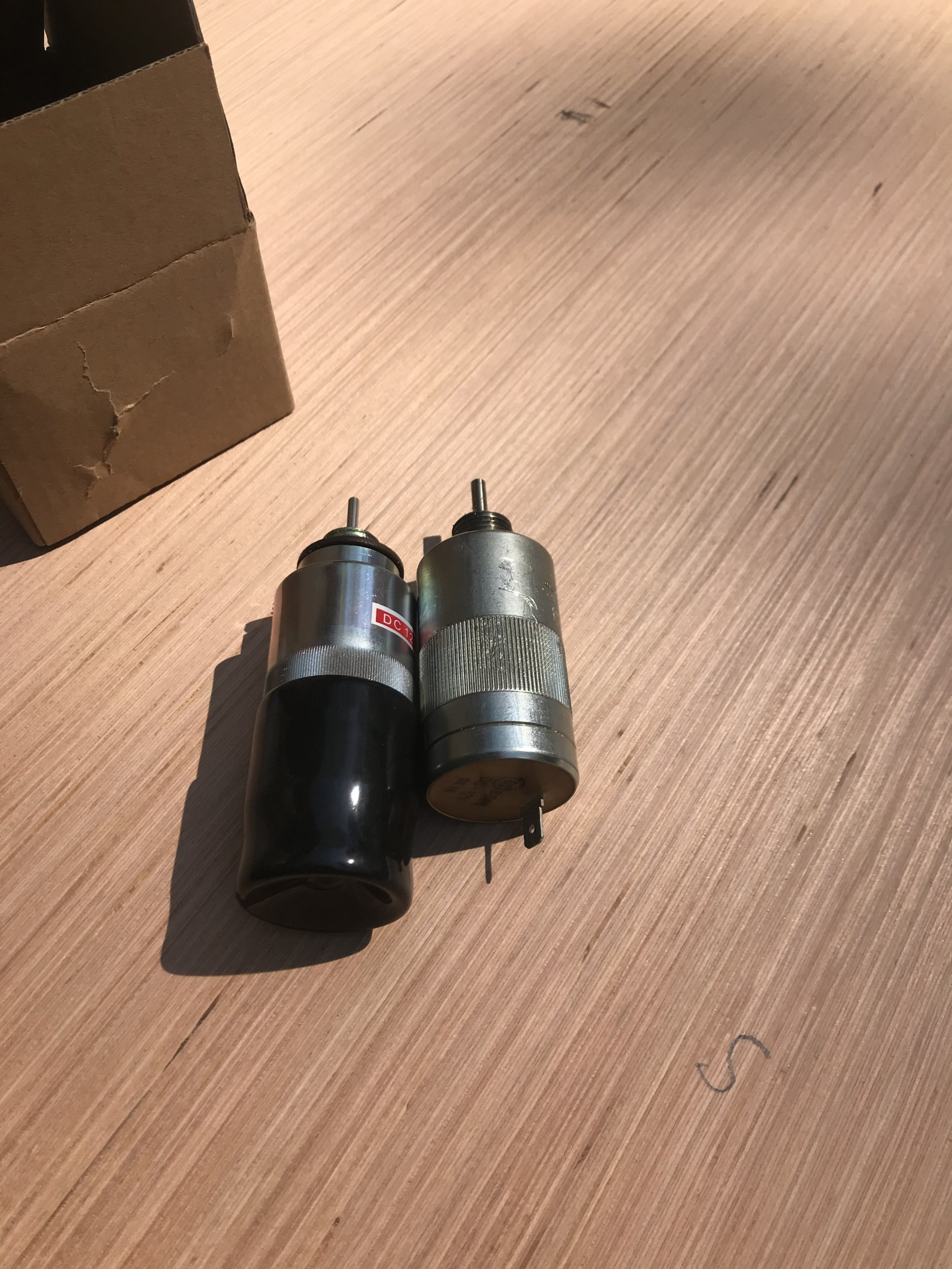

   / TC35D will turn-over but only starts occasionally.
On the block near where the fuel pump is a switch. I believe it’s called the furl cutoff switch. It has a plunger on one end and a wire connection on the other. So when ignition key is turn on, the plunger is supposed to be pulled in to allow fuel to flow to high pressure side to cylinders.
when fuel shut off switch is removed, tractor starts fine but have to insert plug in block to turn tractor off.
bought new shut off switch and tractor will spin, but gets no fuel to high side cylinders.
This is the switch fuel solenoid shutoff we replaced.

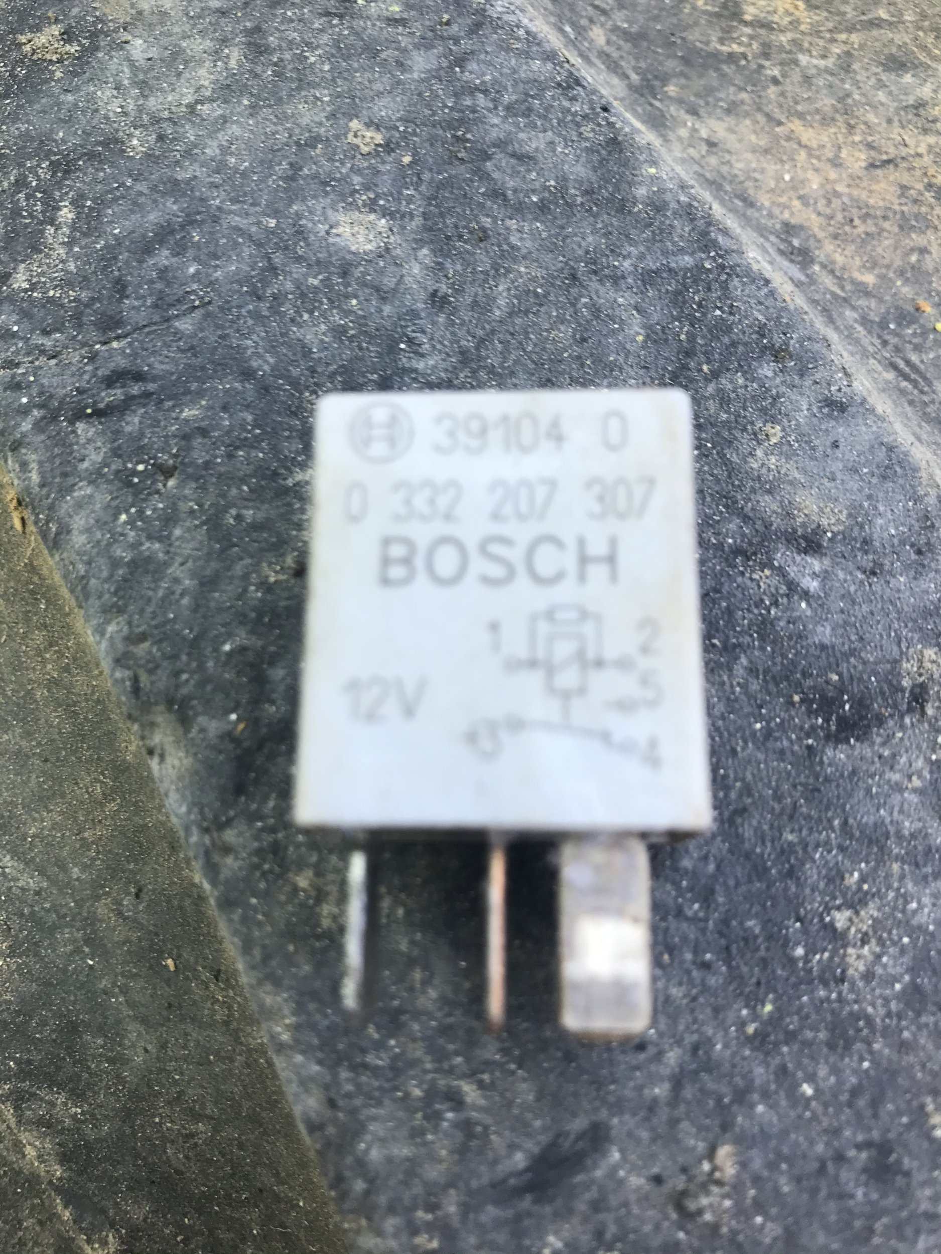

Could it be that this relay is bad?

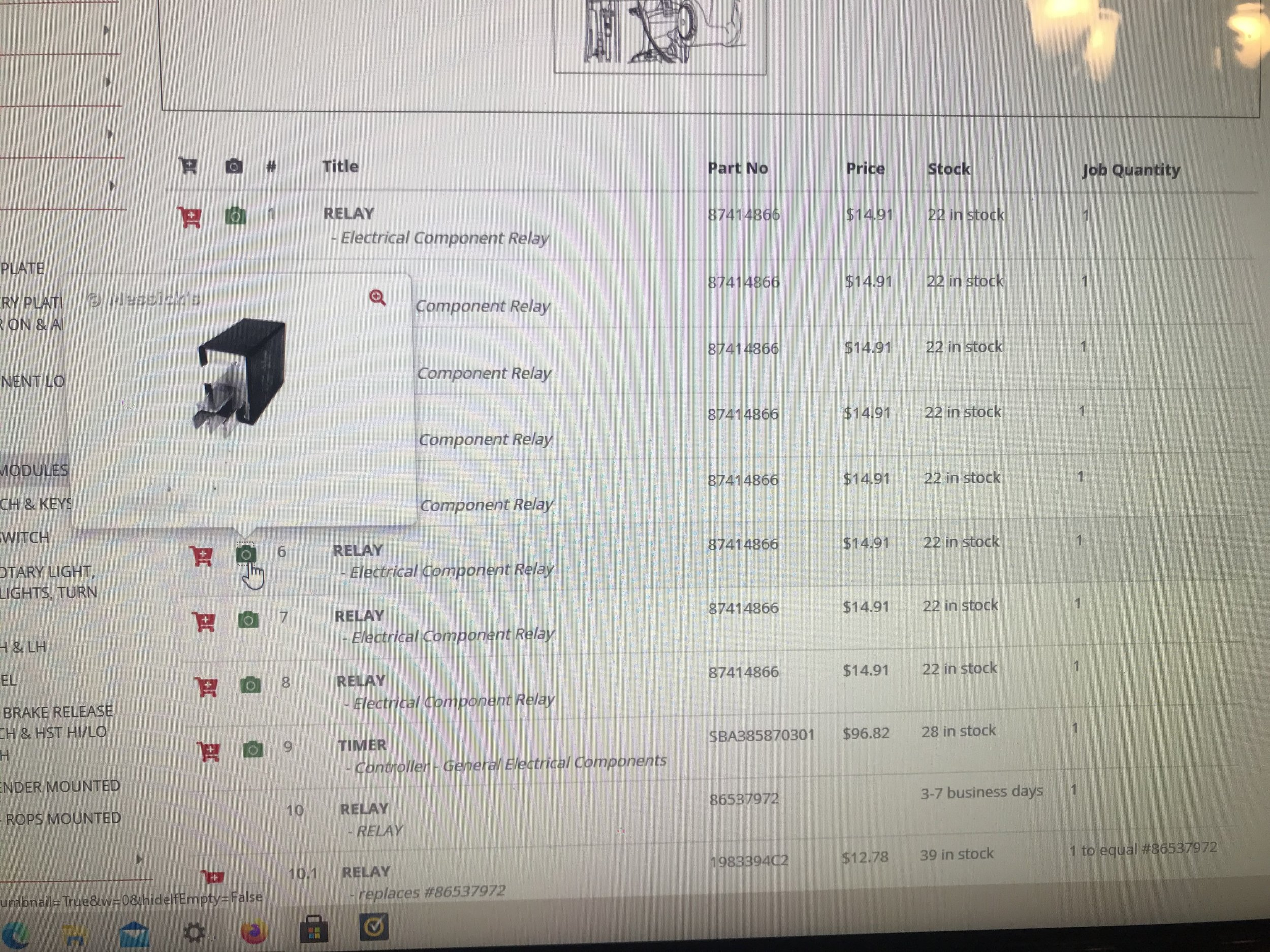

   / TC35D will turn-over but only starts occasionally. #8
A relay could also not be working. Some of the relays maybe the same on your tractor and you could possibly swap one that is not critical for starting to confirm. Also, these relays are fairly common and can be obtained at a local auto parts store such as NAPA for considerable less cost than a tractor dealer.

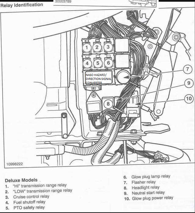

   / TC35D will turn-over but only starts occasionally. #9
If your Relay layout looks like this.... Check to see if Relay #4 is working.... You can swap it with a like relay to test.... Napa & alike can also cross reference...
It was the relay. We swapped one out and it started right up.I’ll go to parts store snd buy one. Thanks so much for everyone’s support.
