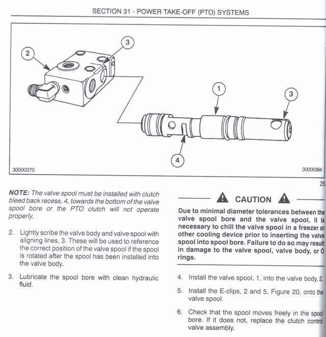

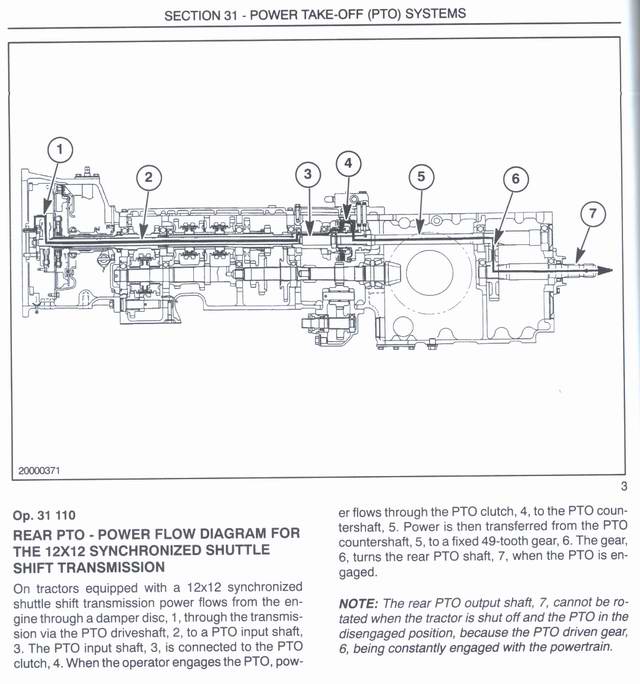

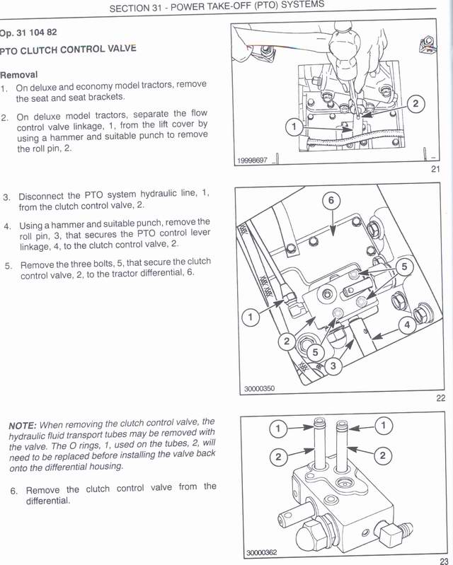

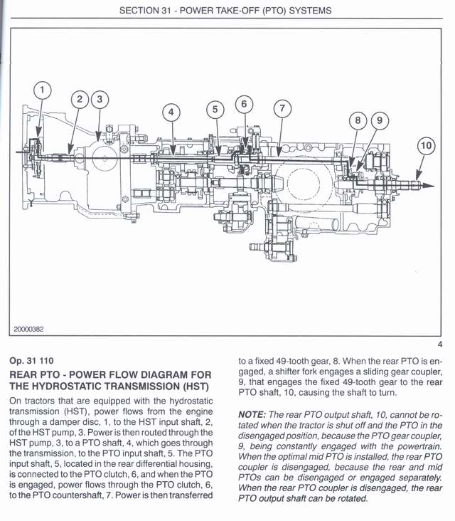

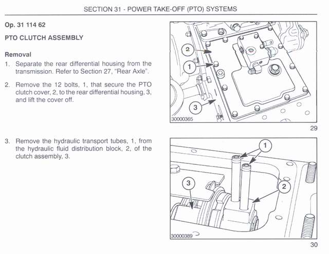

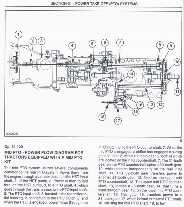

At this point, I think the best I can do for you is to just post the details of how the system works. Enjoy the "light" reading.;) You'll have to make the decision on whether you think the noise is too loud to ignore. It might go away after using the PTO for awhile. A similar thing happened to a forum member named Tractorganic. His noise disappeared and did not come back. Yours might do the same.
