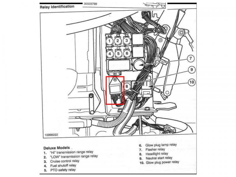

Mine Is under the panels on the left side of the tractor . Here is the picture I used to work on mine . My timer was missing replaced it and bought a relay and just replaced them . Think between the two I spent about 30 bucks . The one outlines in red is the timer IMG_7596.JPG

First thing, where did you find this sketch? Second, since the timer isn't even called out on the sketch, how do you find a part number?
Another member posted it a few years ago . I saved it . I just went to my dealer and bought the part . I think it was less then 20 bucks .

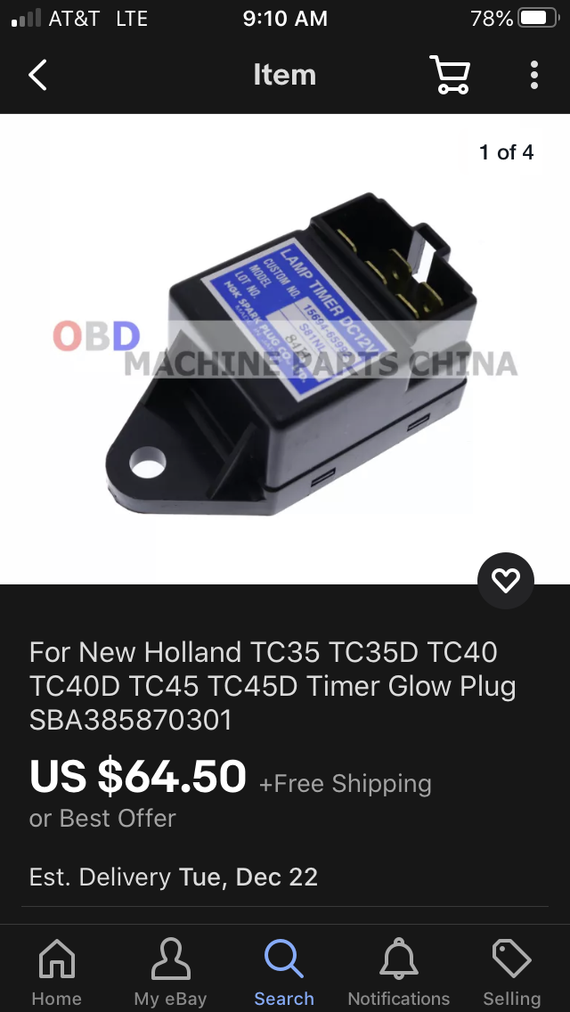

I’m wrong I got my timer on eBay and the relay from the dealer . Timer was about 65 bucks . I just did quick eBay search and found this one .IMG_7878.PNG

This same model number timer is currently available (4) on E-Bay for $19.99 plus $4.05 shipping.
E-Bay listing # 324342380849.
There were 5 listed, I just bought one.
