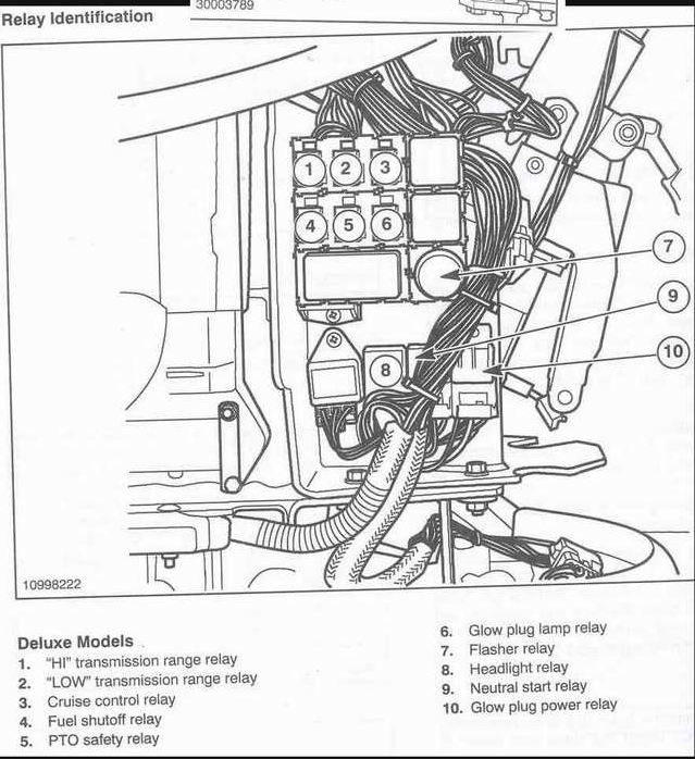

I have a tc40d with a 16la loader. The rabbit turtle switch quit working on the fender and joystick. The fender switch isn't lighting up in either position. If I move the switch on the fender or joystick you can hear the solenoids clicking but tractor remains in turtle speed. I know there is alot of info on this site about this topic but I couldn't find anything on this exact problem. Sorry if its on here and I missed it. Thanks in advance for the help.

Andrew, if the fender switch is not lighting in either position, I would check fuse #5. The clicking you hear may be internal to the switch. I suppose the "Hi-shift" relay could be loose in it's connection or it's contacts could be burned. That's the only thing that would keep either the rabbit or turtle light on the fender switch from working (unless the switch also has a problem). I would check fuse #5 first and then use the diagrams in the link to troubleshoot your system.
Link to Rabbit/Turtle simplified operational diagrams.
RDrancher: I'm a little slow this morning since my oldest grandson's wife just went into labor. I'm on pins and needles waiting for news of my first great-grandchild's birth.:D
EDIT: Added diagram of relay locations under left cowling (under steering wheel). You will have to remove the left cowling and then look at the two relays marked 1 & 2 in this diagram. Also, look under your left operator's platform (behind the step) and see if there is a wire loose going to the range shift solenoid.

WhoooHoooo!!! I'm back up and running! Thanks for the input. Jinman you were dead on with the #1 relay. It had a bit of corrosion, cleaned it up, put some dielectric grease on the terminals and away I went. Two winters ago I had to use this tractor to load salt trucks, I have had corrosion problems ever since. Thanks again for all the help. Jinman, enjoy your new grandchild!
Congratulations! Good troubleshooting.:thumbsup: I gave you the tools, but you did all the hard work. I'm glad you were able to get that cowling off without too much trouble.
