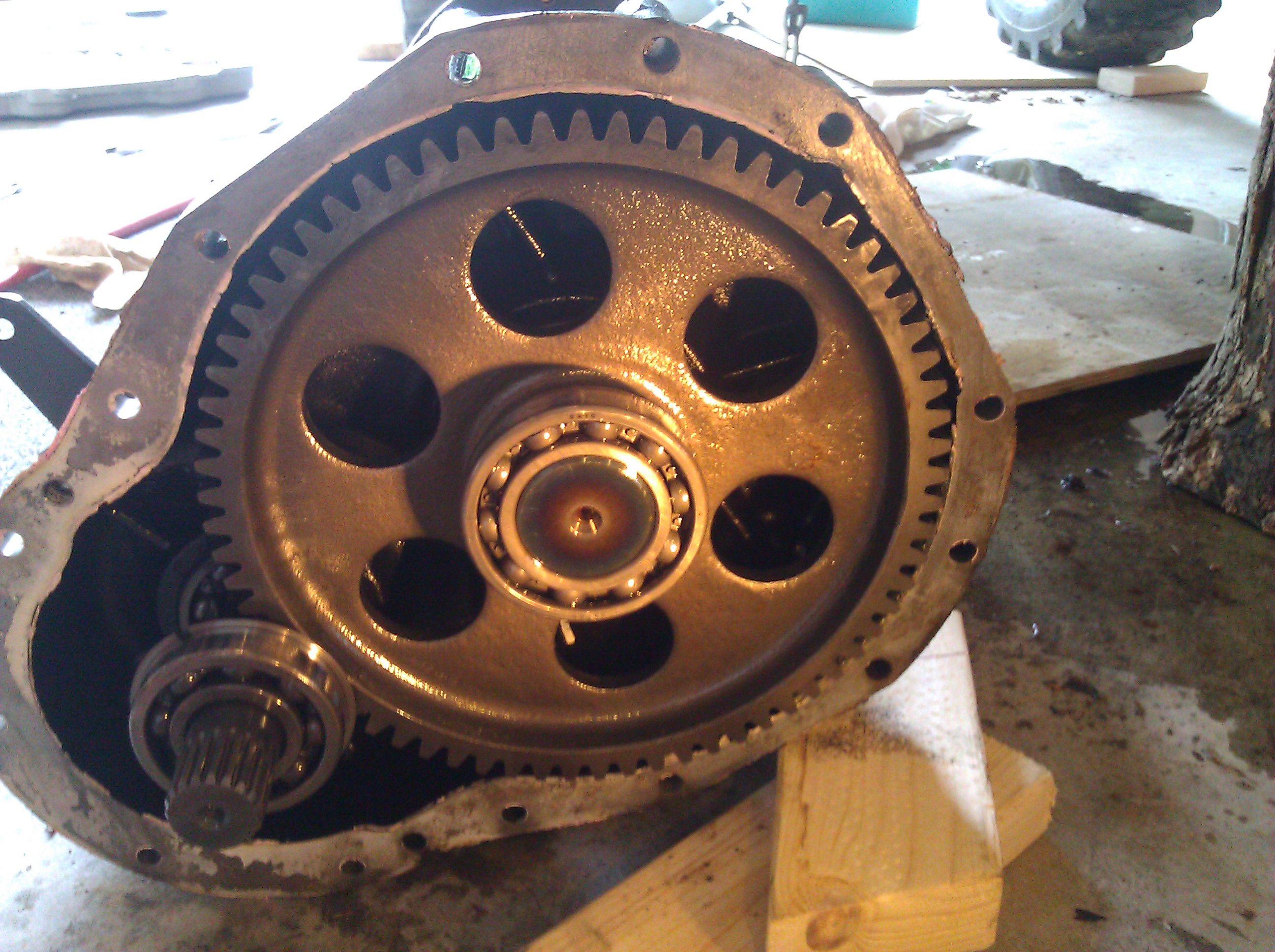

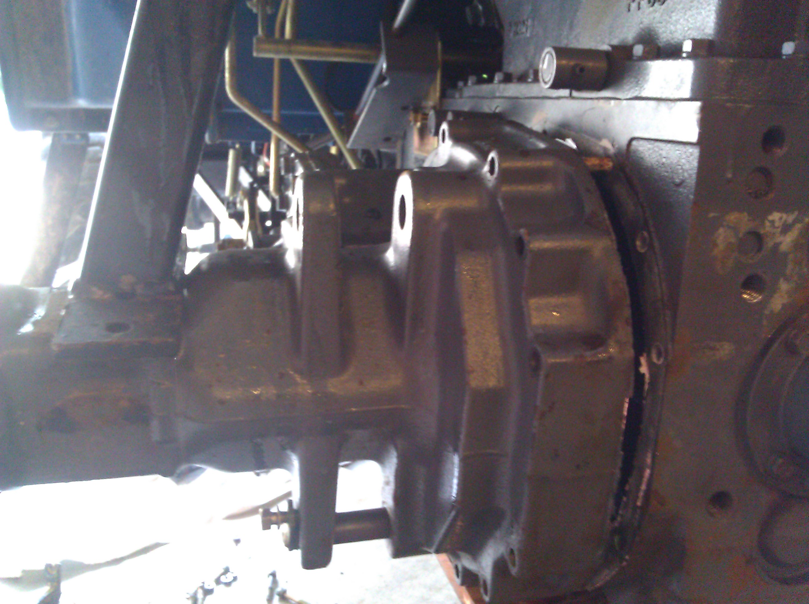

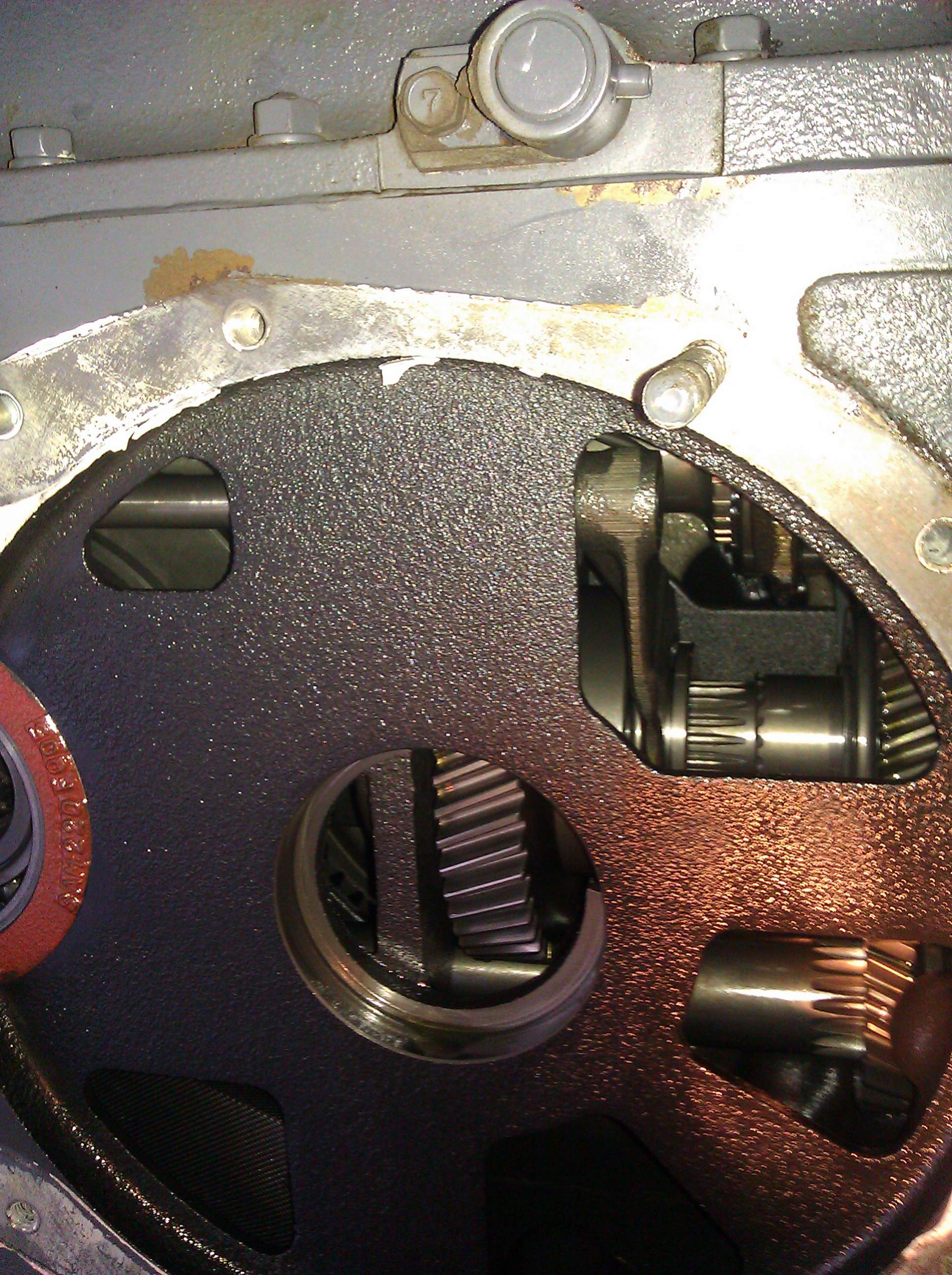

   / TC40D Rear End repair
Yep, it popped right off once I broke the gasket tight loose. The top 3" stud had to be backed out otherwise the ROPS was going to have to come off.
Good news everything looks fine...bad news I still don't know what is wrong.
I dropped the FWD transmission cover and no problems in there either.
Would anybody suggest I pull the other axle housing?
