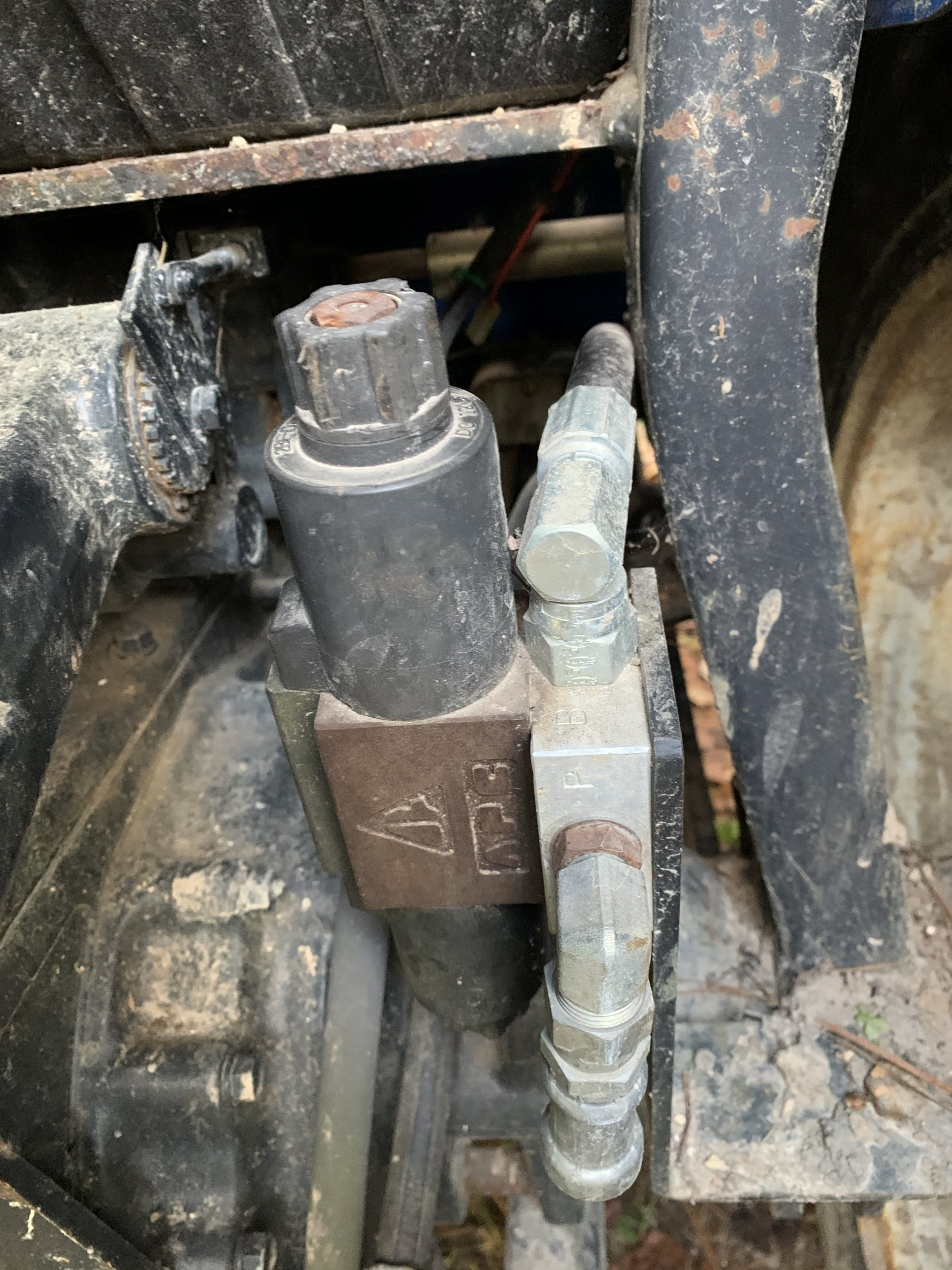

Dlctcg, thank you very much for your help and input. I’m tied up with several projects right now AND I’m in an area where there is little to no Internet / wi-fi signals, so it takes me a whole lot longer to get back to the Forum and reply. I totally understand about “long posts” as there is little other way to make clear information. I’m going to have to get back to you later with detailed answers to your (very good) questions and information; but I will try to answer some here quickly.
The lane shark’s control box is permanently mounted on the side of the plastic cover that surrounds the hydraulics for the joystick. It is manufactured by, and was installed by, the Lane Shark manufacturing people themselves. However, when I first got the LS I attempted to have a hydraulic shop install a control switch for it. It’s a long, tragic and involved story, but short version is that the shop owner died when he had just begun working on my tractor. His son attempted to finish the work, but that turned into, “I’m going to try to get it to where you can come get it.” That’s when the Lane Shark company “volunteered” to put their control unit on it — for several hundred dollars, mind you.
As to the third function valve, I am under the impression that it is an actual third function valve and not simply a diverter valve. I’ve no idea what “type”, etc., it is. I will attempt to put images with this post to help with identification.
I don’t have an operator’s manual, but concur with your description of the battery light functions. It did operate as you stated right up until this current issue came about. it now lights up ONLY when the engine is running and brightens (a lot) when any control — switch or button — is pressed.
The first thing I suspected was that a joystick rocker switch had gone bad, causing a short to ground. After replacing the switch ($22 from New Holland!) and the Hi-Lo rocker switch on the fender unit ($37 from NH dealer). I then double-checked the battery terminals, posts, and cable ends and connections (especially the ground cable to frame), I started looking “deeper” into wiring. I found that RATS had chewed several wires inside the cowling. Does anyone know why rats prefer orange wires over other colors? I am now hoping that once I get all the wires separated again that it will either solve or make the issue easier to trouble shoot. I have run into another problem though. It seems that who ever put the cowling pieces together and mounted them on the tractor cross threaded four of eight bolts in the plastic housed mounti nuts; basically rendering access to the wiring impossible since all four remaining bolts simply turn without loosening. Would you, or anyone else, have any “trick” ways of getting these pieces apart/off when their nut mounts are stripped? There is no way to get to the back side of these bolts and hold the fasteners/“nuts” from turning. It looks like I will have to cut some ugly holes into the plastic cowling to attempt to get them off.

Regarding the LS....is there a cross-port relief on the motor that drives it? Because a valve for controlling motors typically has whats called a motor spool that is a true open center valve. A valve for controlling cylinders is a tandem center valve. That will cause issues without a cross port relief when spooling down a motor, Maybe you blew something in the ls motor?

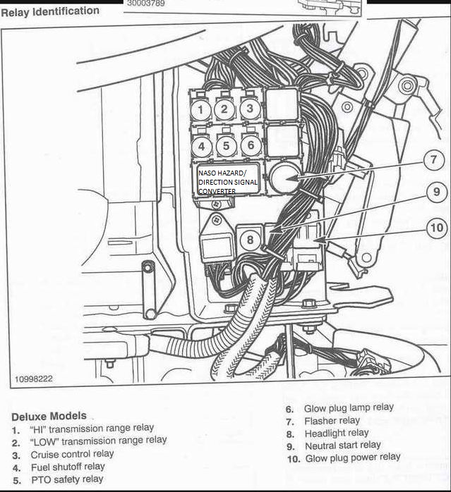

@tc40da-rg - As LD1 said you really need a multi-meter to test & trace things out...
Is your battery light still staying illuminated with the engine running? You need to get the charging circuit working as it will cause all sorts of other issues.
Again I'm not sure your tractor has the same fuse / relay layout as ours but here is some info...
If your panel looks like the image I attached you can swap the cruise control micro-relay with your Hi-trans range relay to see if the relay is the issue.... If you get a meter you can just use the relay testing PDF I attached.
But the charging circuit would be my 1st concern.
  • Relay Testing.pdf
