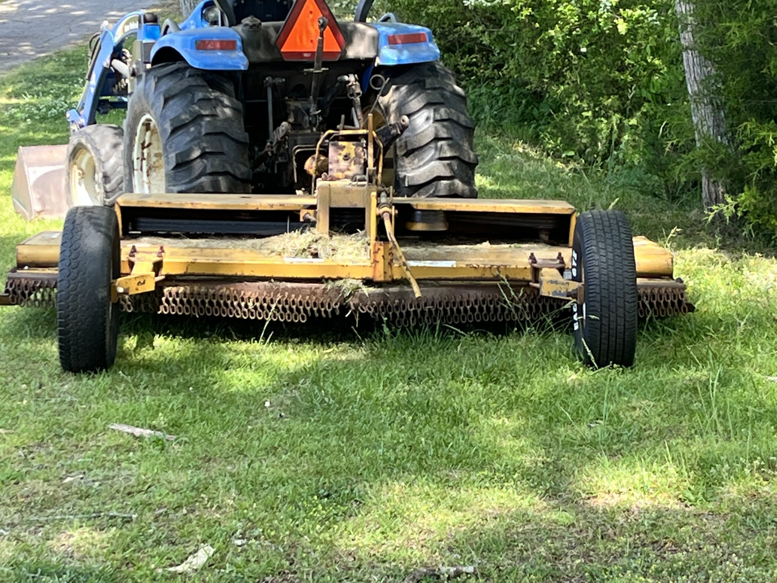

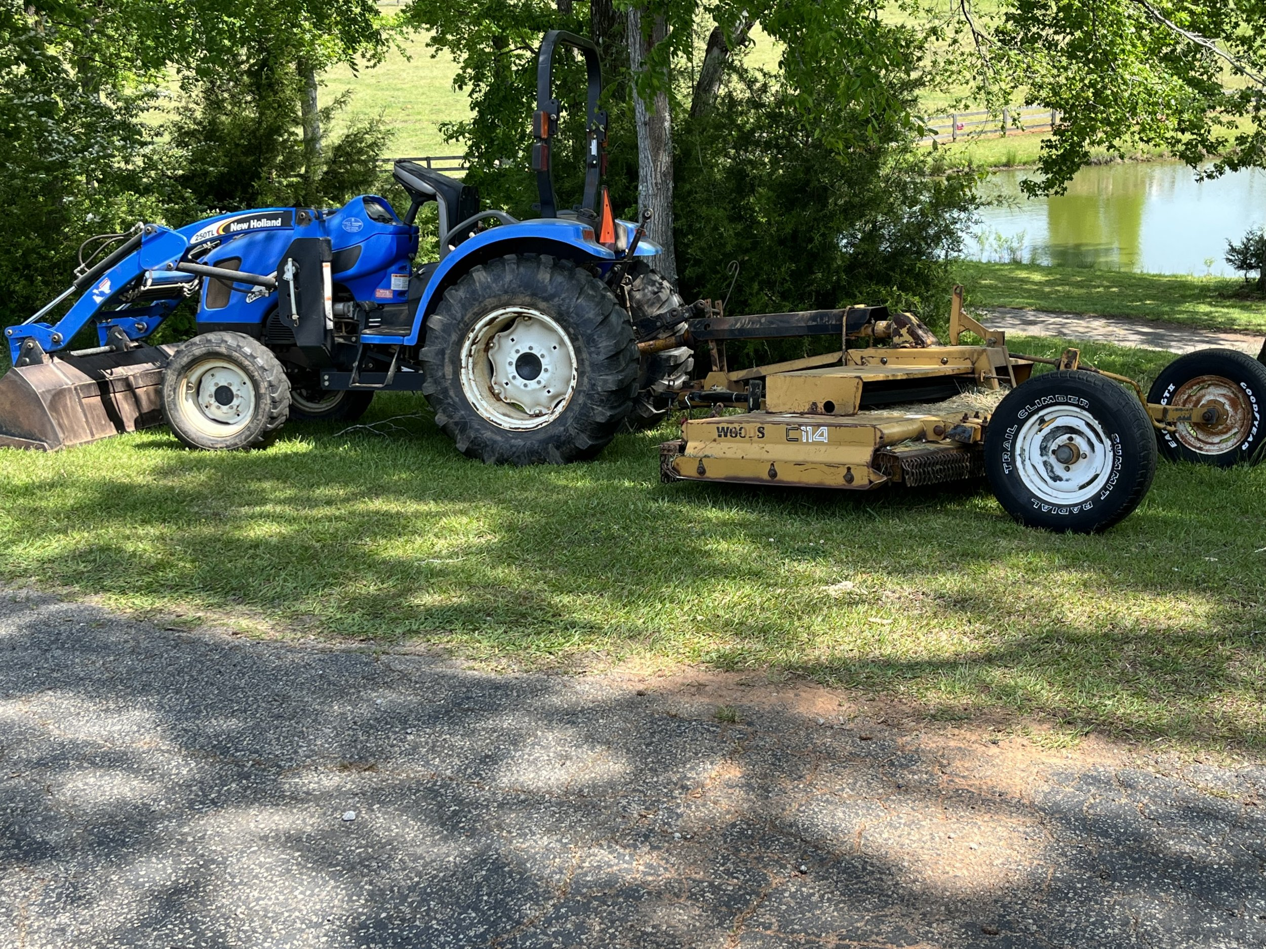

A little late to post in this thread, but I just purchased a Woods C-114 mower the cutting width is 9'6" and my TC45DA runs it great.

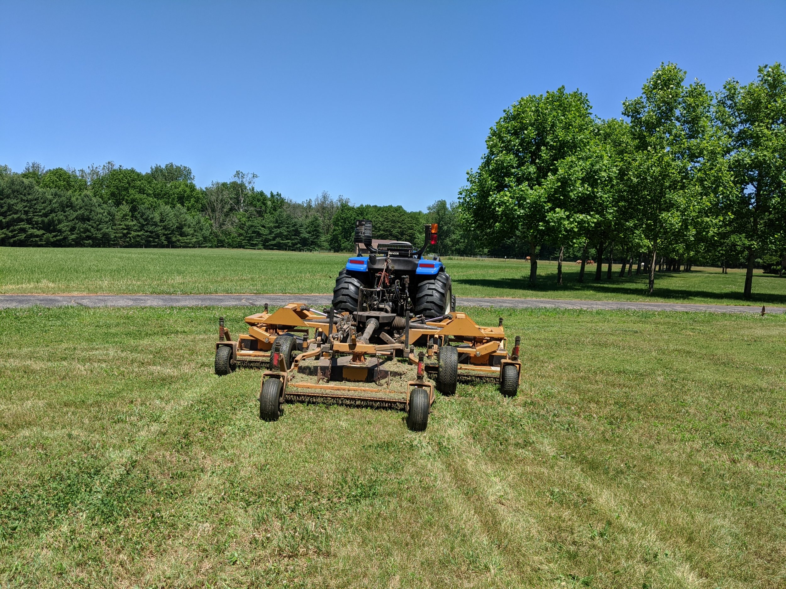

I've got a 3040, a newer version of the TC40. The neighbor had a 12 ft. batwing finishing mower that he was selling since he was selling his place. I intended to fix it up and sell it since he stored it outside and it had rusted up some. I bought and got it working fine. I have been using it for about 10 years with no problem. I try not to mow anything higher than 6". I do mow my horse pastures about once a year at it's highest setting, about 6".
