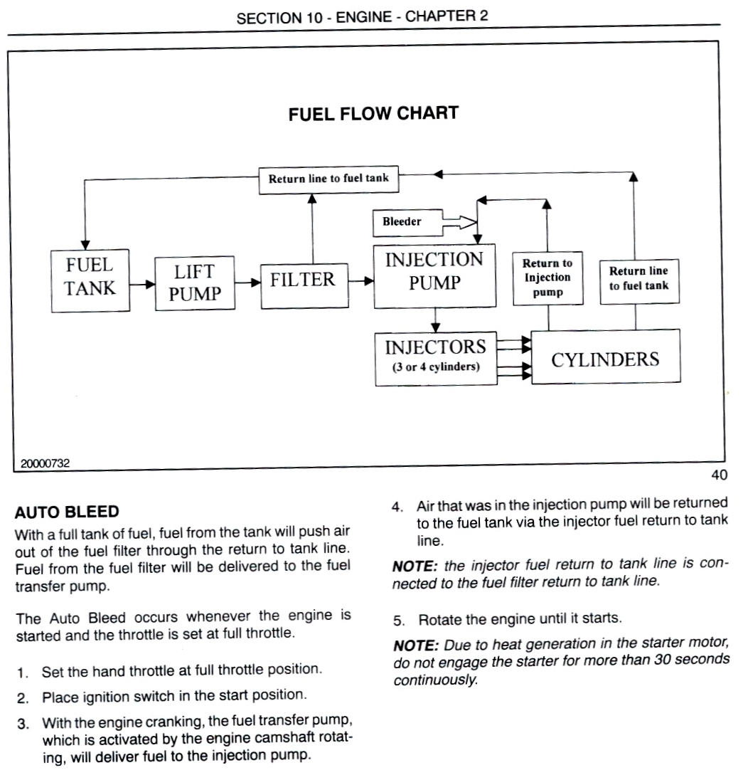

Since we are waiting on Burtrl to get his gasket, I'm posting a block diagram of the fuel system and a description of Auto Bleed. There are several issues that may have a bearing on where the filter could be getting air, but not from lift pump suction. The lift pump in the diagram below is before the filter, so the filter would never see suction, only pressure will be applied from the lift pump. Of course, if the lift pump is drawing air from a leaky connection in the feed line, then that will go through the pump and into the filter.
Also, consider the following. If you read items 3 and 4 in the description of auto bleed, you see that the injection pump sends air in the lines to the injectors where it is directed back to the return to tank line and T'd into the bleed line coming from the fuel filter. Since there is no checkvalve in the outlet at the top of the fuel filter, any clogging or restriction of the fuel return line will cause air to flow backwards into the top of the fuel filter and collect there. It seems that NH put a checkvalve in the fuel tank, but did not put one between the fuel filter and the return line T. This means that if the fuel tank cap becomes clogged so that positive pressure is in the tank, it cuts off the checkvalve at the return inlet and air cannot return to the tank, but rather build up in the top of the filter. That's why I think Burtrl's tank either has a clogged outlet that won't allow fuel to flow out of the tank or a clogged fuel cap that is holding the checkvalve closed due to internal tank pressure.
See? Isn't this fun creating imaginary problems and coming up with imaginary fixes?:laughing: I apologize for adding more minutia to the mix.:ashamed:

I my tractor the lift pump is after the fuel filter. I would think that yours is also. Check it out!
I believe whaat is happening is that my tank or fuel line is restricted, and the pump is causing a slight vacuum in the fuel filter. If the o-ring is not sealing 100% this could explain how the air gets into the sediment bowl. I am hoping to check out the supply lines this weekend. Hopefully I will have some answers to report back.
   / TC45D Fuel Vent Problem #24
You know, you could be correct in that. The diagram could easily be wrong. The lift pump in the diagram I posted could be drawn in the wrong place. It's not the first time New Holland has published an incorrect illustration. If the lift pump (transfer pump) is between the filter and the injector pump as it appears to be, that COULD cause suction on the filter and draw in air. I trusted NH's diagram without looking at the actual parts on my tractor and tracing the hoses. I just looked at a photo I have and it looks like the line leaves the filter and heads for the lift pump. The hose going into the top of the injector pump comes from the lift pump, so this is starting to make sense. When I change fuel filters and drain out fuel with the ring loose at the top, I'm always relying on gravity. I never do that with the engine running. As soon as the engine starts, the lift pump would draw in air if the ring or seal is loose.:thumbsup:
