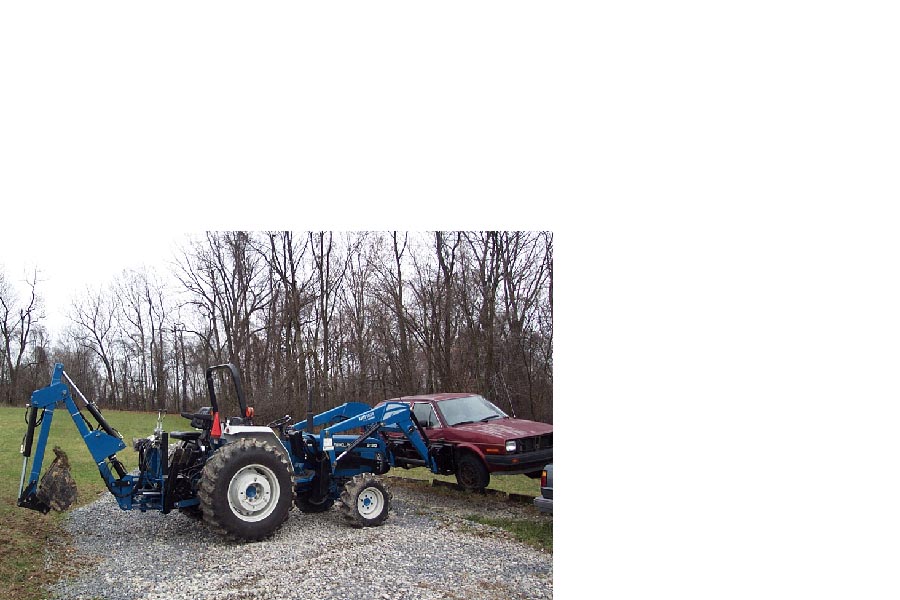

I think you will be happy with the 2120 for years to come. They have been around a long time with minimal problems. Good luck.
