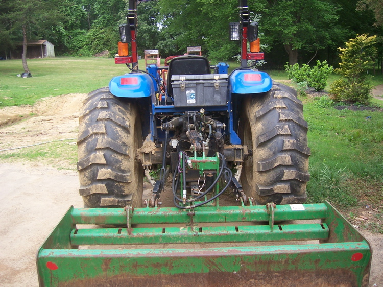

Very Nice. I have a little different setting. My tires are approximately 80" outside to outside. The tractor used to be setup as your last photo, (tires reversed with no hub change), but the tractor wouldn't fit on a trailer unless it was deck over. So now at 80" it will fit on my equipment trailer with 2" to spare on each side.
Please excuse the mess, this tractor and I worked from sun up till sun down yesterday and we havent had the chance to clean up today.
Also, yes, a Backhoe is very nice for changing tires around. I couldn't imagine trying to do it any other way.
