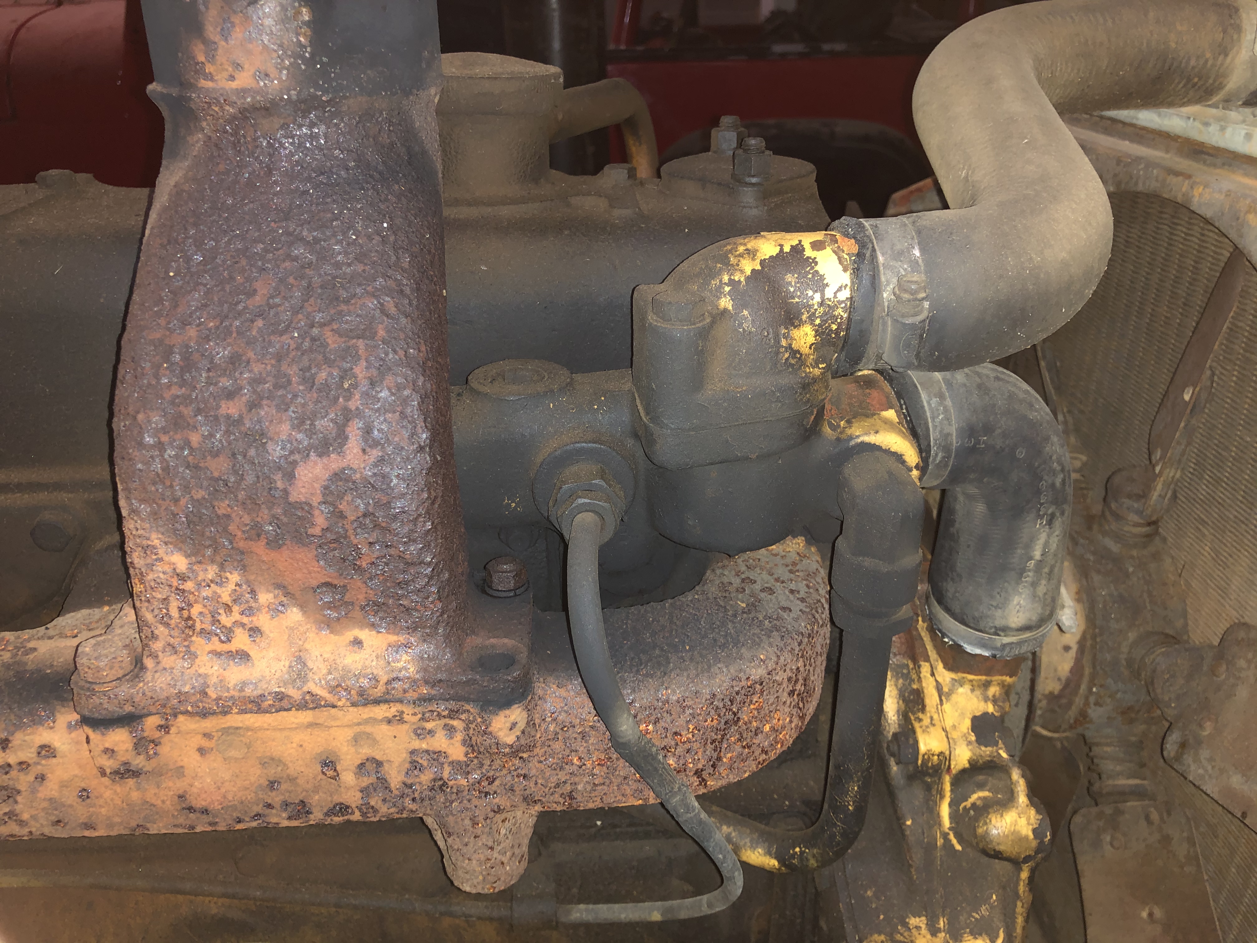

Hey guys, I am relatively new to this forum and this is my first new thread so I hope that I do it correctly.

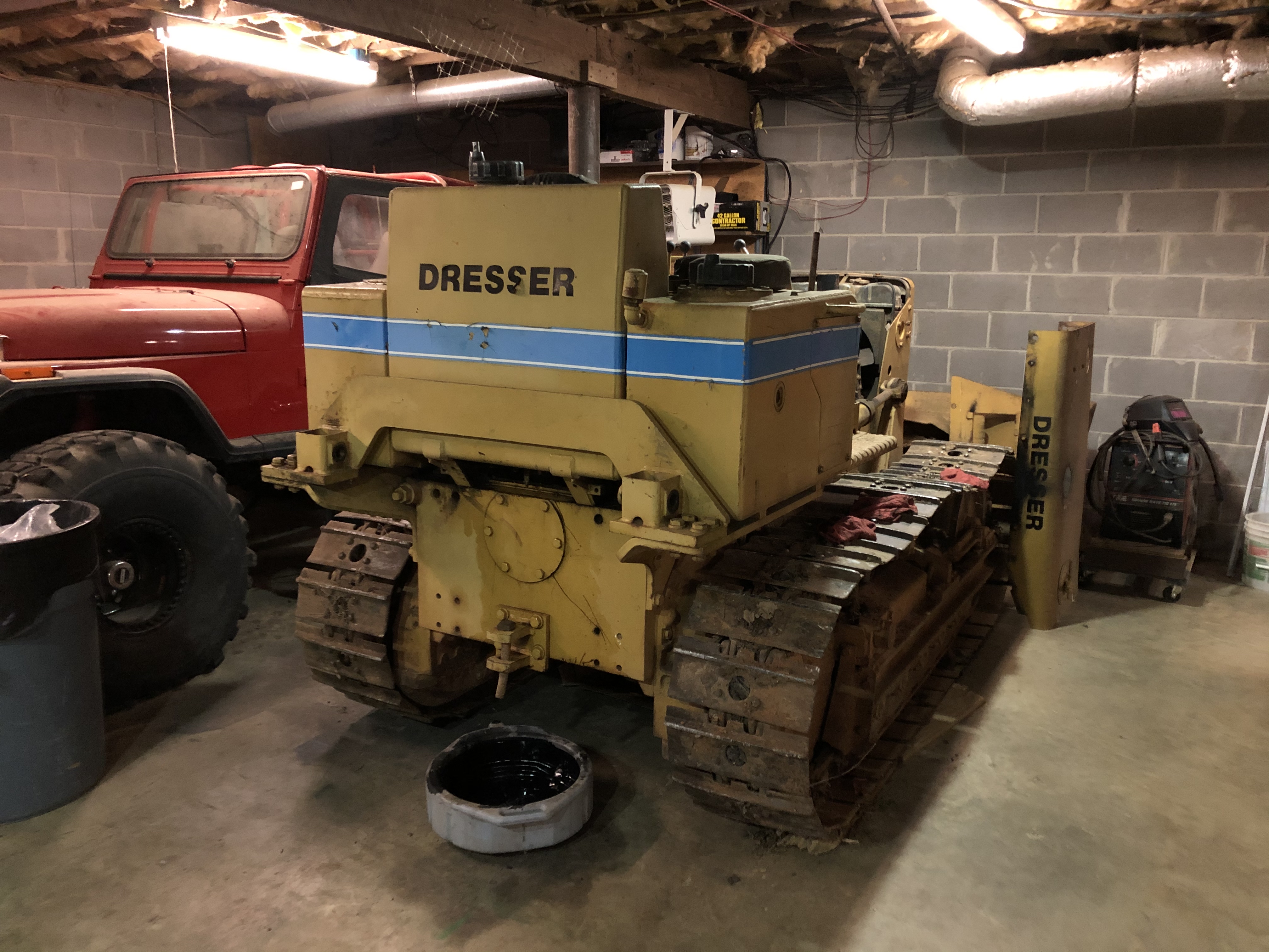

I have taken on a project to rebuild a 1982 (I think) TD7E Crawler, it has lost most of its power and will really only move in 1st gear (forward or reverse), it uses about 1 gallon of motor oil per 5-6hrs of run time. The battery doesn't charge so it has to be on a charger before use, and it wont start without using significant amounts of starting fluid. (This is just a start to the list of problems it has) I know that it is old, parts are hard to find, and that it is probably not worth the money that I am planning to put into it but this dozer has some sentimental value to me. My grandfather bought it and let me drive it while doing some projects around his farm when I was about 10 years old. I felt like superman on that dozer back then and it was some of the best memories of my childhood hanging out with my grandfather. One year at Christmas, not long before he passed away, he gave the dozer to me because he was getting too old to use it and he knew that it meant alot to me.

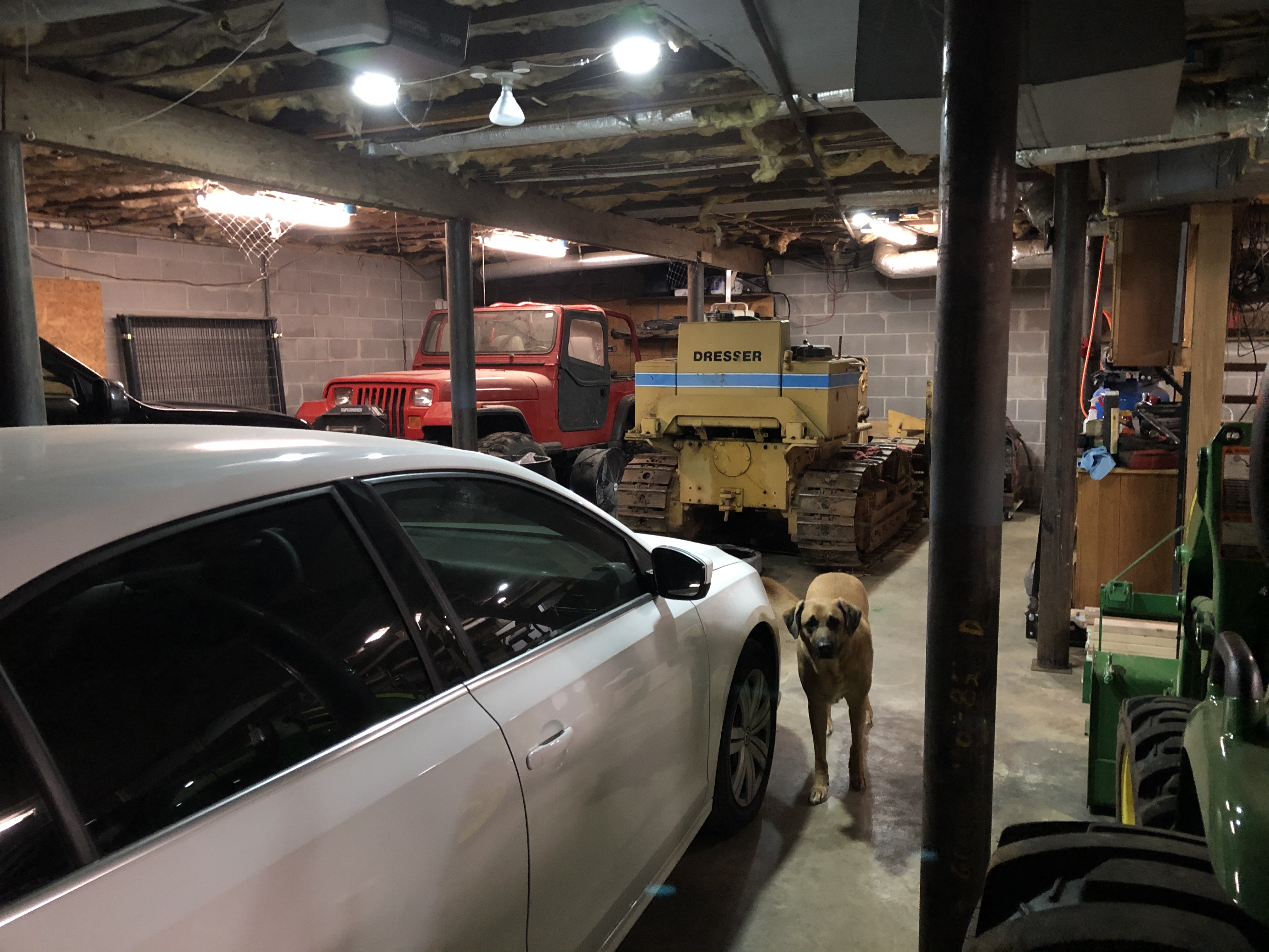

Now, I live in a neighborhood and I have only about 1 acre so I haven't really done much with it up to this point, it was sitting for a long time under a shed on the farm. I decided that I did not want to let it rust away so I am going to rebuild it little by little over time until I have a semi-restored piece of equipment. Over the weekend, I brought the dozer to my house and walked it up my driveway on boards, took the cage off, and then put it in my garage. (My wife was very excited about this :laughing:)

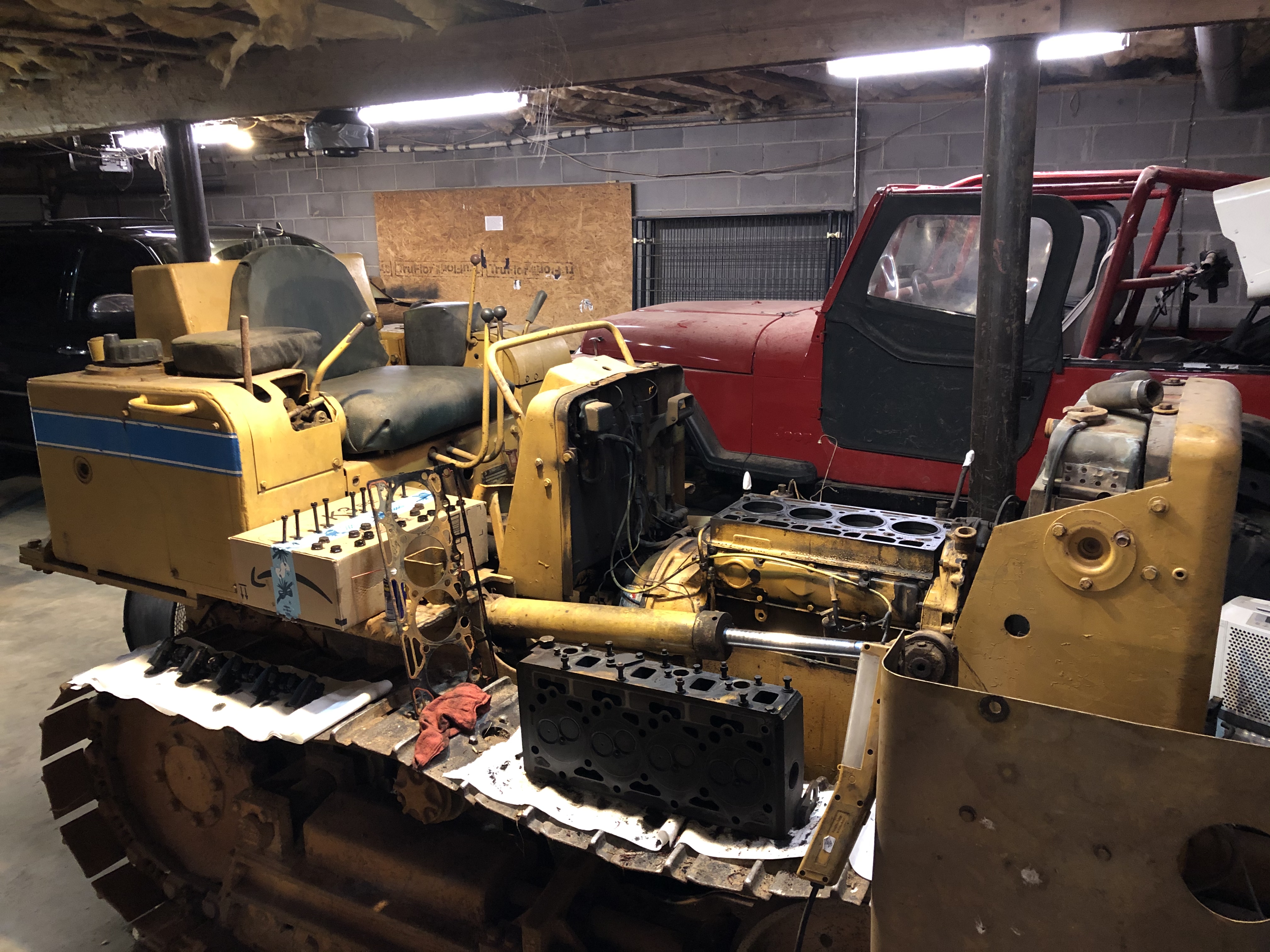

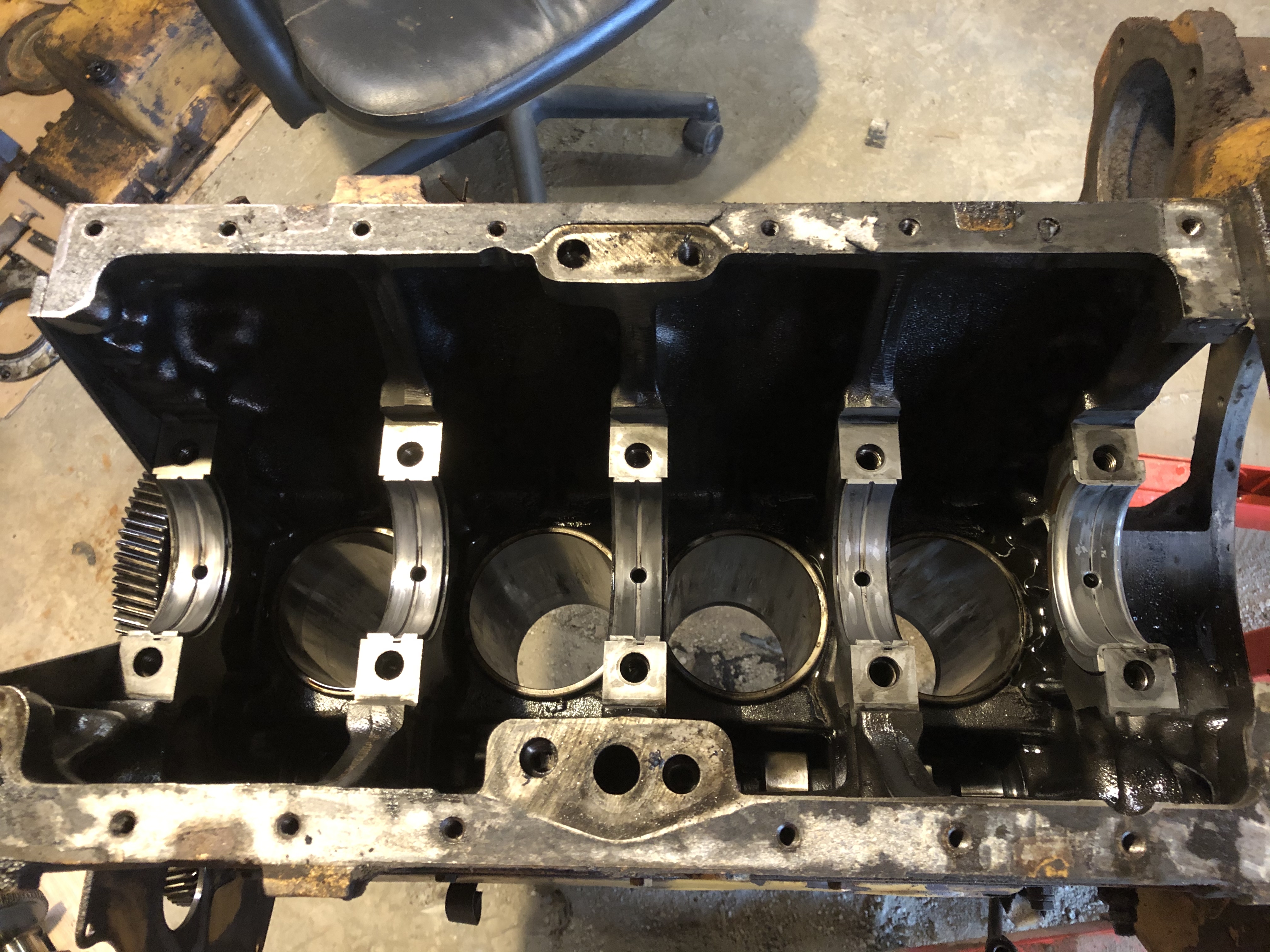

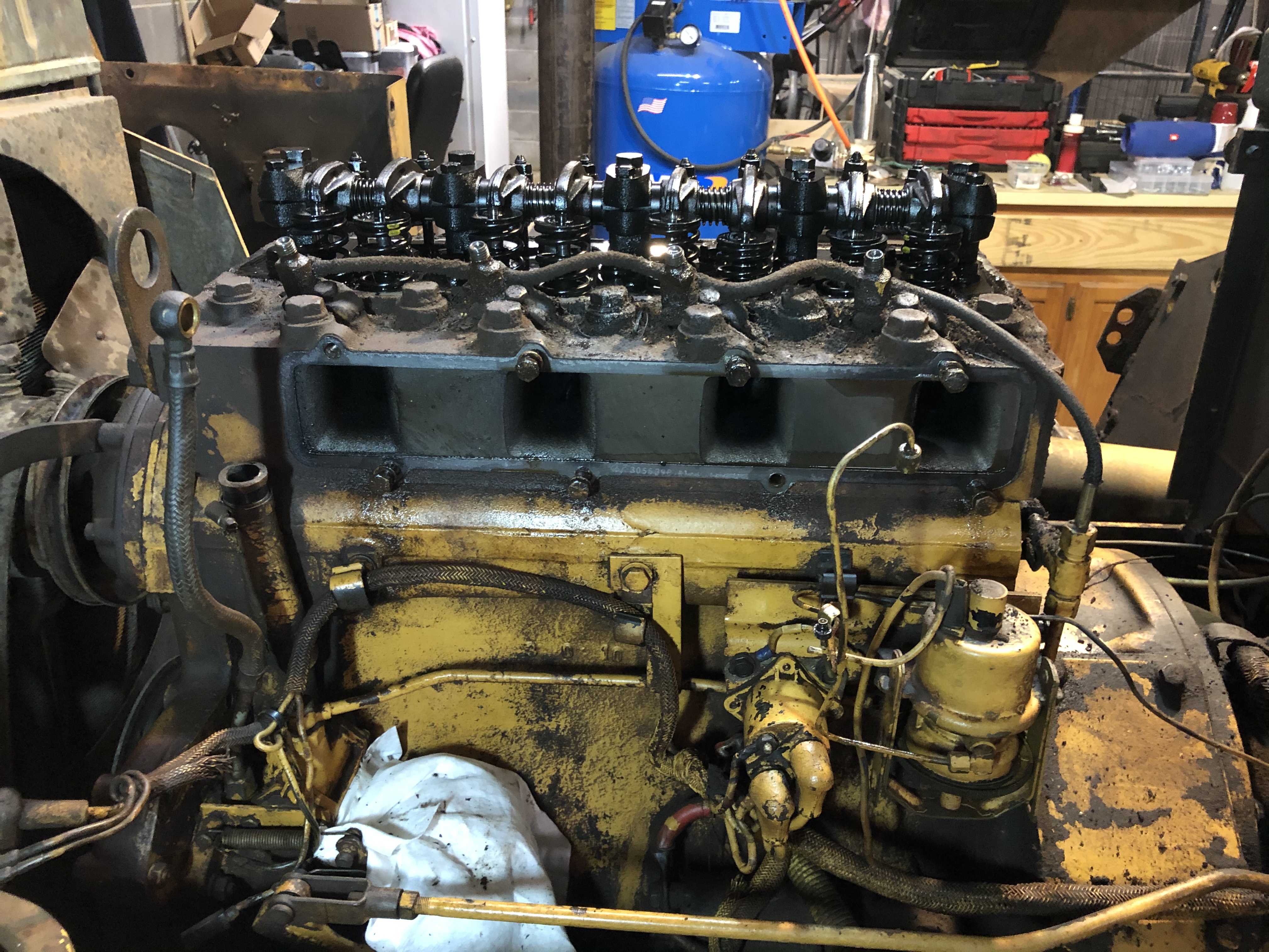

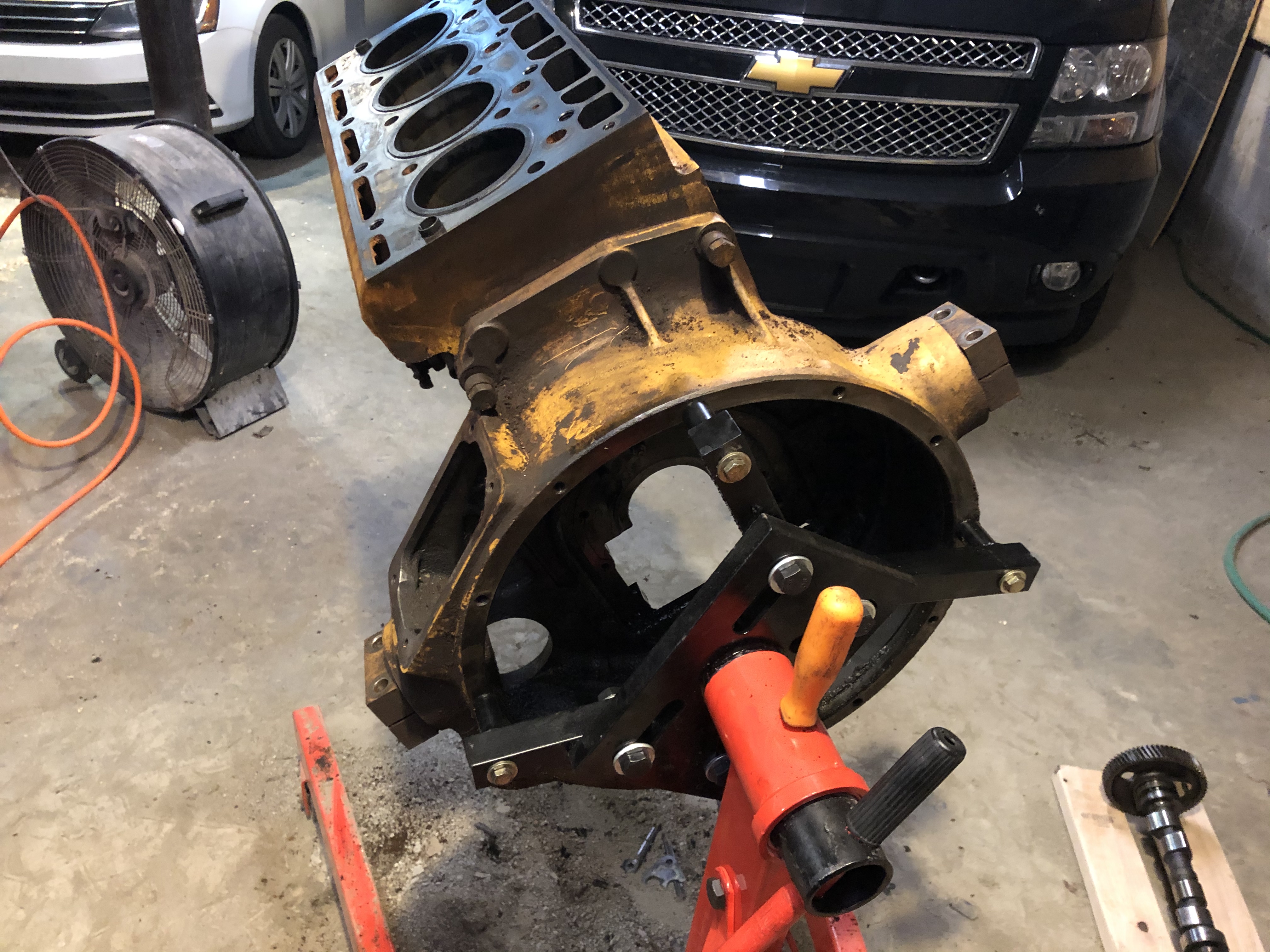

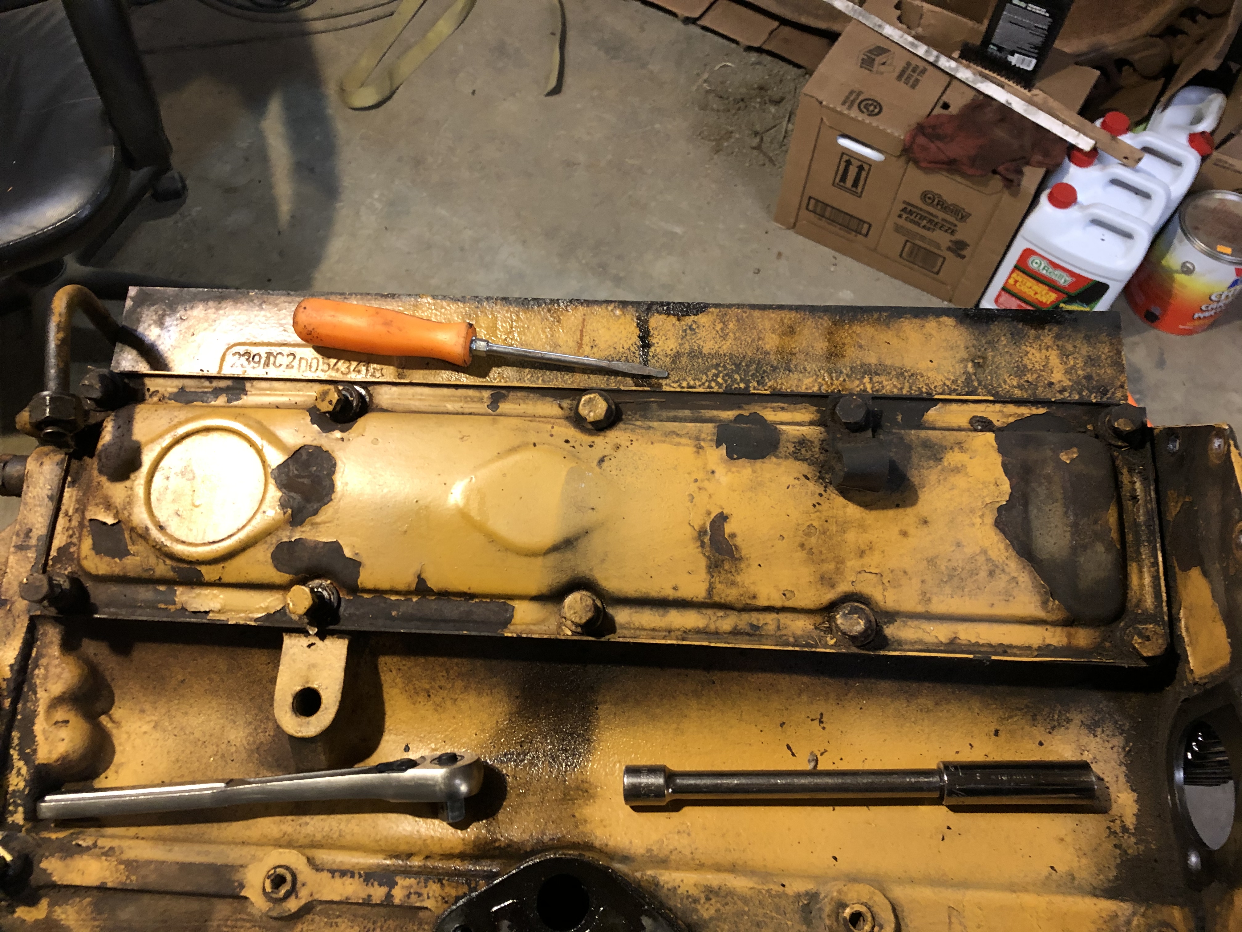

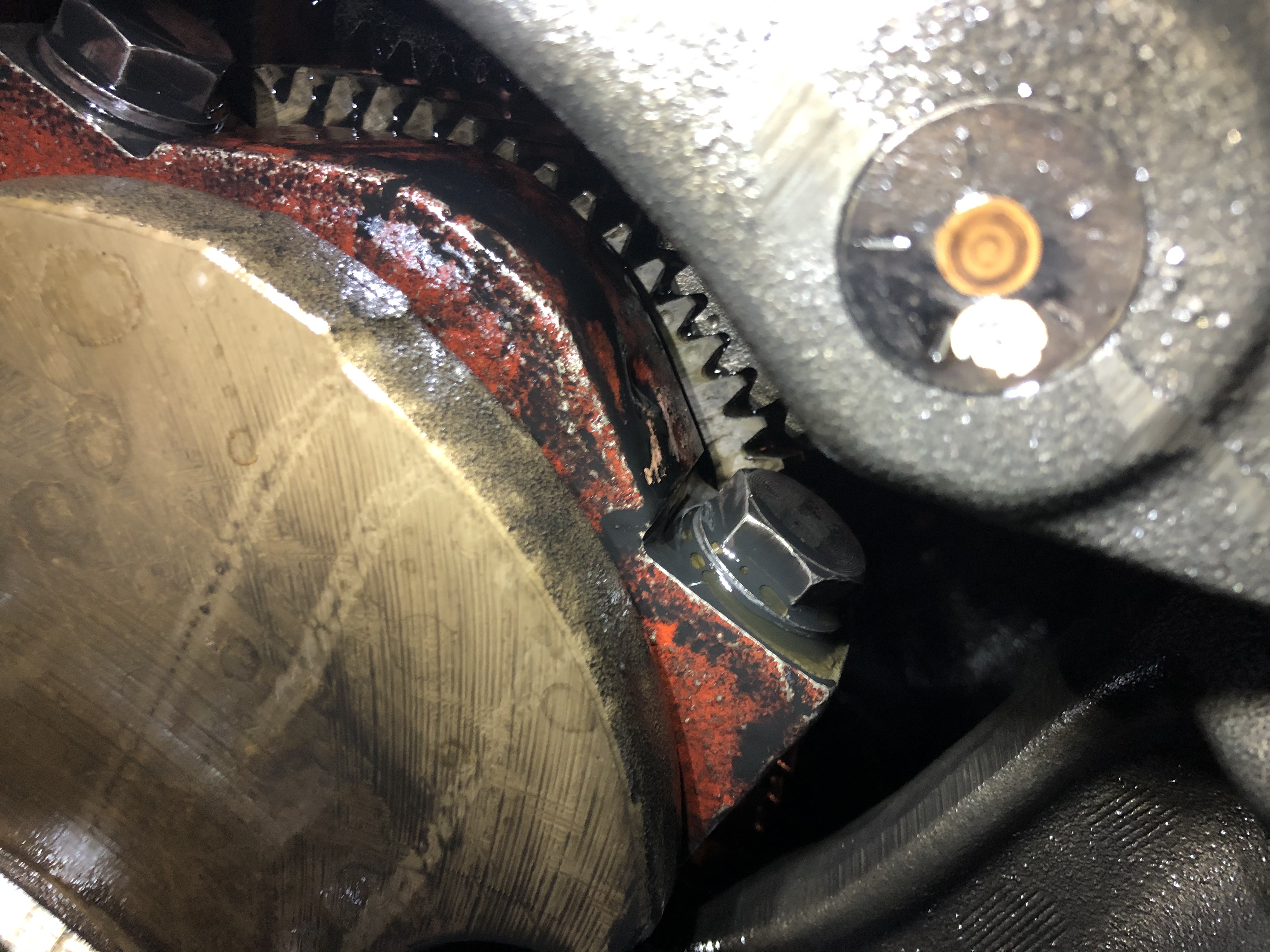

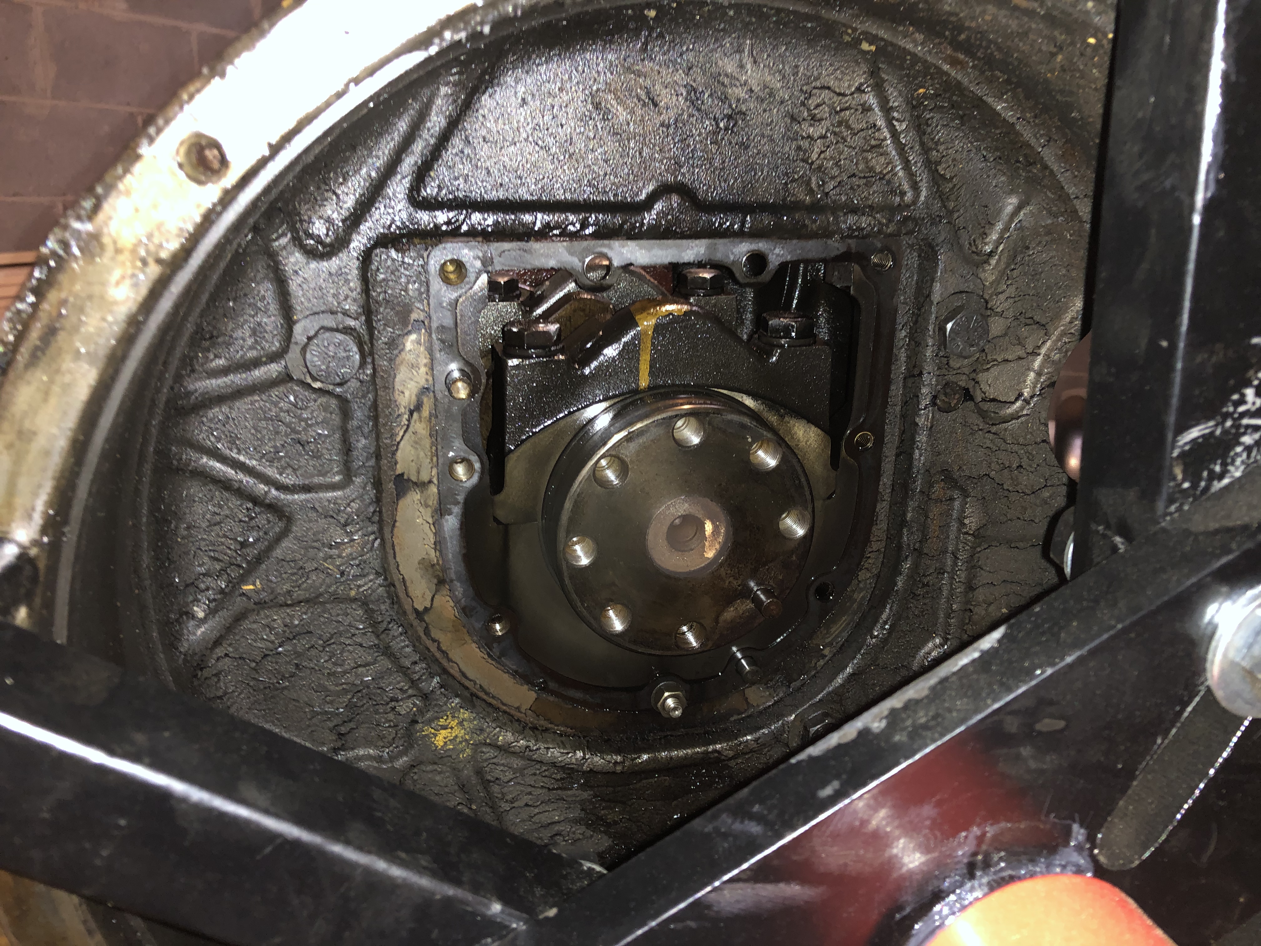

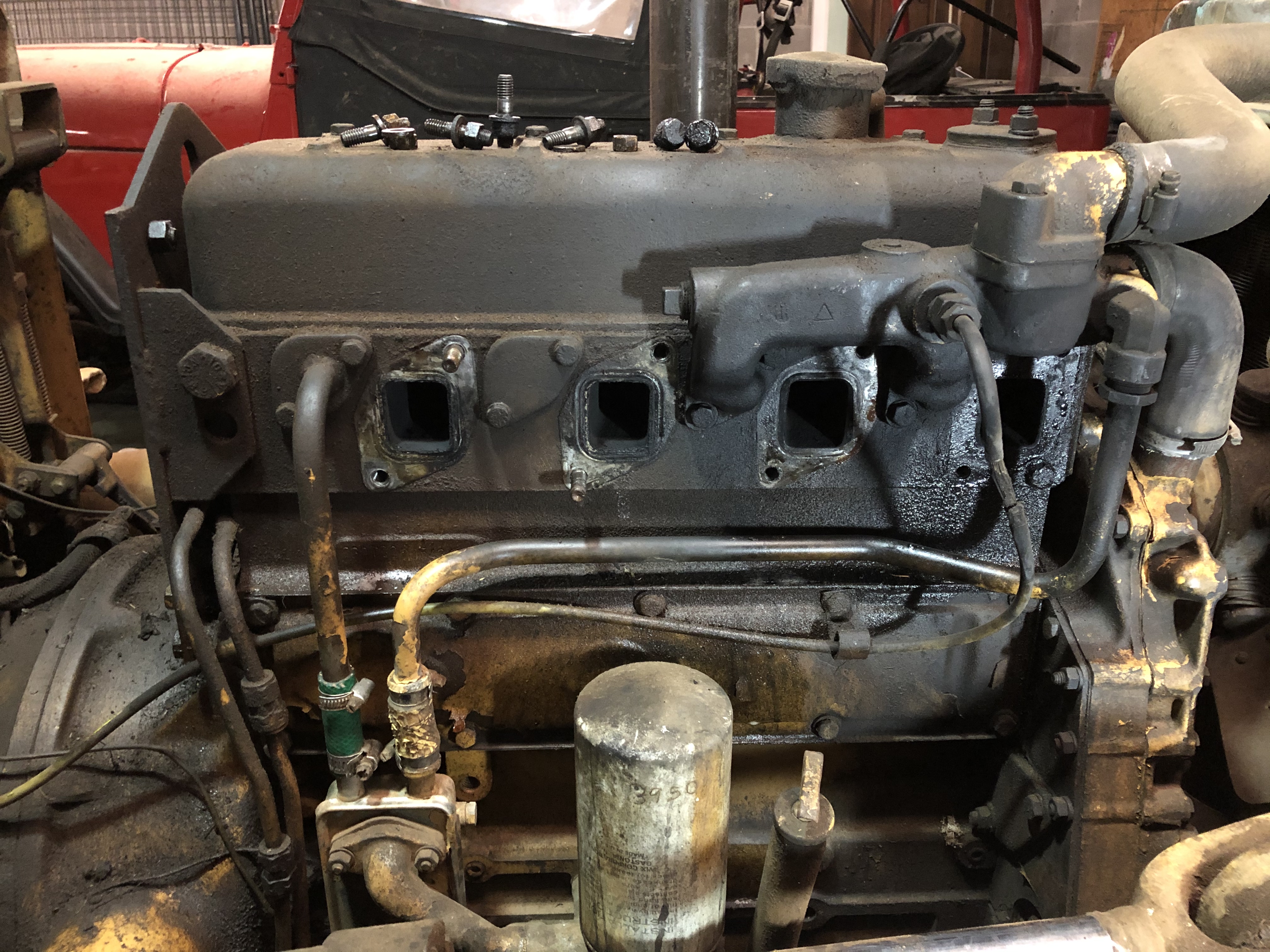

I have started working into the engine little by little, taking pictures at each step so that I can remember what order everything came off in. I am planning to do an in-frame overhaul but I have a few questions that I hope someone on here could answer for me. For some extra background, the dozer is a 1982 I think, and it has 4,245 hours on it, also I do not know if it has ever been rebuilt or had work done to it aside from the undercarriage.
From what I can tell, it would be very hard to get the torque converter out without removing the engine. My question is, how robust are these torque converters on equipment like this, I have no reference. To rebuild the whole engine, new parts are probably going to run me around $1200 with new fasteners, hoses, pumps, etc. These torque converters are around $3000 for a rebuilt one not including a $1500 core charge. Do I need to change this converter too or is it likely ok for a while? If I do need to do work on it, how hard is it to rebuild a torque converter? The transmission looks like it would come out without removing the engine so I will probably just leave it at first, I plan to go through it also but I do not have the $$$$ right now to do it all at once.
At this first stage I am planning to do the following, please chime in if there is something that you would add to this, I would like to only be into the engine once if possible:
> In frame engine overhaul (sleeves, pistons, rings, rod bearings)
> Rework head
> New water pump (coolant was full of rust chips)
> New oil pump
> New hoses/belts/fasteners
> New undercarriage front idler (wobbles back and forth like the bearing is gone)
> Change ALL fluids (engine stuff obviously, but also all hydraulic oil and filters)

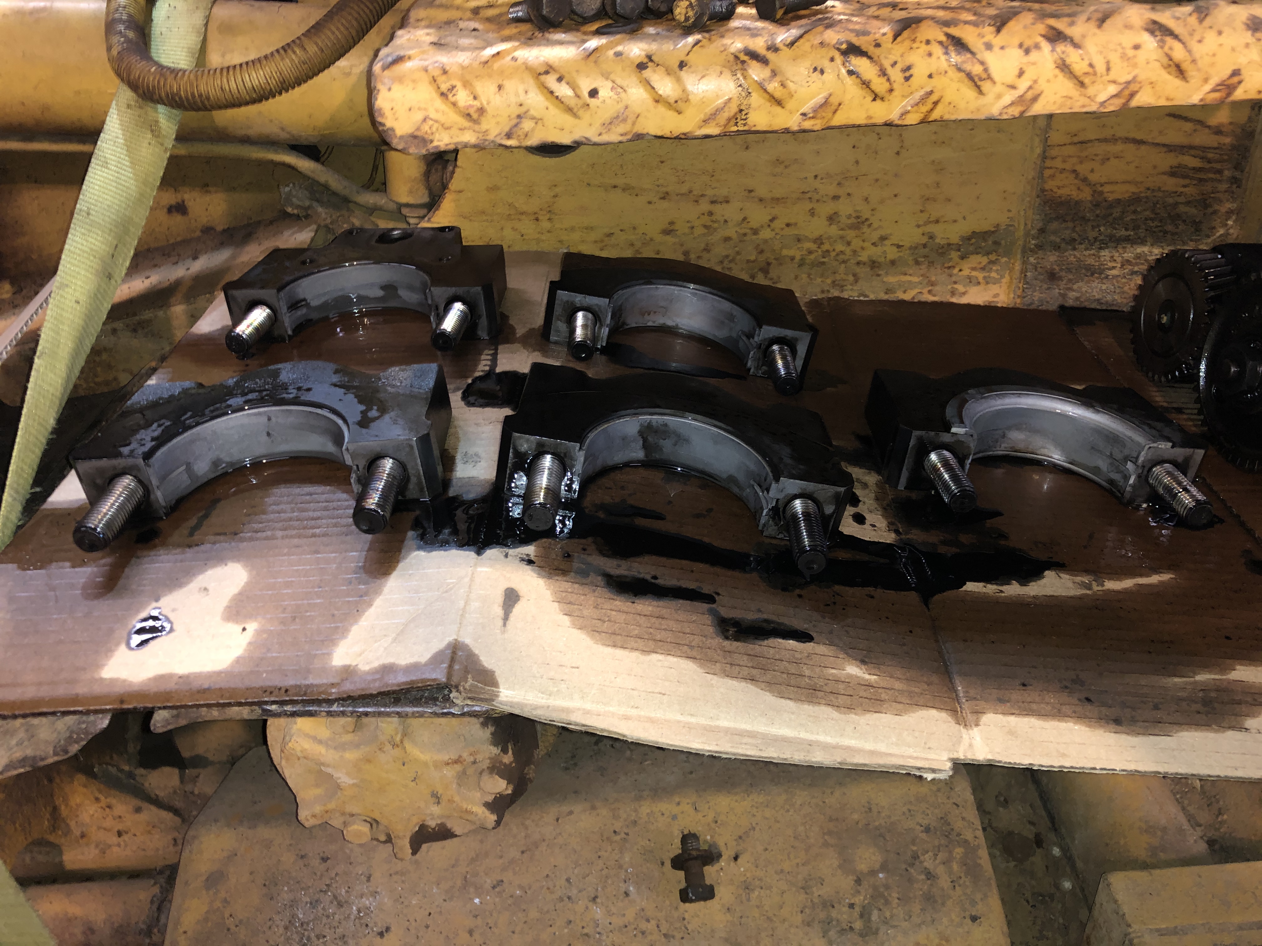

Finally for your enjoyment here are some pictures of what I have found so far as I have been taking apart this engine, I will post more as I go.

Converter is o.k. if it moves strong and the shift is solid. The 7 is a nice dozer, handy size and easy to run. I would say engine removal for converter removal. I used to have several TD-9's, older ones, didn't care much for them, always broke down, Still have the TD-250-C loader, 573 turbo V-8, power shift, power steering and 4 in 1 bucket. My wife named it MOOSE. I did a lot of heavy work with it over the years.

I have another question, does anyone know if the engine can be removed without removing the torque converter? I was wondering if it would be possible to detach it from the flywheel and remove the engine while leaving the torque converter in place. I have been debating on including the main bearings and seals in the overhaul but I am not sure if I should do it all or not. There isnt that much cost difference in the kits but it could be a tremendous amount of work if I have to remove the torque converter. If I see anything on the crank when the pan comes off I will go ahead pull the motor, but if the crank looks good should I just leave the crank and the mains in place?

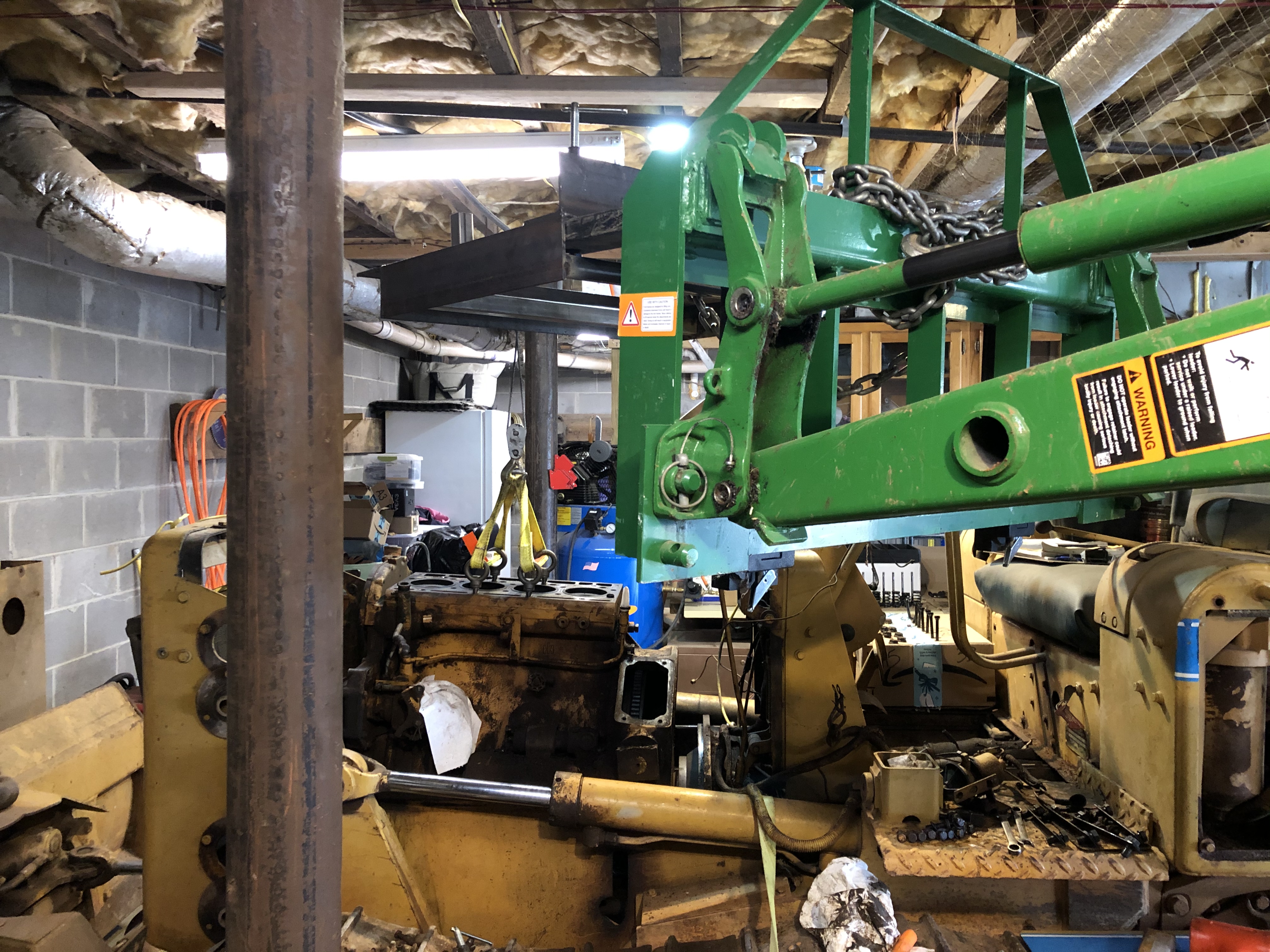

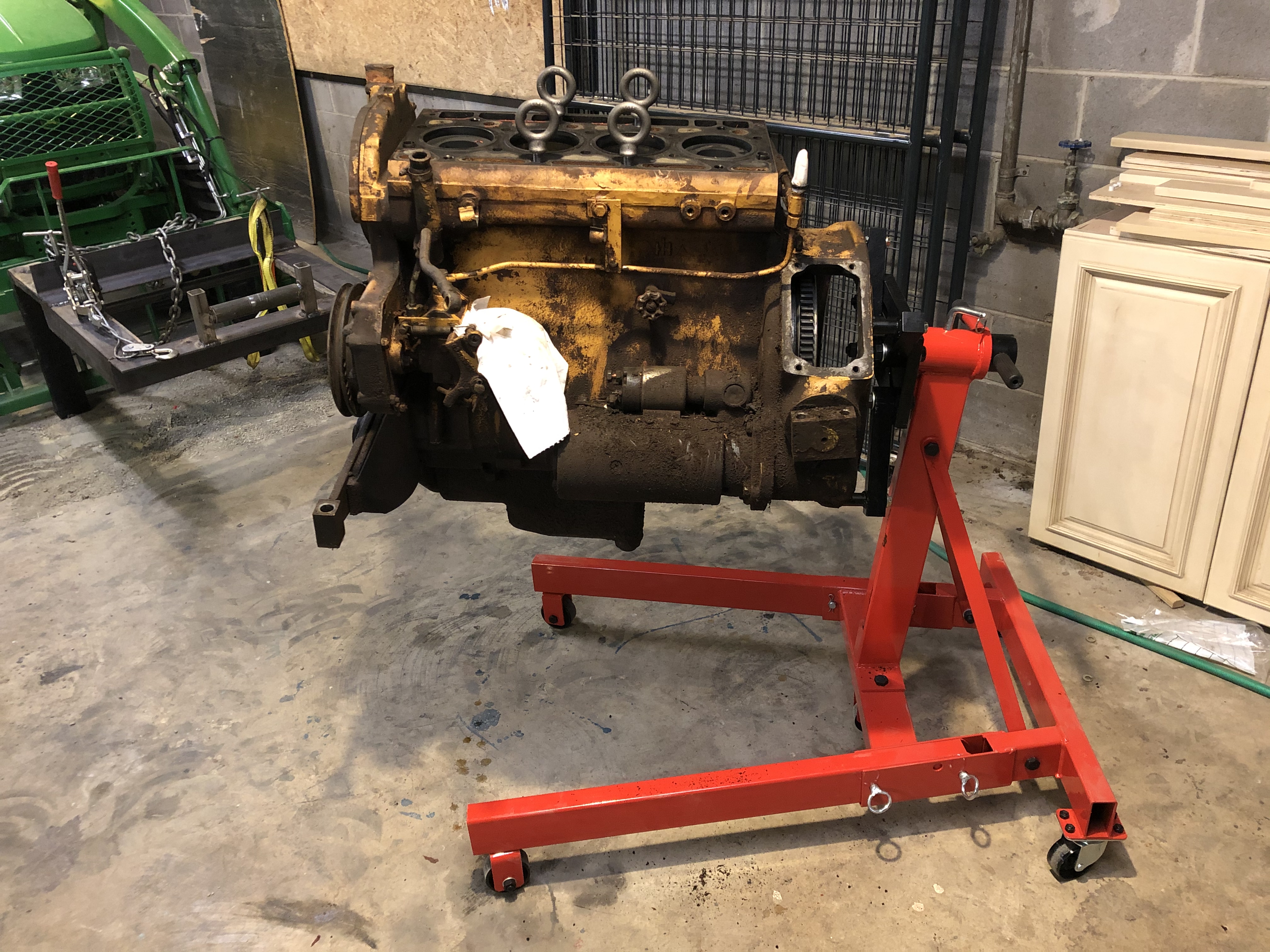

Ok guys, I apologize for taking so long to update this again, I got into the project started and never followed up with posts, I have actually completed the engine rebuild and got it put back into the dozer. I am going to post this in pieces because it crashed when I tried to put them all up the first time (I wish there was a way to bulk upload these):

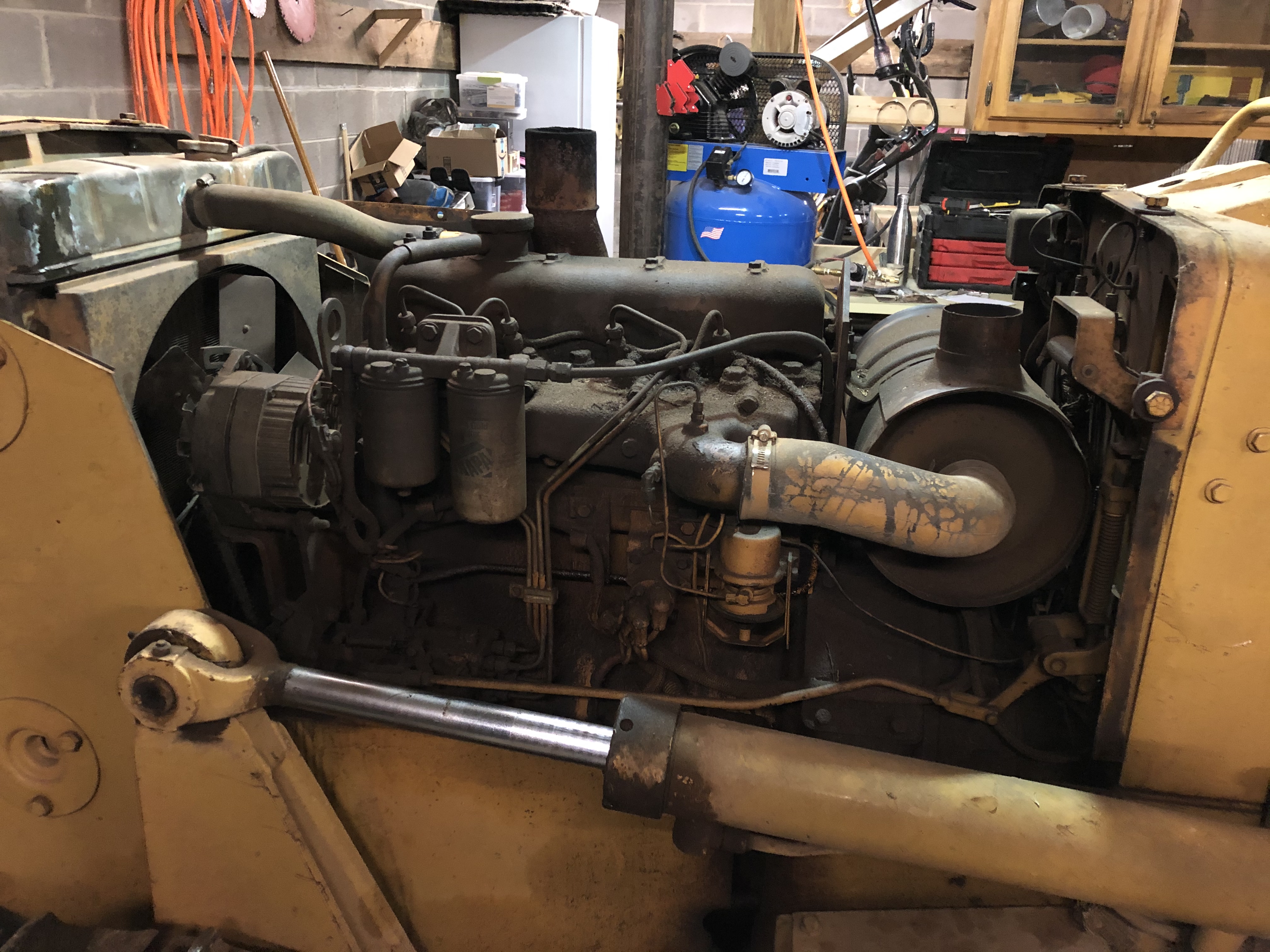

Here is pulling the motor with the tractor:

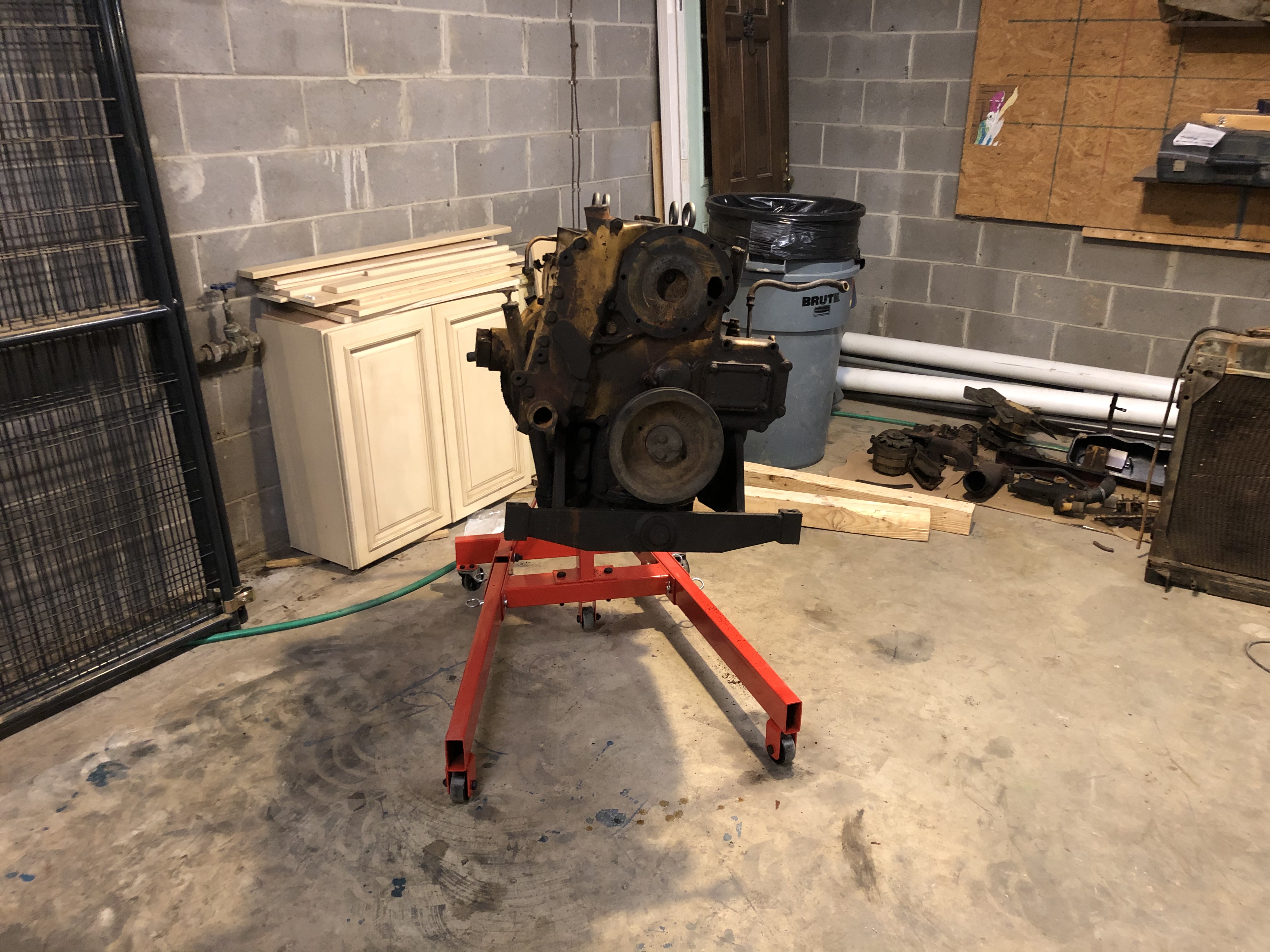

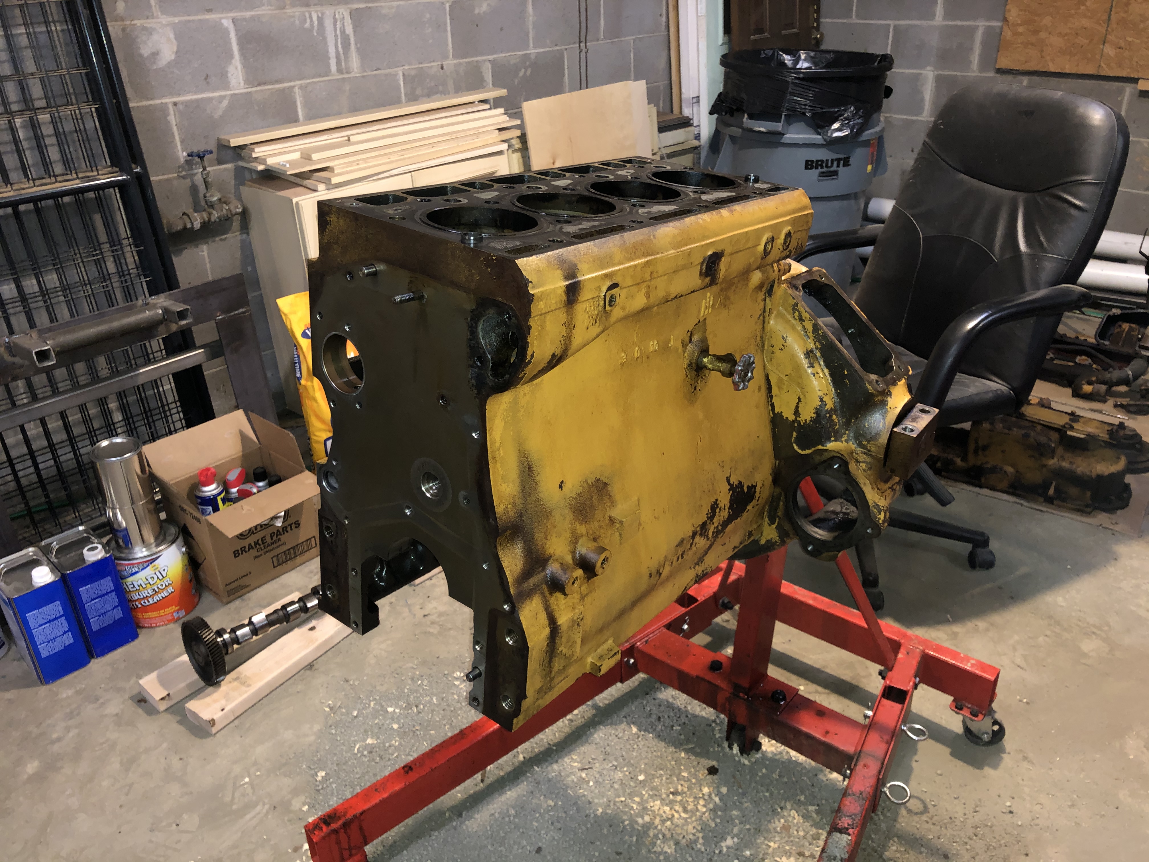

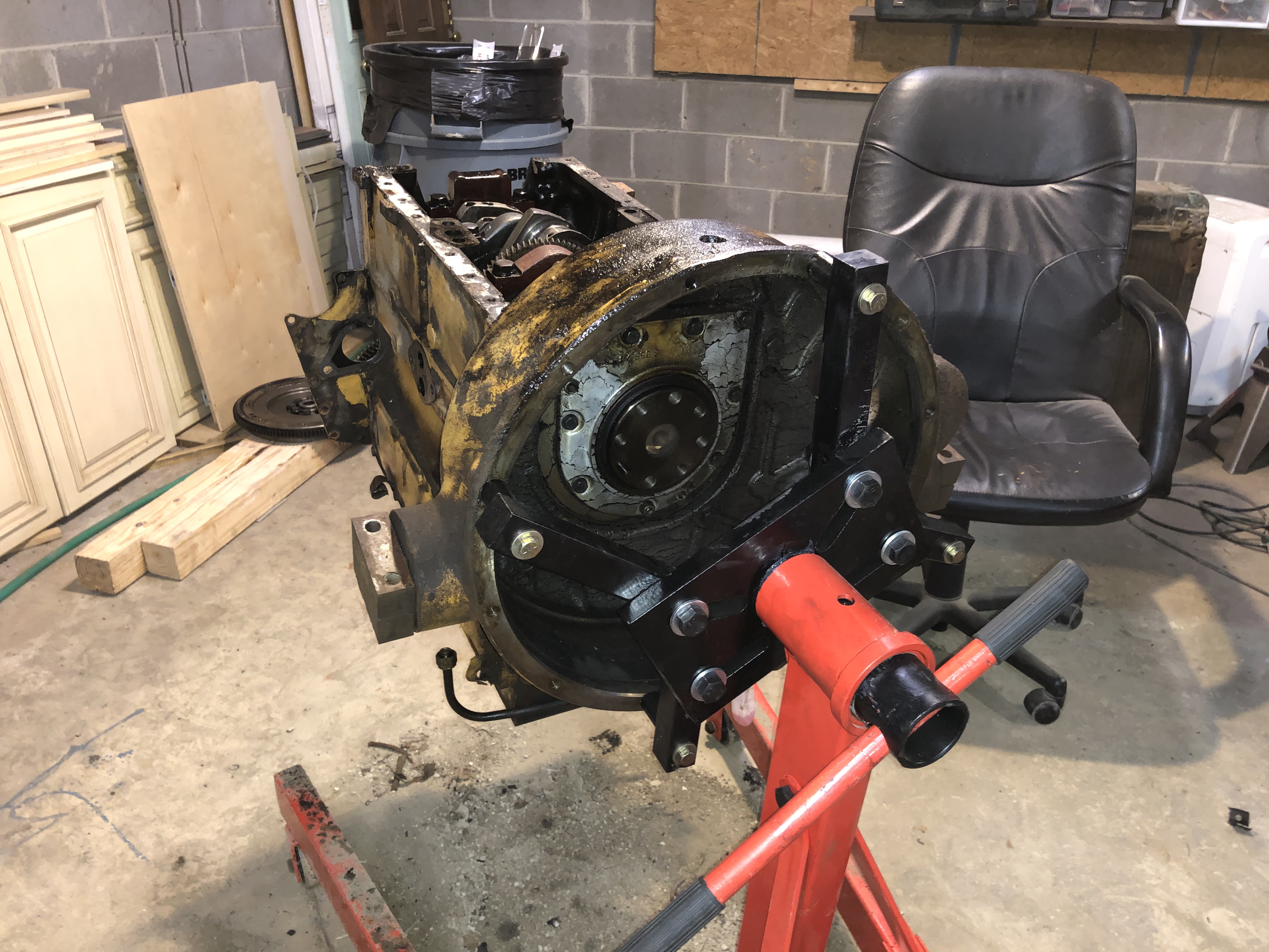

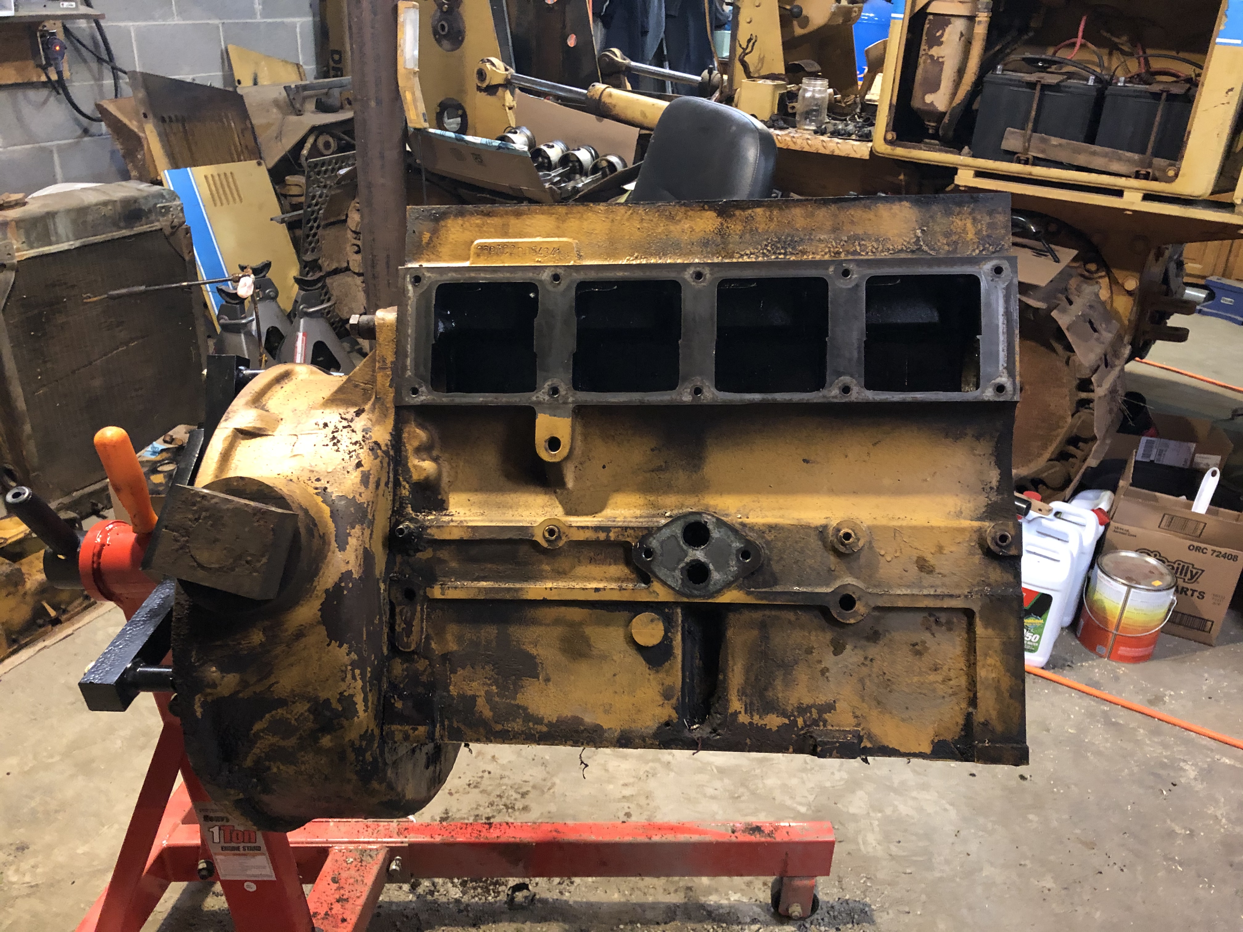

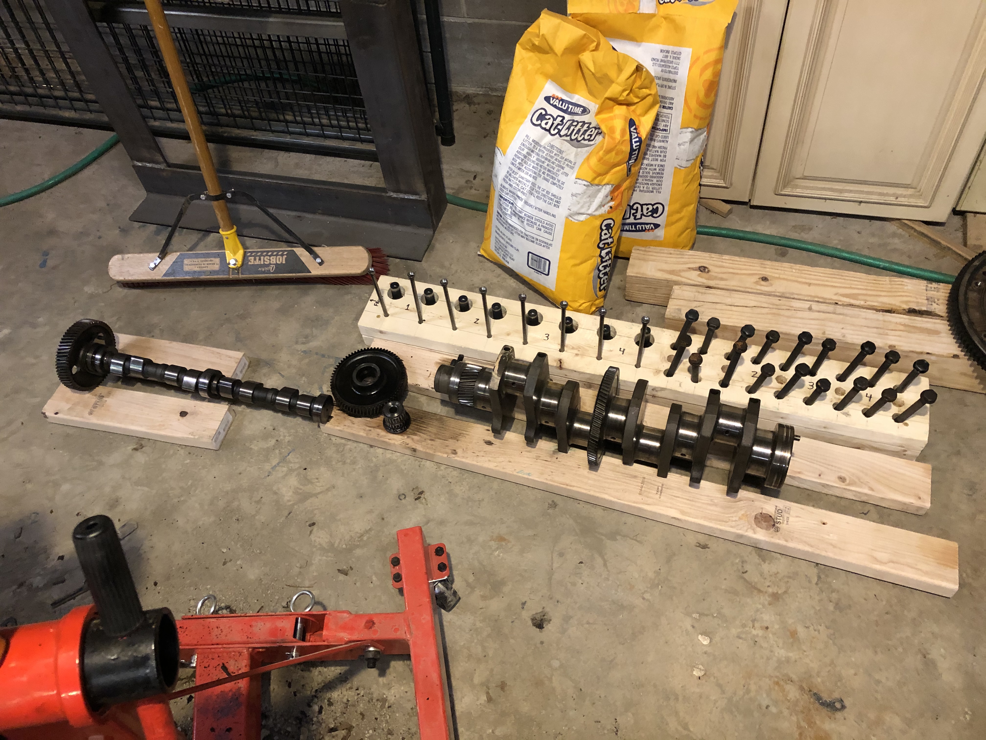

Here are some pictures of breaking down the motor (If anyone wants to see more detail of something let me know, I have a whole lot more pictures than what I am posting):
2019-12-28 15.06.37.jpg2019-12-30 22.37.25.jpg2019-12-30 23.16.25.jpg2019-12-31 11.16.05.jpg2019-12-31 11.16.16.jpg2019-12-31 11.16.25.jpg2019-12-31 13.11.05.jpg2019-12-31 13.11.10.jpg2019-12-31 13.11.17.jpg2019-12-31 13.11.21.jpg2019-12-30 16.39.57.jpg2019-12-30 16.39.41.jpg2019-12-30 16.27.33.jpg2019-12-28 15.08.12.jpg2019-12-28 21.17.17.jpg2019-12-28 21.59.23.jpg2019-12-28 21.59.34.jpg2019-12-28 21.59.46.jpg2019-12-28 23.41.29.jpg2019-12-29 22.22.10.jpg2019-12-30 16.17.47.jpg2019-12-30 16.26.09.jpg2019-12-31 13.11.30.jpg
Edit: I apologize that these are not in order, I just tried the attachment function.

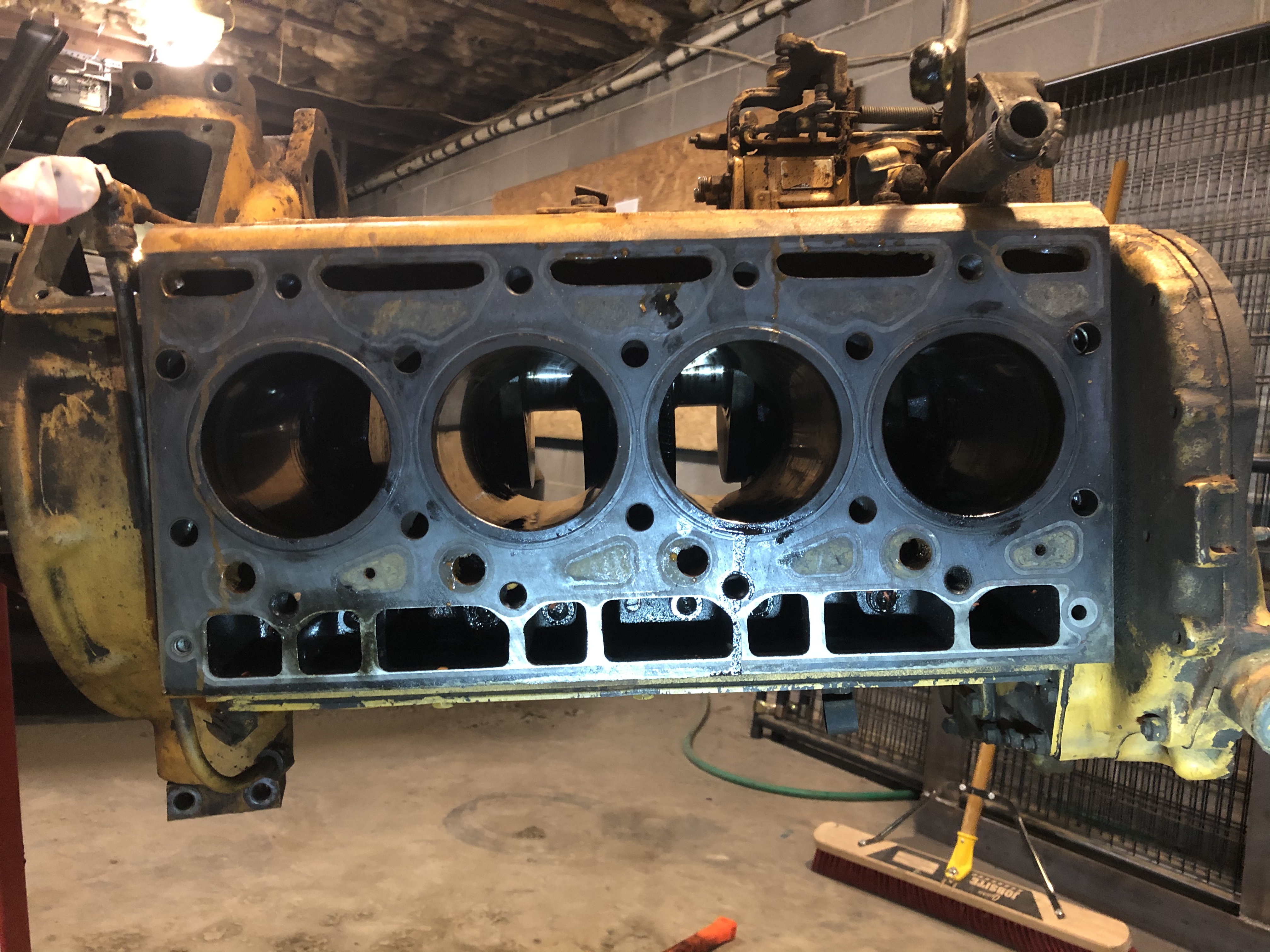

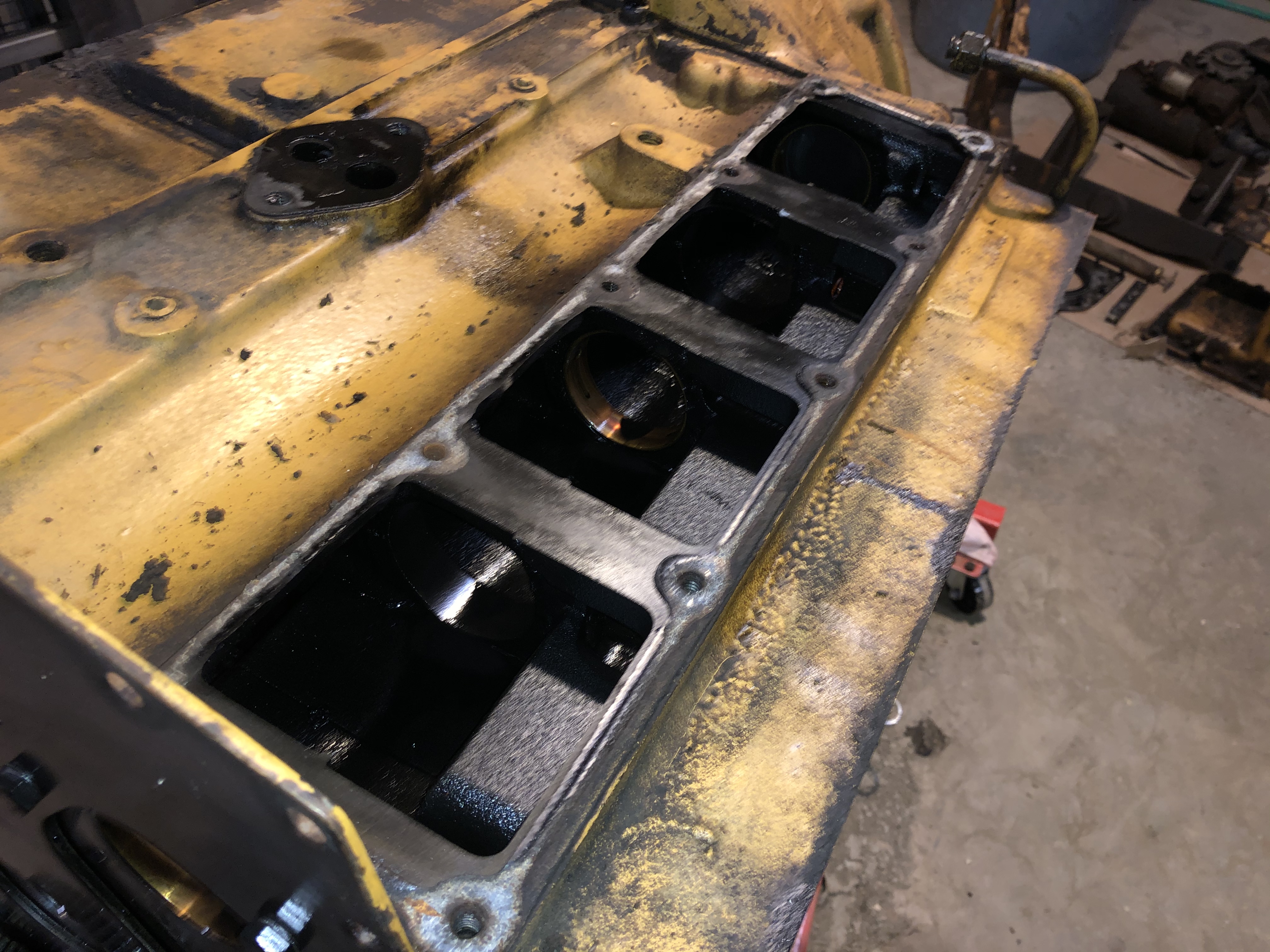

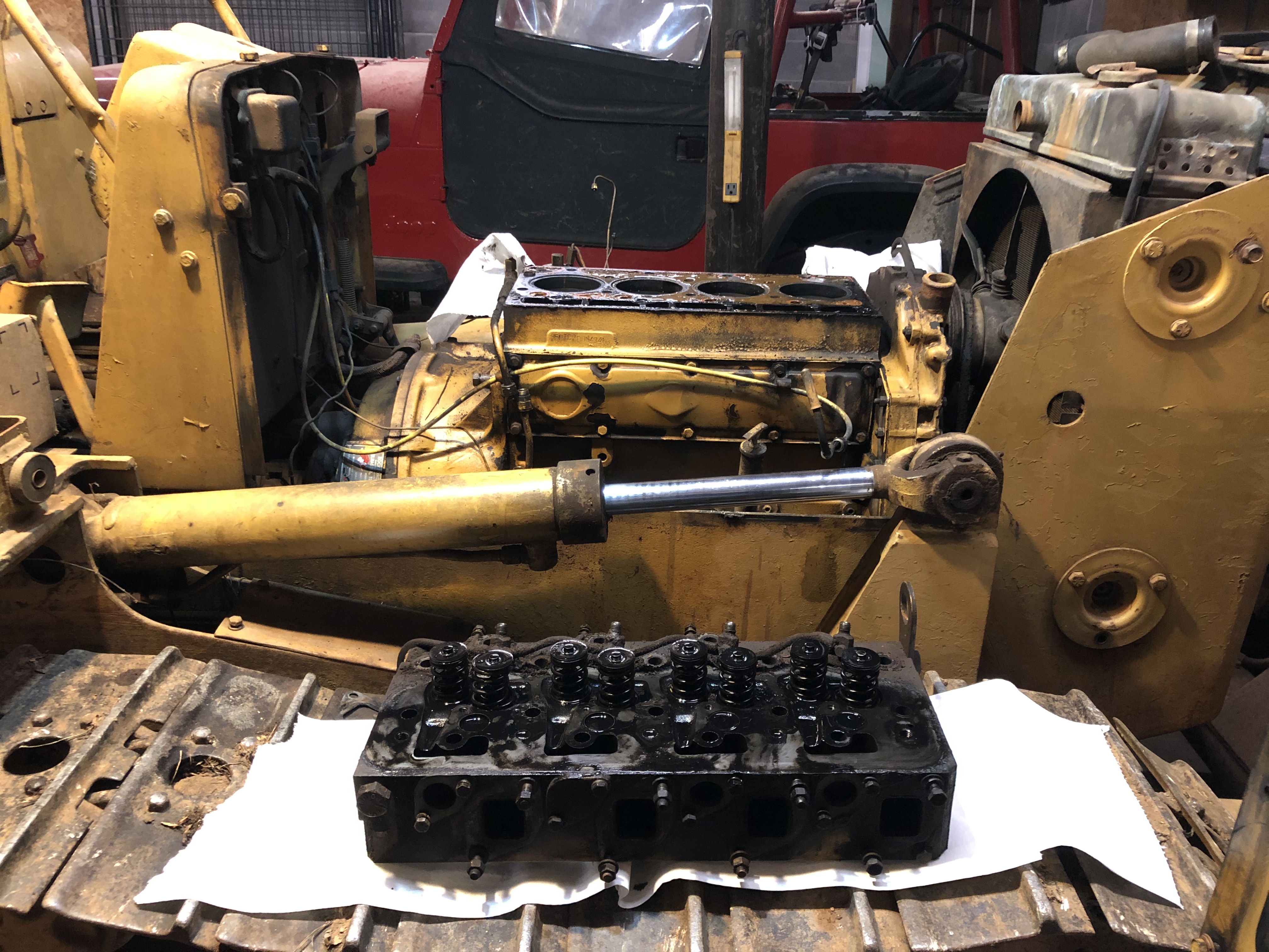

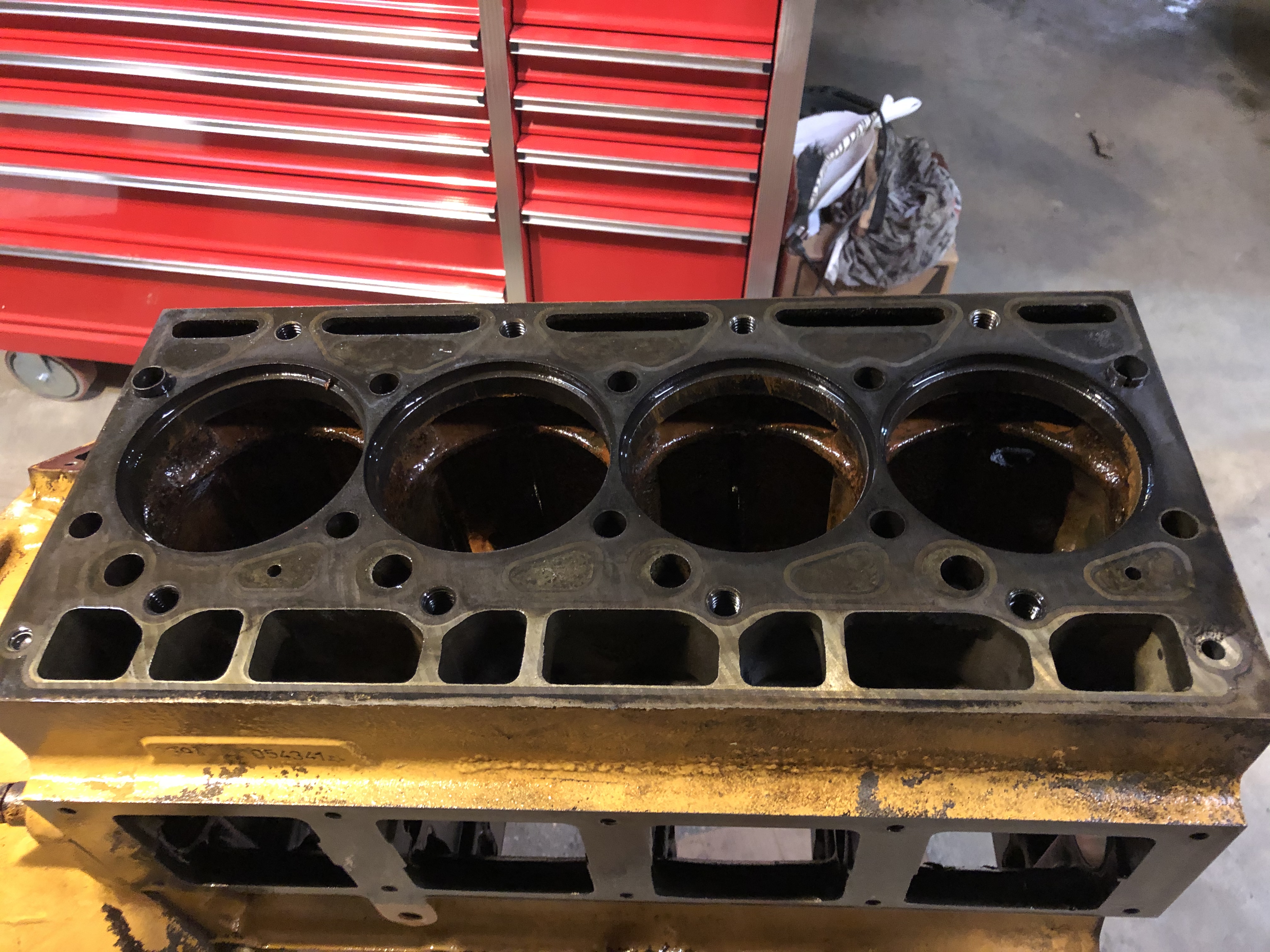

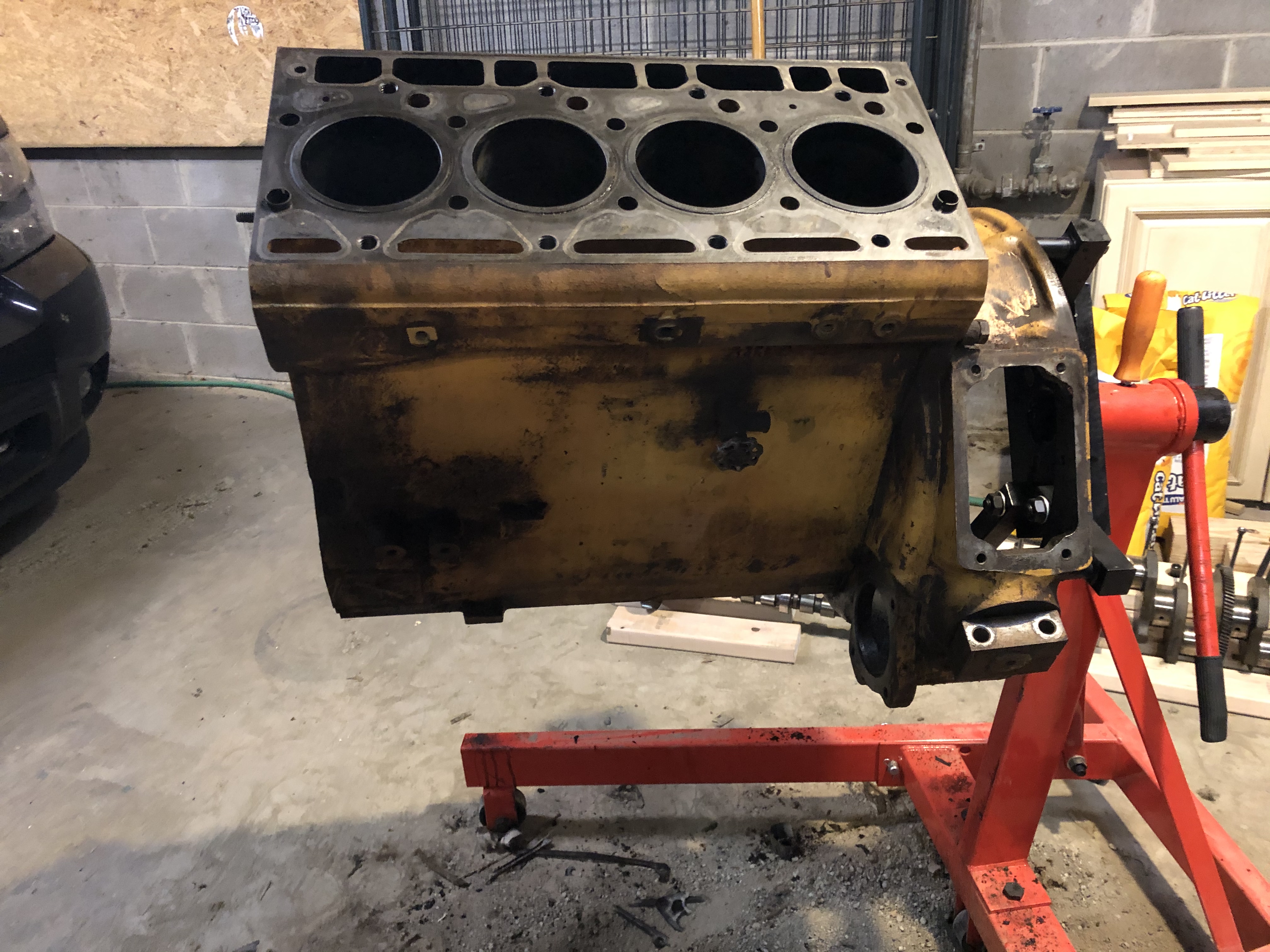

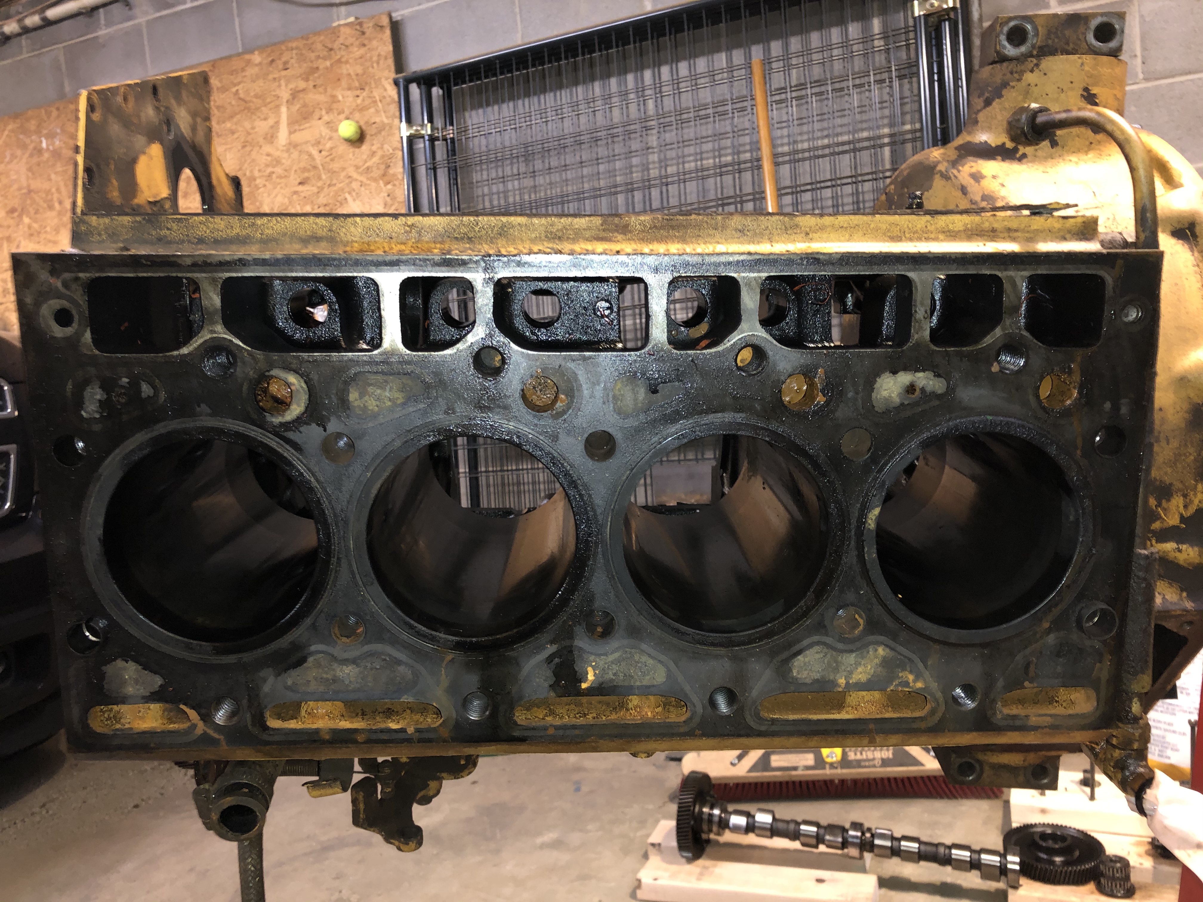

Here are some pictures of the cylinder head disassembly along with the cleaning of the block and cylinder head, this is the point when I started moving in the other direction (assembly instead of disassembly):

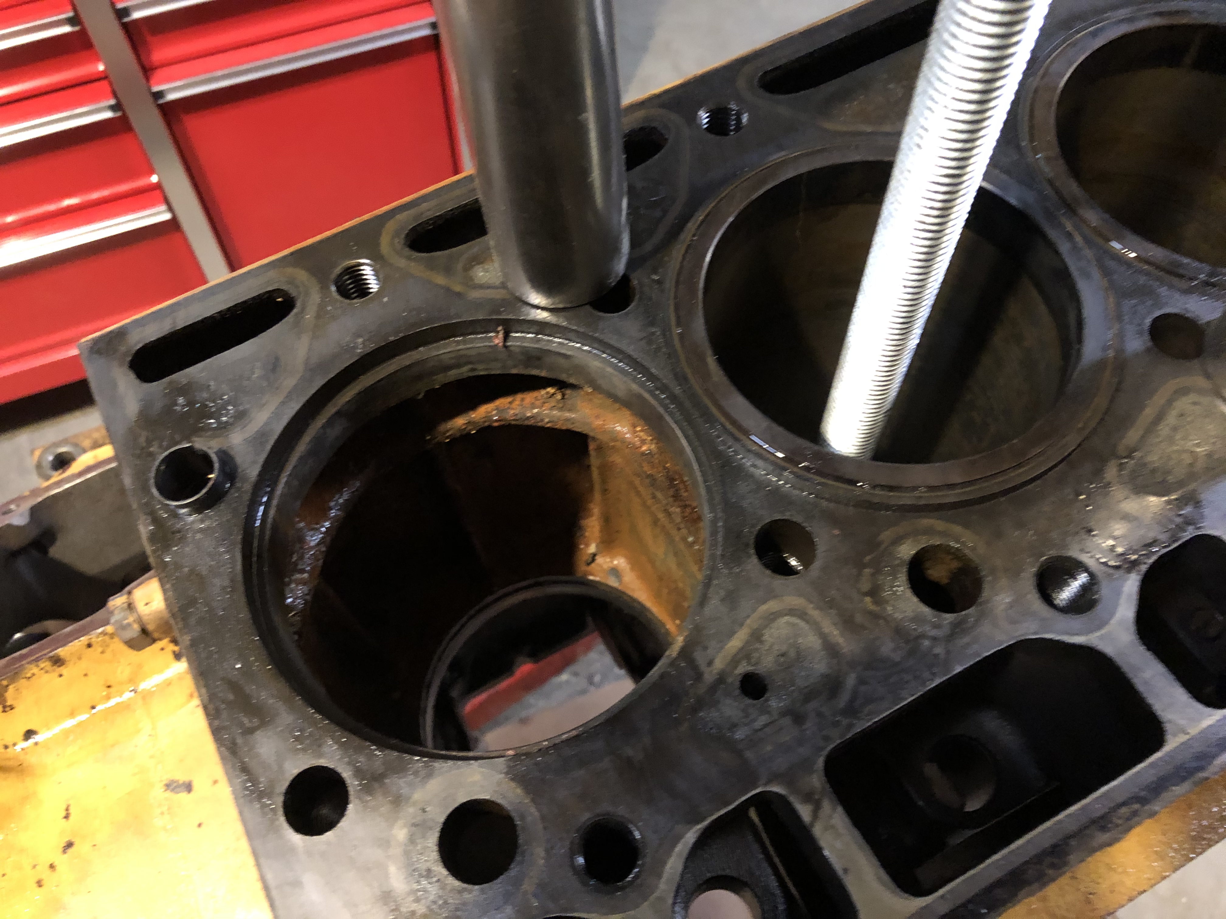

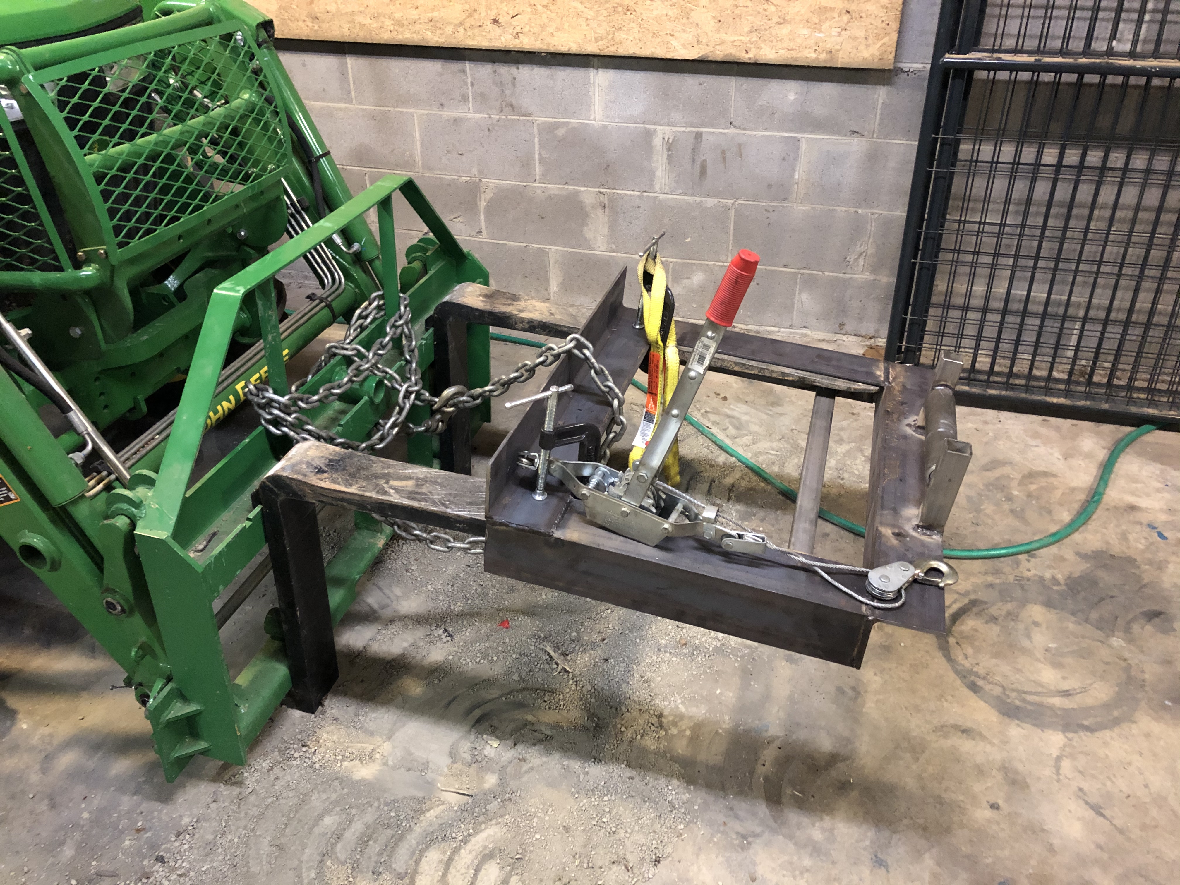

Just kidding, here are the pictures of removing the linings with the puller that I built, this was the last step before starting assembly:

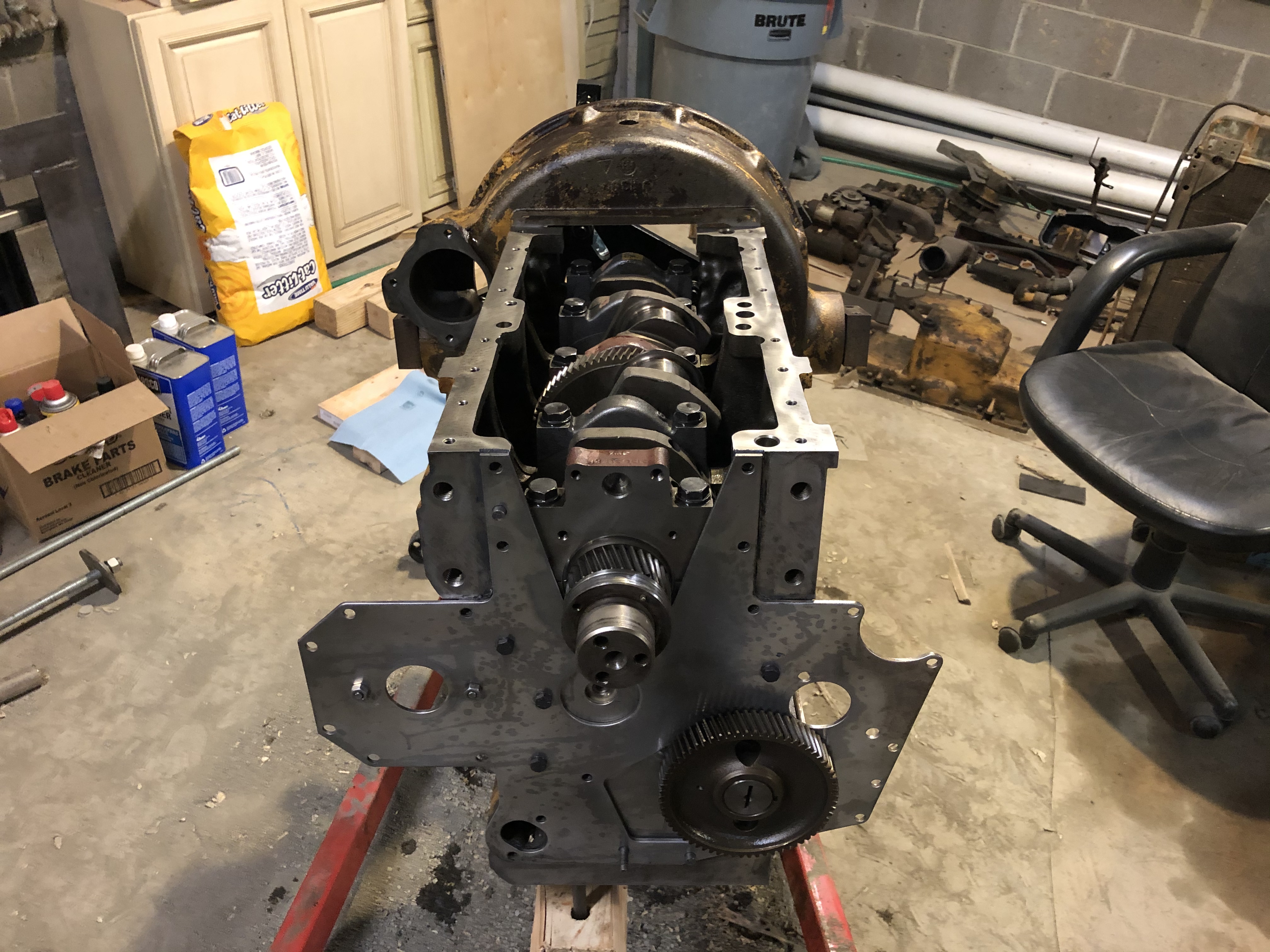

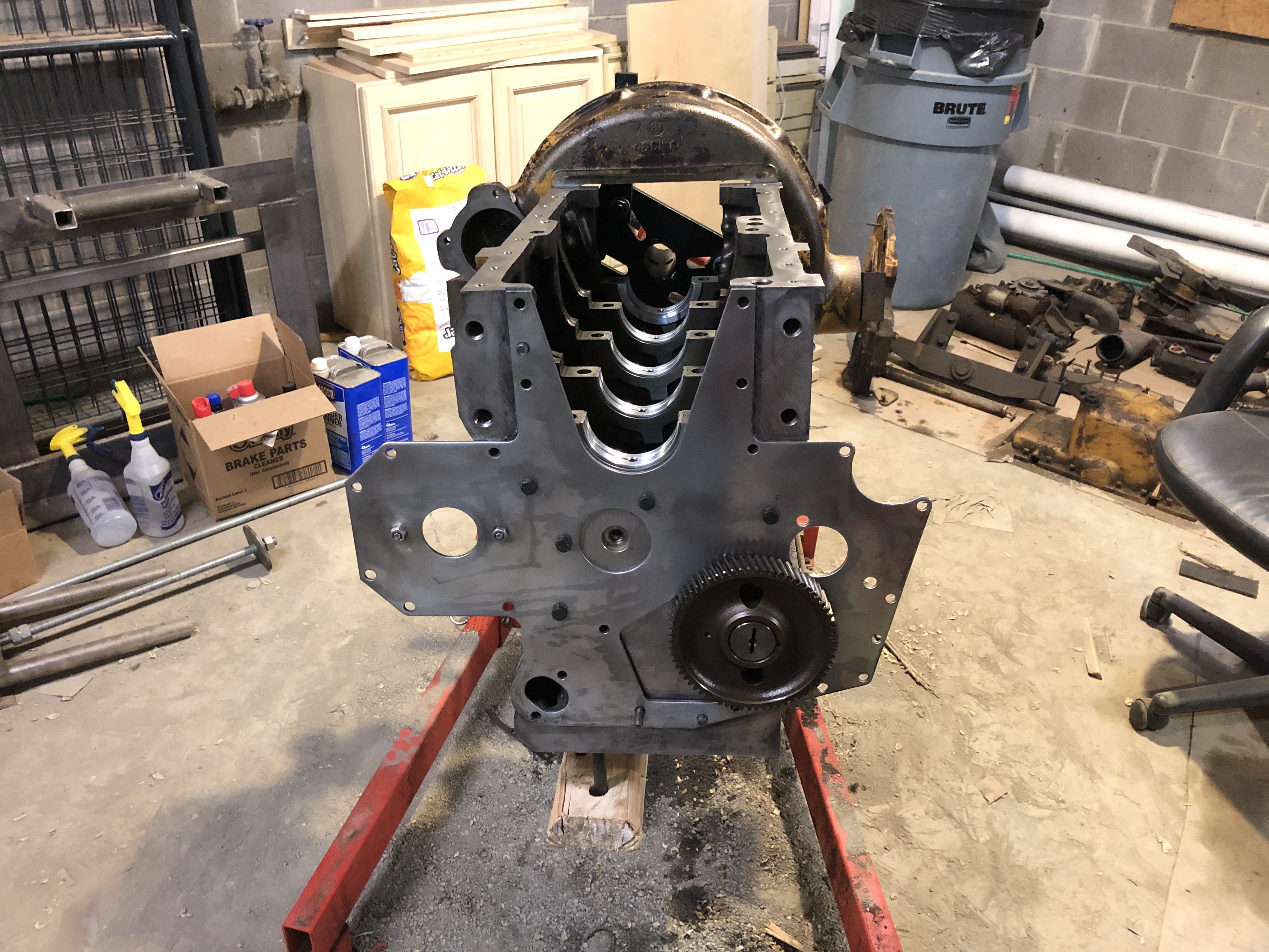

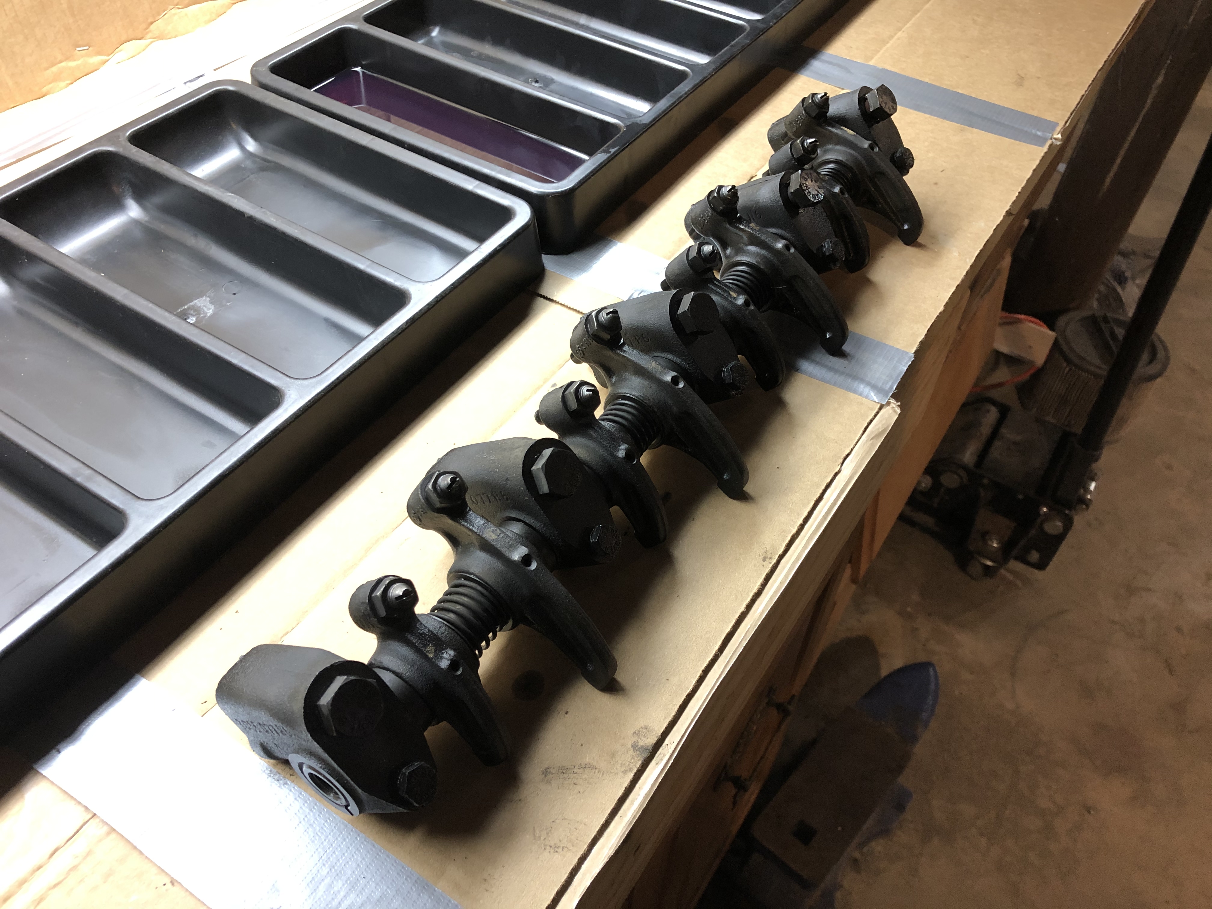

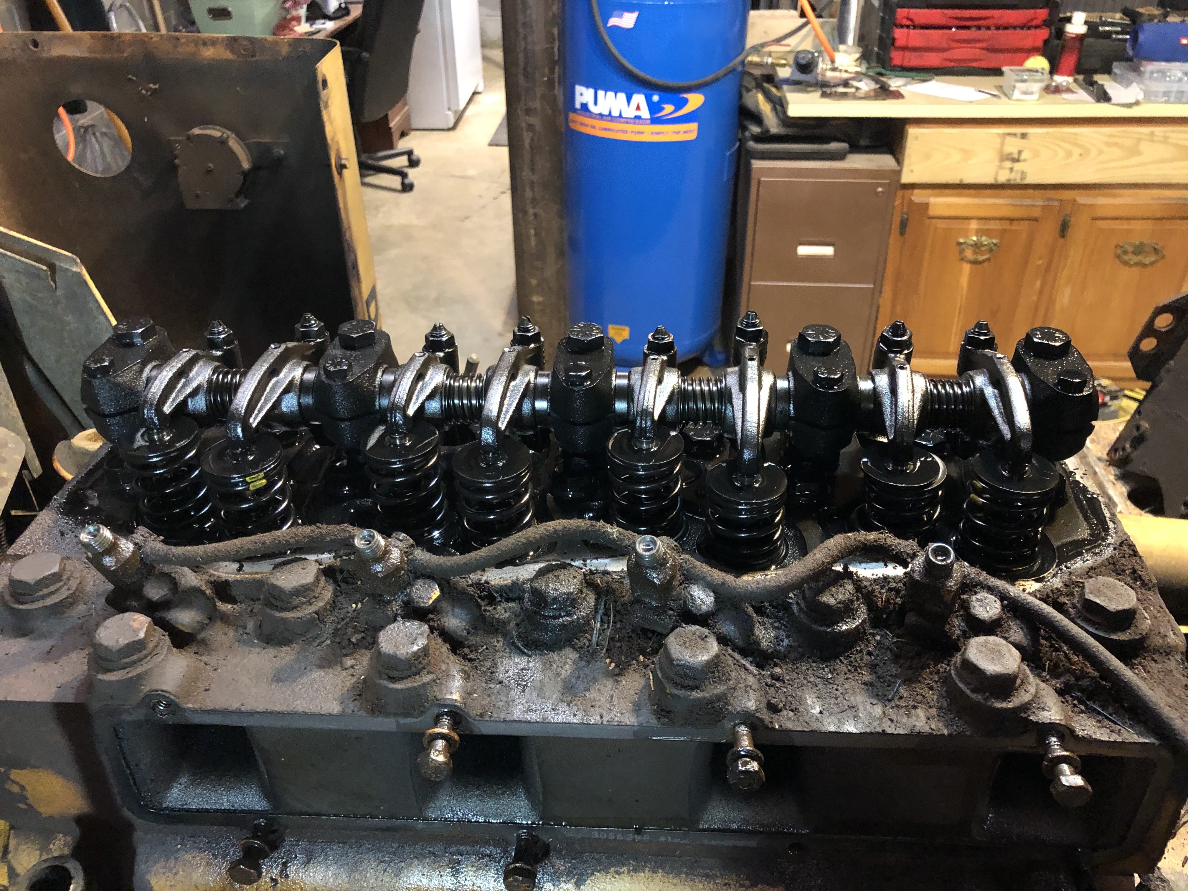

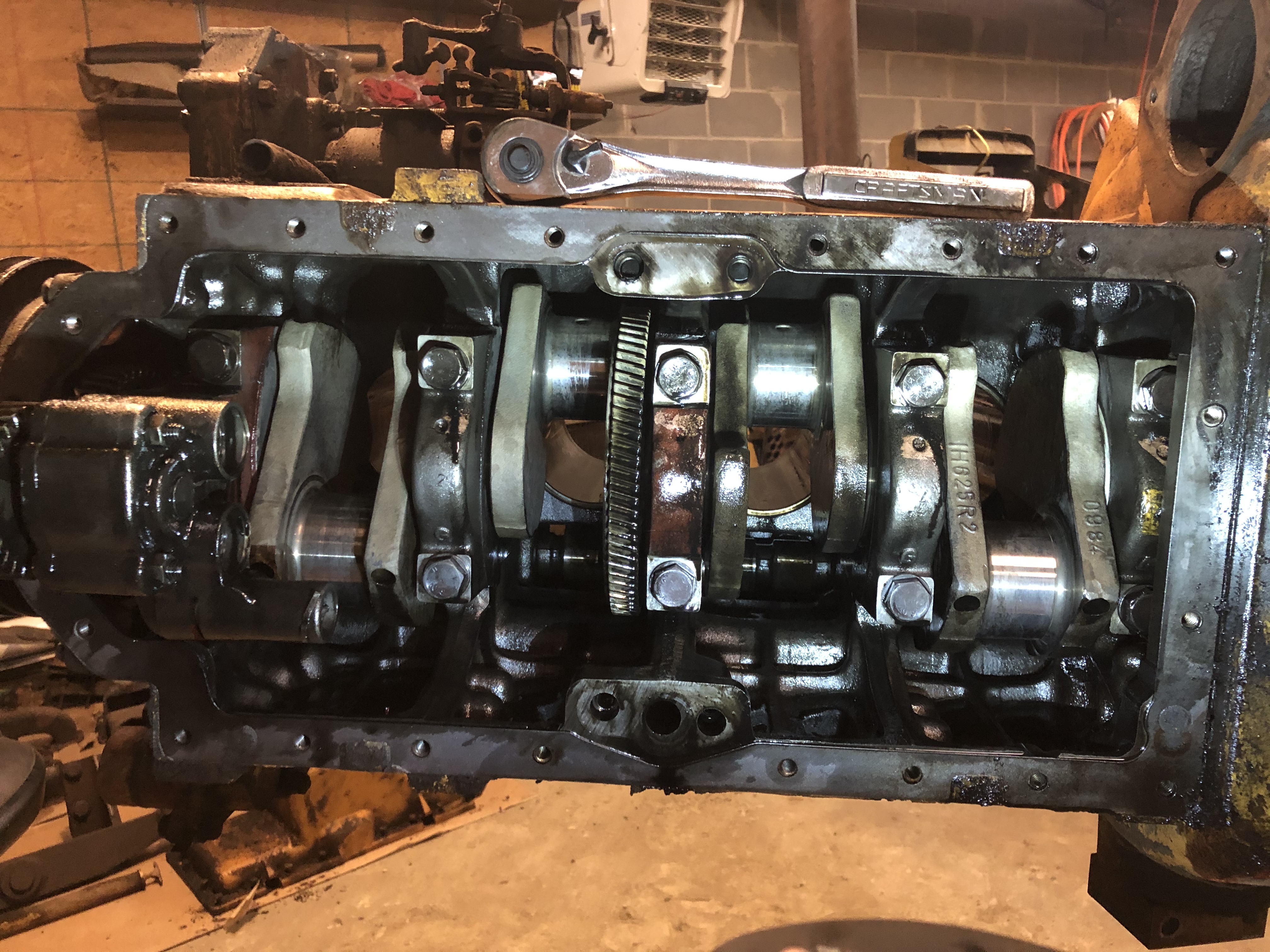

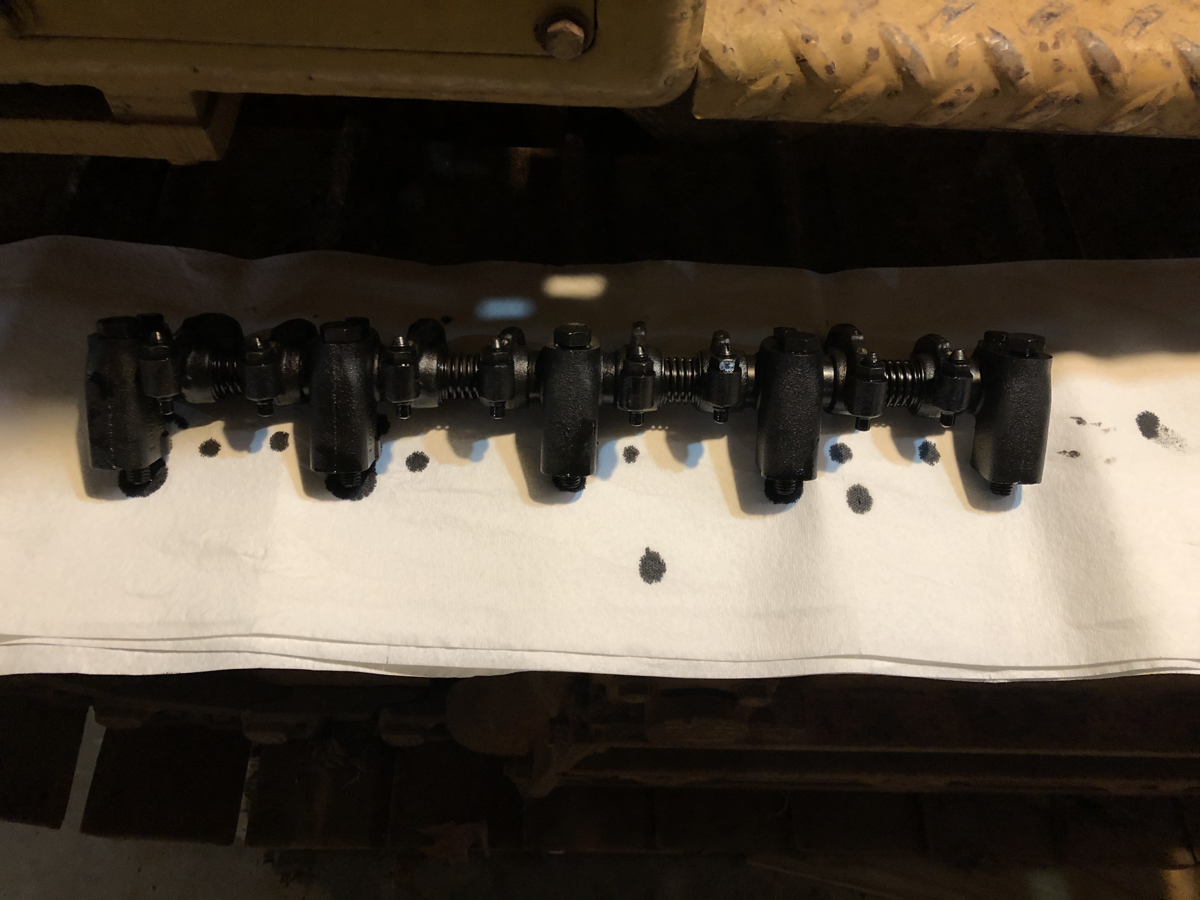

Rocker arm shaft disassembly and cleaning along with linings, main bearings, timing plate, cam, and crankshaft installation:

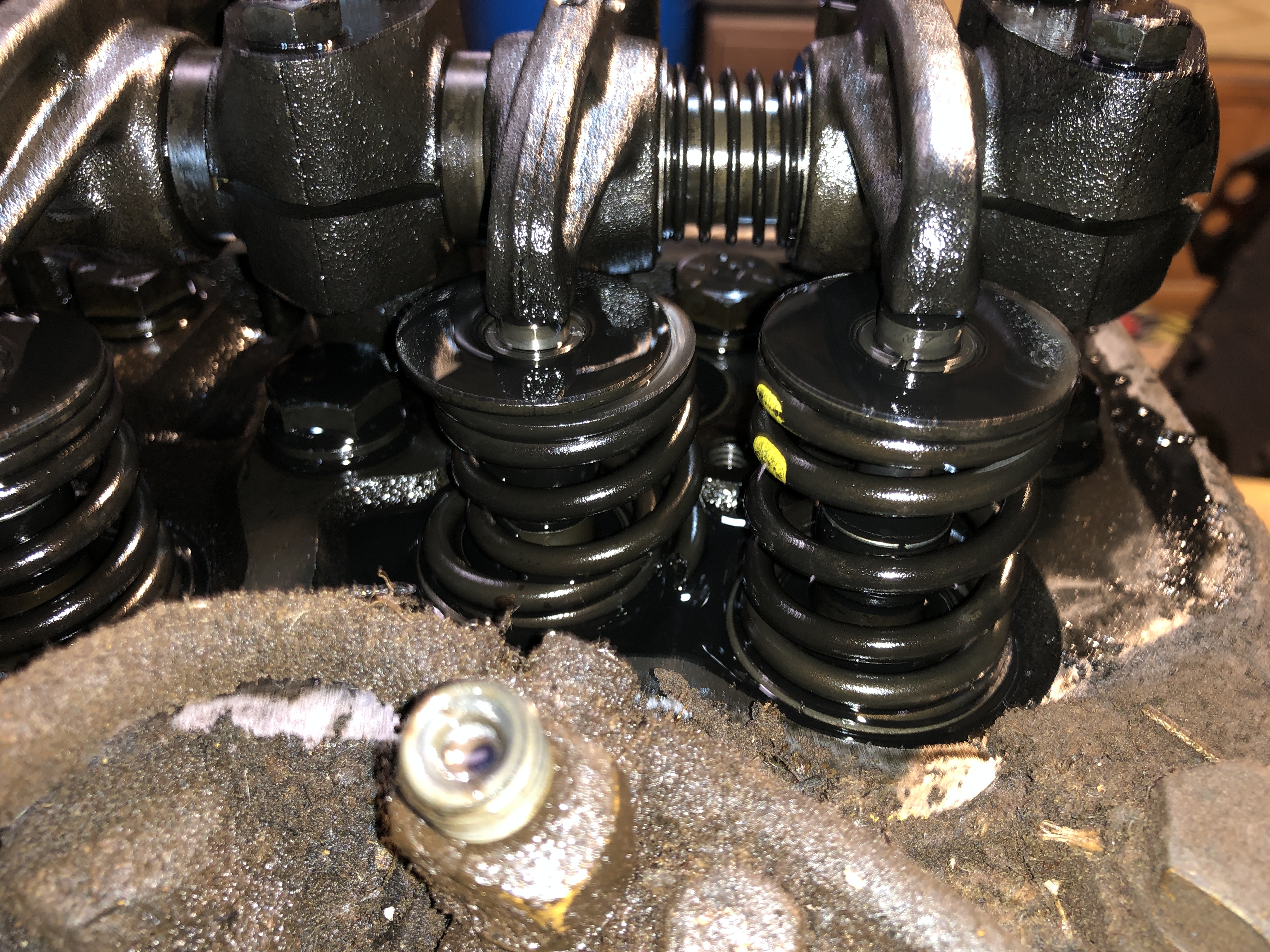

New pistons, rod bearings, rod bushings, and rings. New oil pump installed along with balancer. Cylinder head reassembly with new valves, valve springs, valve guides, valve retainers, and valve seals. Rocker arm shaft reinstalled and injectors cleaned and installed so at this point it is ready to bolt back on the motor. Idler gear installed and all components except injection pump timed.

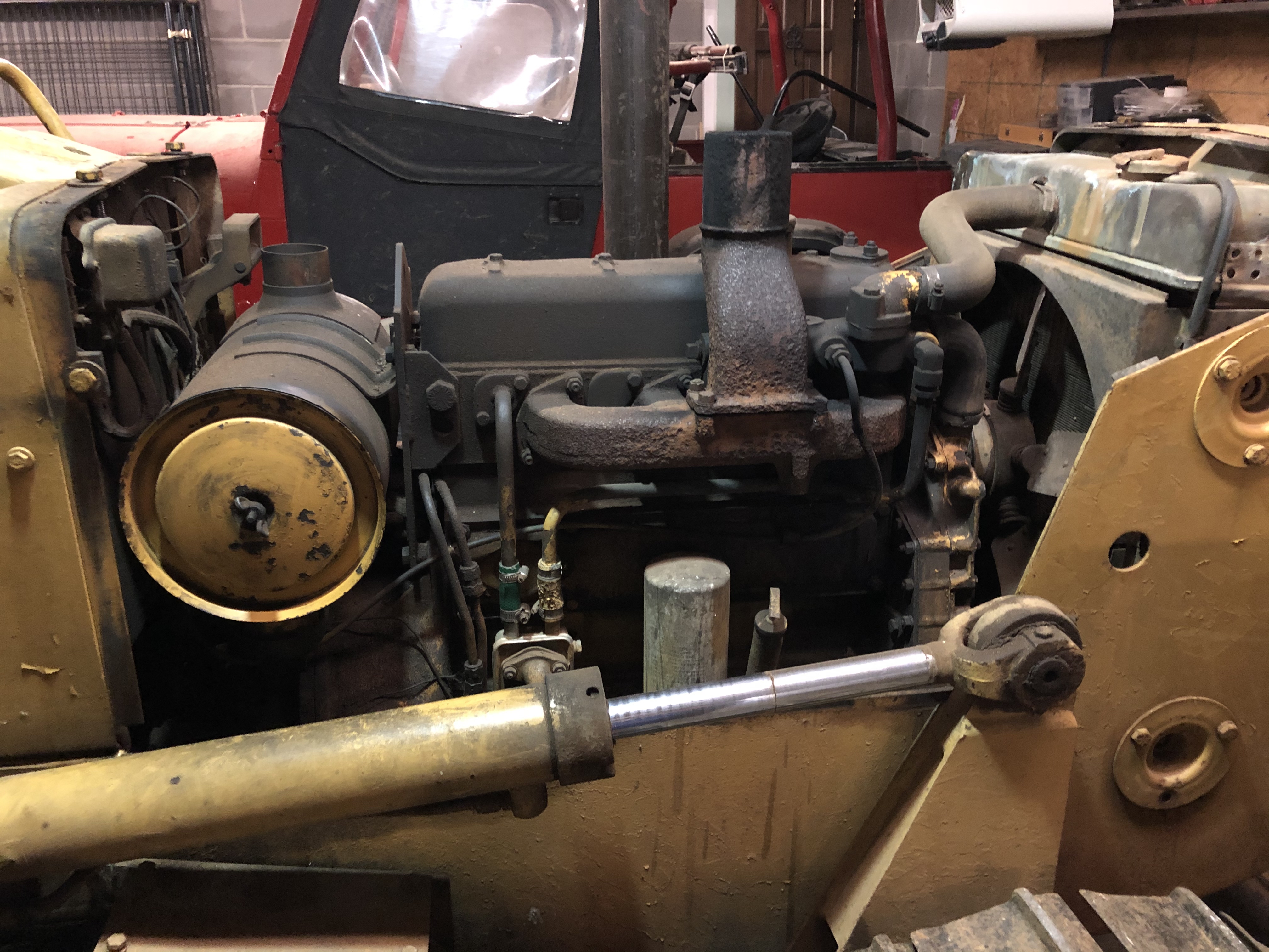

Engine and engine bay painted, motor installed along with other parts (we scratched the engine bay when we were putting the motor back in but I touched it up afterwards):
