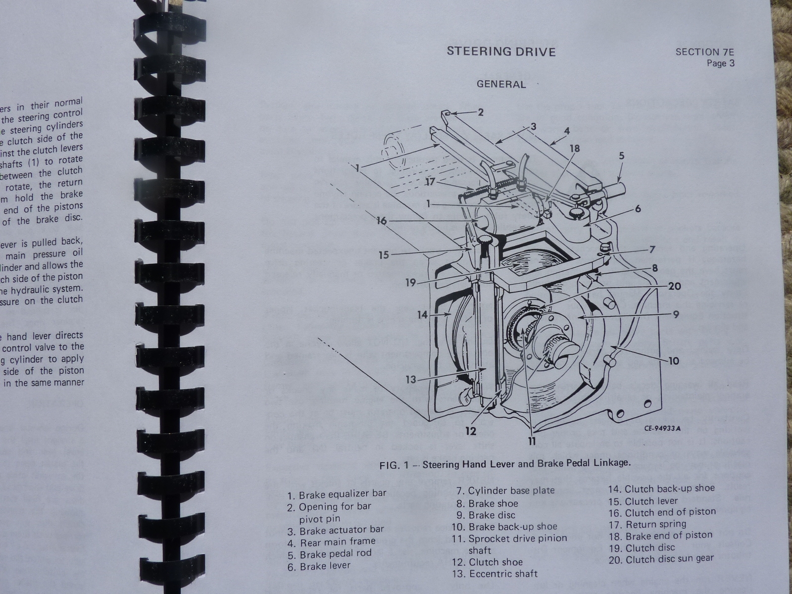

Clutch pressure extends ram end 16 to get drive thru the planetaries. Partial pull back of steering lever removes clutch pressure from end 16 allowing planetaries to spin free and stop drive to sprockets. Full pull back of steering lever uses clutch pressure to extend ram end 18 and apply brake on one side. Foot brake also can apply leverage on the brake levers thru bars 1 and 2 which are weak points. Either the ends brake off of 1 or the pivot point on 2 breaks. If both steering and foot brake, which use the same brakes, are bad, suspect brake pads.

The brake disc can slide on the shaft. When you apply the brake (steering or foot) the brake shoe pushes the disc from the inside against the back-up shoe (10 in diagram). When you tighten the exterior brake adjust bolt it moves the back-up shoe inward toward the disc. Too tight will make the brake drag all the time and wear quickly. If the shoes are worn off it will be metal that wears.

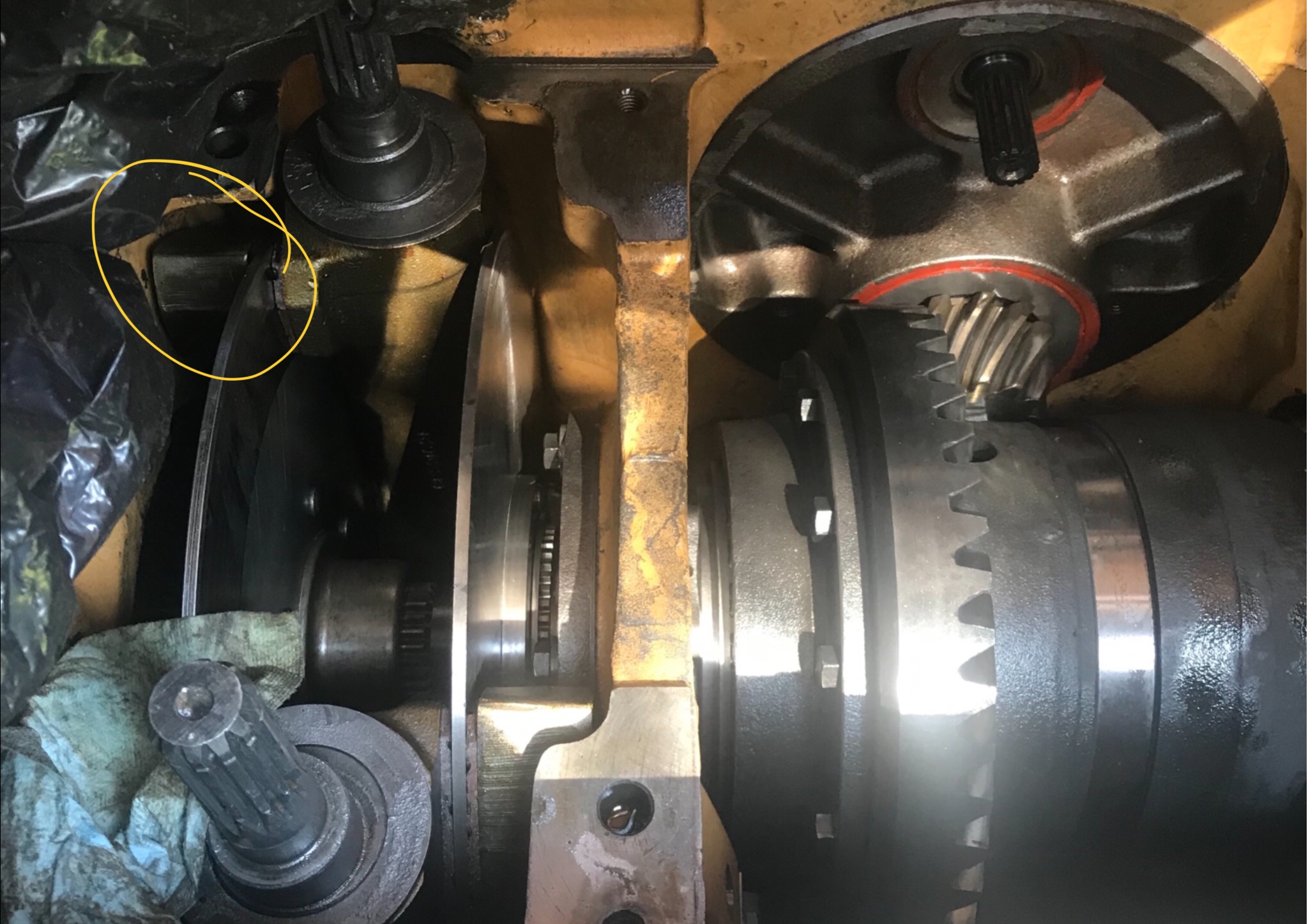

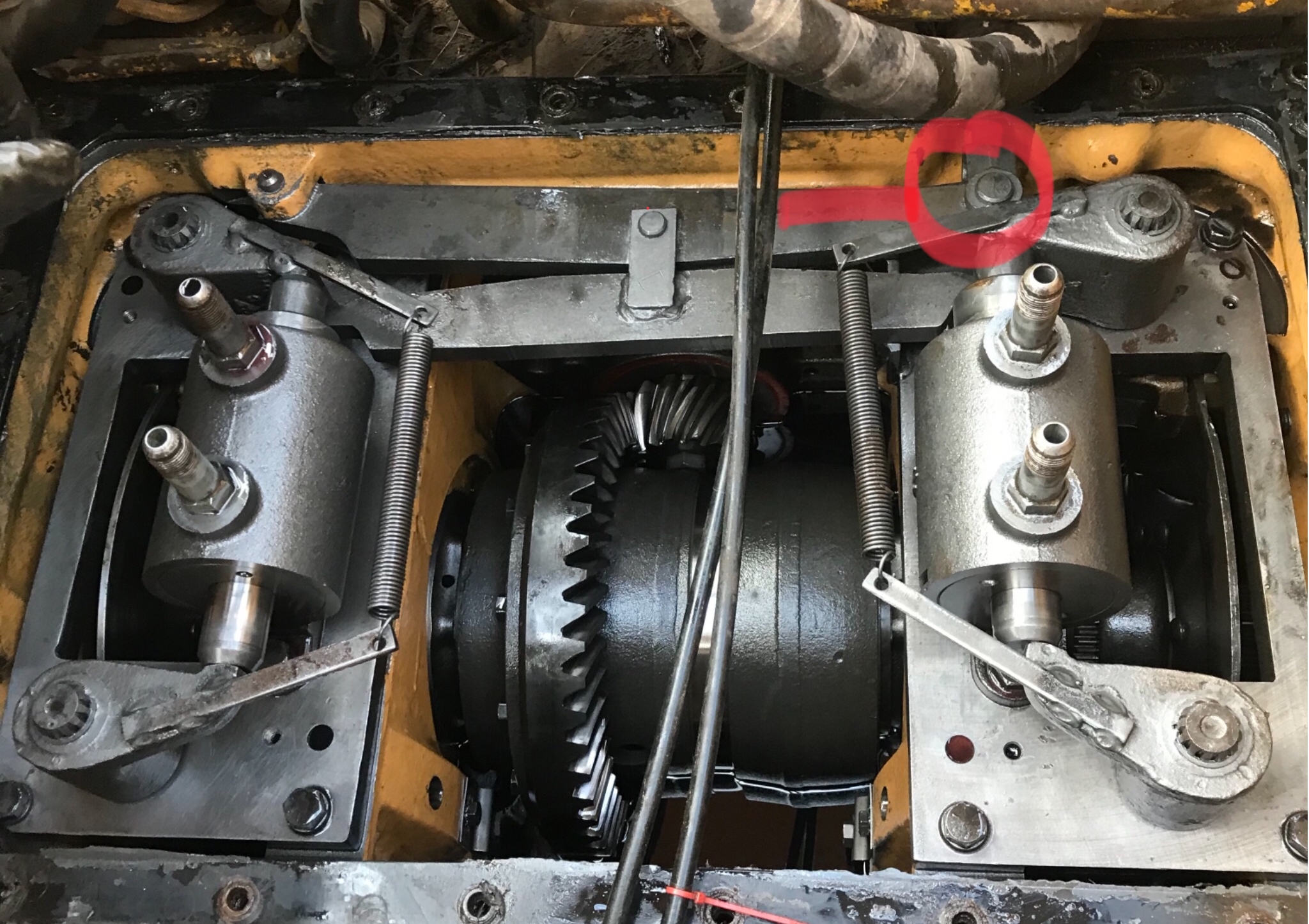

   / td8g dresser steering pump? #15
When you pull the big cover under the seat you’ll see all the goodies, that red circle is where the brake rod connects, simple rod and clevis there, easily fabricated if you can’t find one, in the next photo the actuators are removed, the yellow circle is the outside brake pad, this is what the adjustment bolt on the outside pushes against, the inner disc is what locks the planetary to make the machine move, pretty simple setup, getting to it is a chore but it’s not too bad compared to other machines in my opinion.
