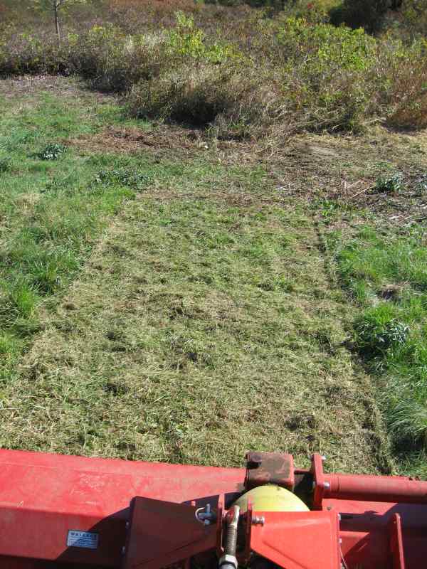

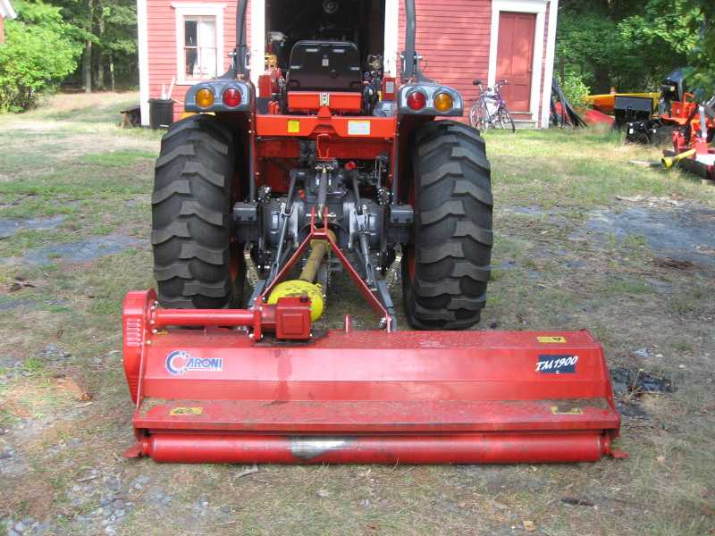

Now consider a flail mower also. Look at threads here for some thoughts. Might be your best options.
I agree. Cutting a pasture is perfect for a flail. You can have a slightly wider flail than rotary cutter (brush hog) using the same HP. As you are not intending to get into heavy brush, you could handle a six foot "medium duty" flail like a Caroni FM1900 for your pasture cutting duties. Cheaper and less delicate than a RFM and gives a better cut with better manuverability than a rotary cutter. Safety and storage space advantages to consider too. I used to have both rotary and RFM but got rid of both and just use the flail now.

So long as you don't buy a heavy duty flail, the prices are quite competitive with RFMs. I believe the Caroni TM1900 (75 inch) can be had delivered for under 2K and for about $1700-1800 if you pick it up at AgriSupply. Hard to get a good quality RFM for those prices.
