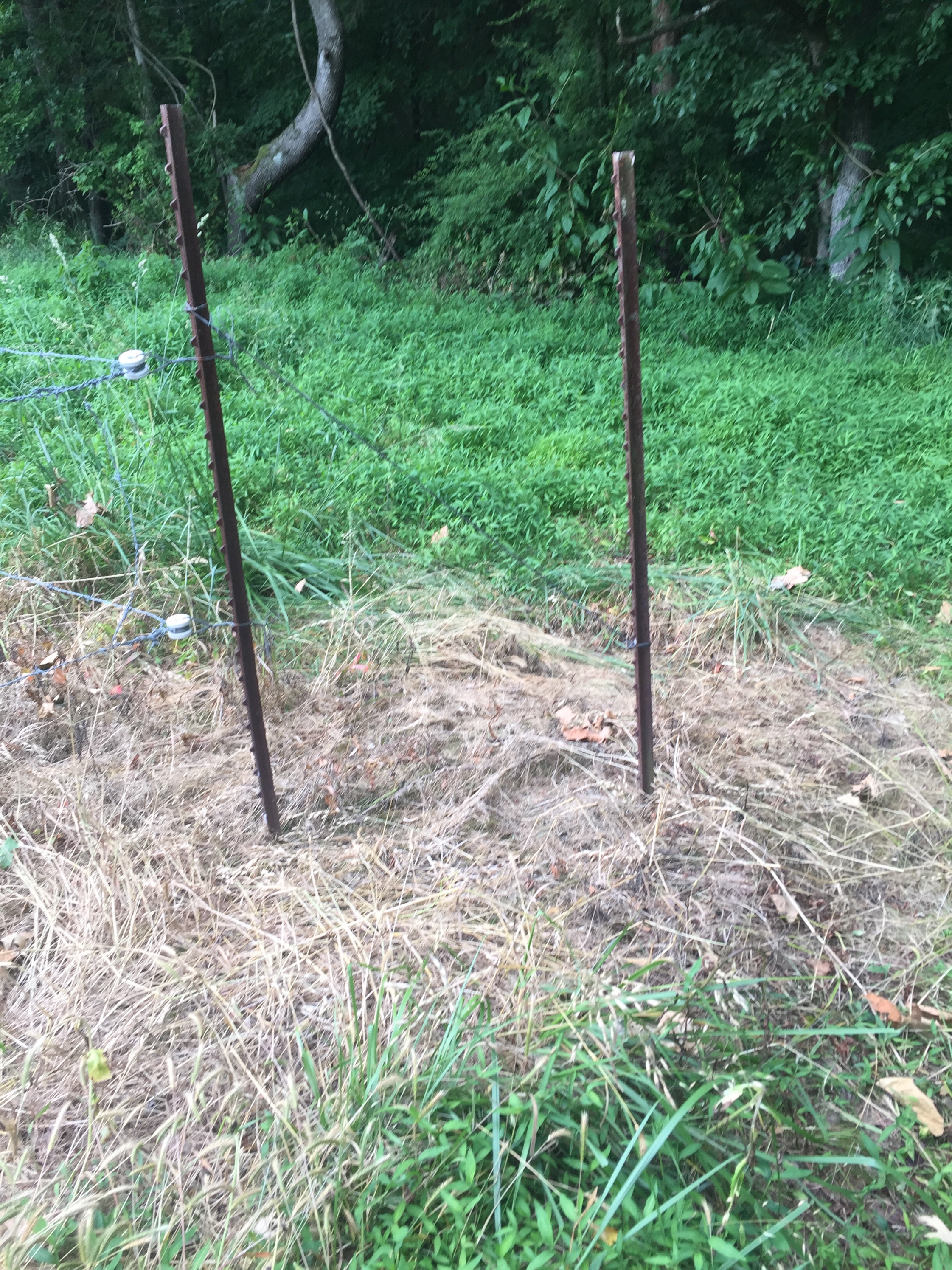

Looks like you've figured out a lot. Good job. Just a couple things I think are worth mentioning.
One thing I see is that as those insulators sit in the sun they'll start to break. Will probably take a couple of years. To avoid this problem I use the round porcelain insulators tied onto post with smooth electric fence wire. Those plastic insulators are made to hold vertical weight not side tension.
The photo below is how I use t-post on problematic corners. Most corners I drive my post at about a 30* angle then let the fence pull it straight. Most places this has held up well, some stay to wet to hold without a brace. IMG_1193.JPG
