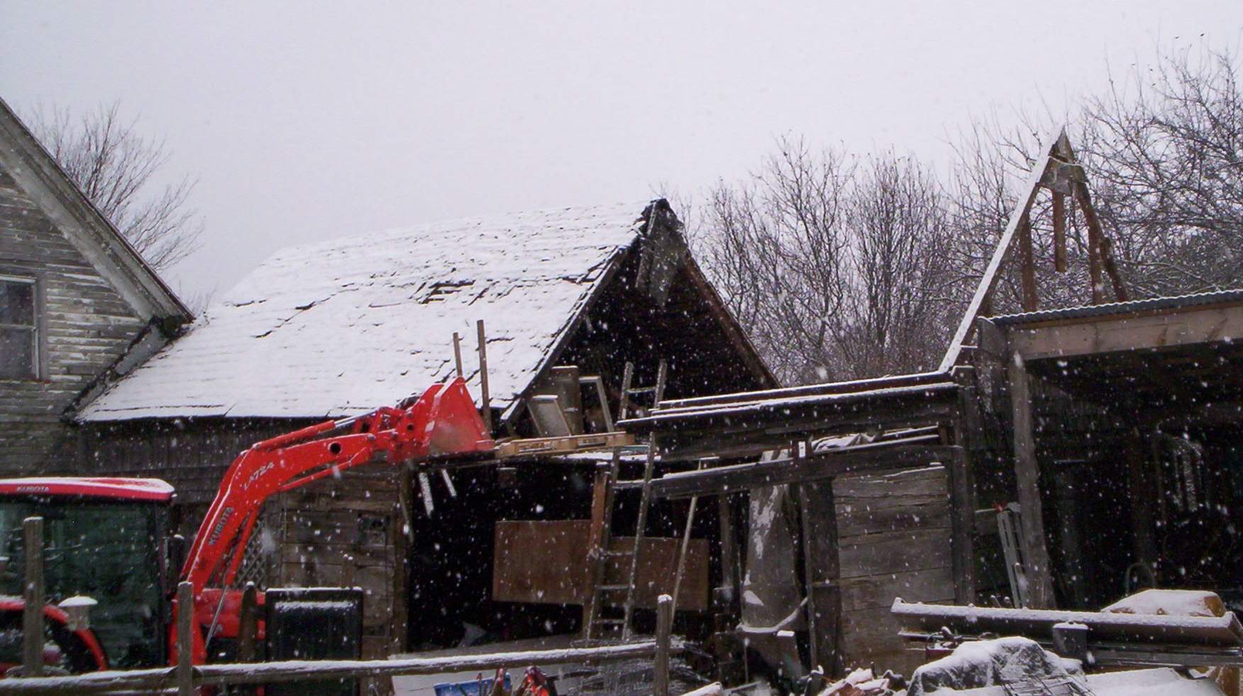

I was able to get a few pic's of the old barn. This is one with the roof half off. In the pic you really don't see just what bad shape the barn was in. I'm not able to put a cable around it because of cost , so I'll take things slow and easy for now.
I'm trying to save the beams , but I'll see if I survive getting the roof off first. As you can see, where the barn was sagging the most is where all havoc broke loose. While taking out the weak part of the roof ,I used a chain to pull down two of the roof rafters so as not to be under it from inside. That's when the section of the roof landed on the second floor and took out half of the top beam and two of the beams , splitting one along the side. The second floor is pretty shaky right now ,but I'm still able to work off of it. I guess I'll just keep taking out roof sections like I've been doing. Having the tractor to haul off the wood to burn is a blessing and a half, just got to watch out for nails.

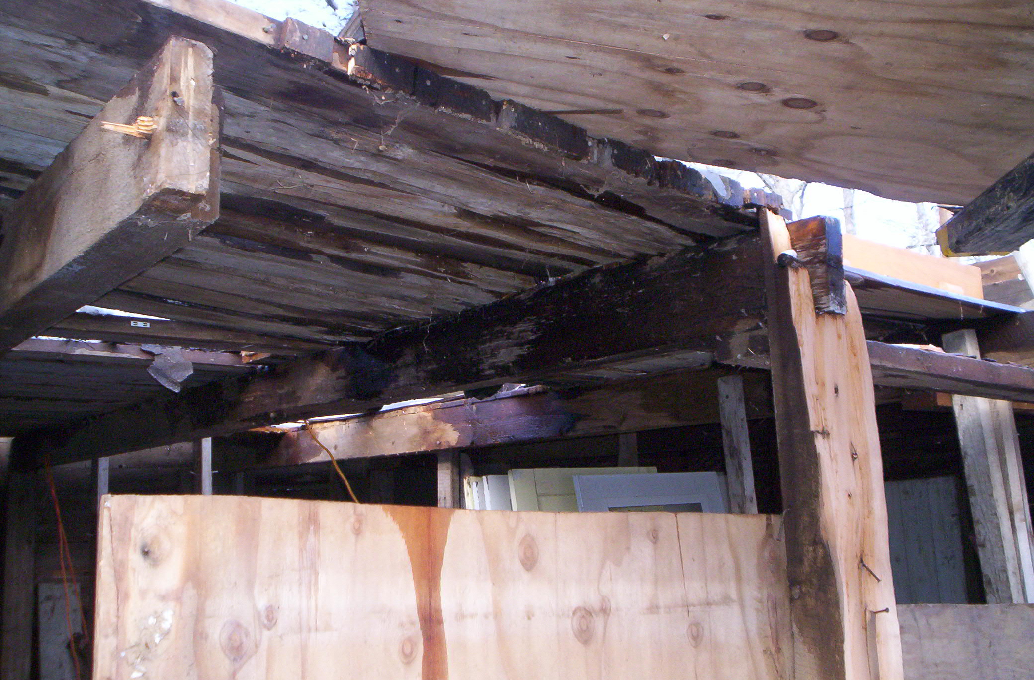

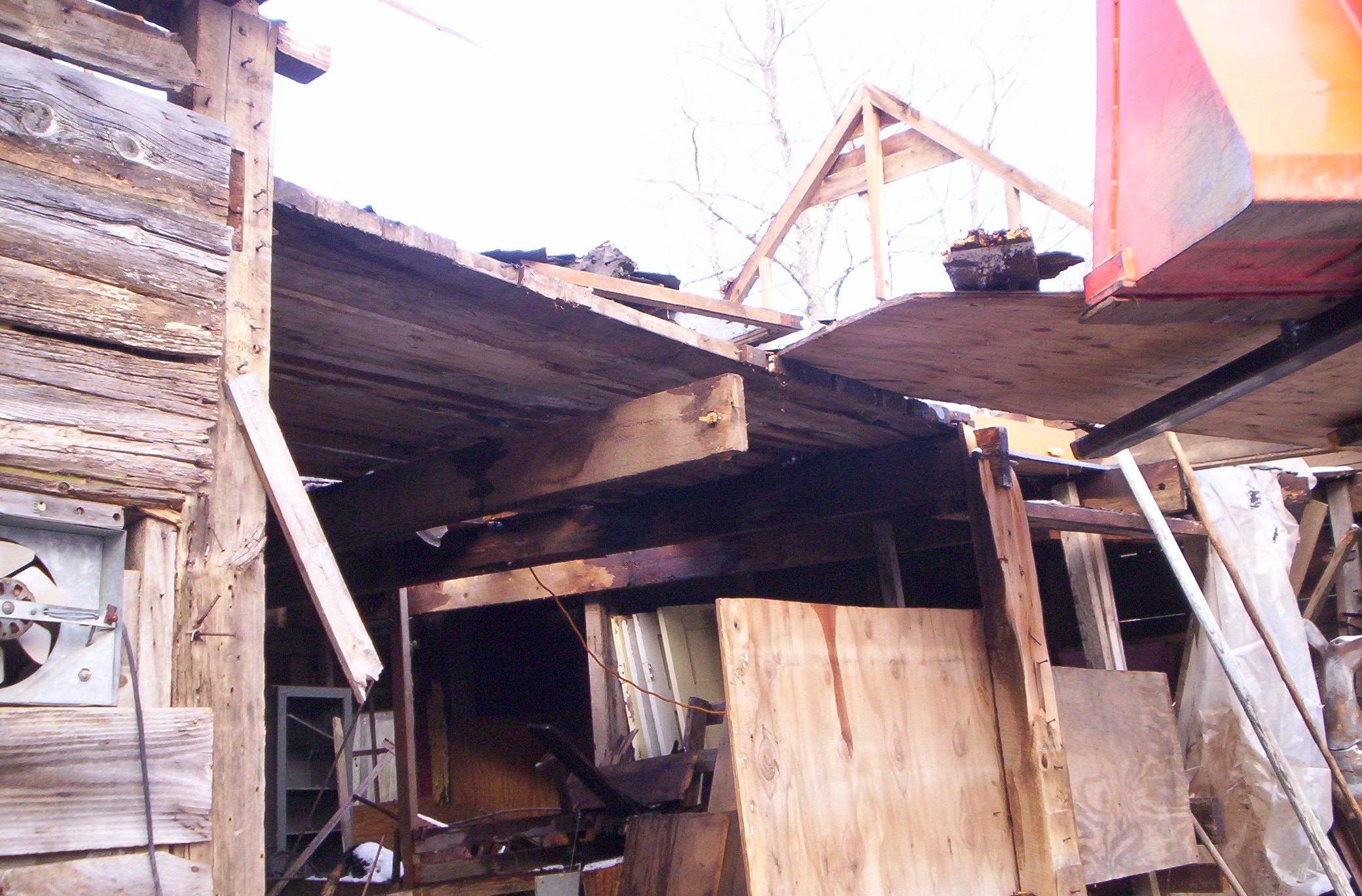

Here are the other pic's

Brings back memories/nightmares. And the barn I was tearing down was free standing. Once you get the roof off it goes pretty easy. I was lucky because we could rip the roof off from inside the barn. We just used sledge hammer to pound the sheeting up off the rafters and let them fall to the ground. 4'x8' sheet of plywood with tar and shingles weighs a lot. LOL
I dont envy you when you get to the house.
