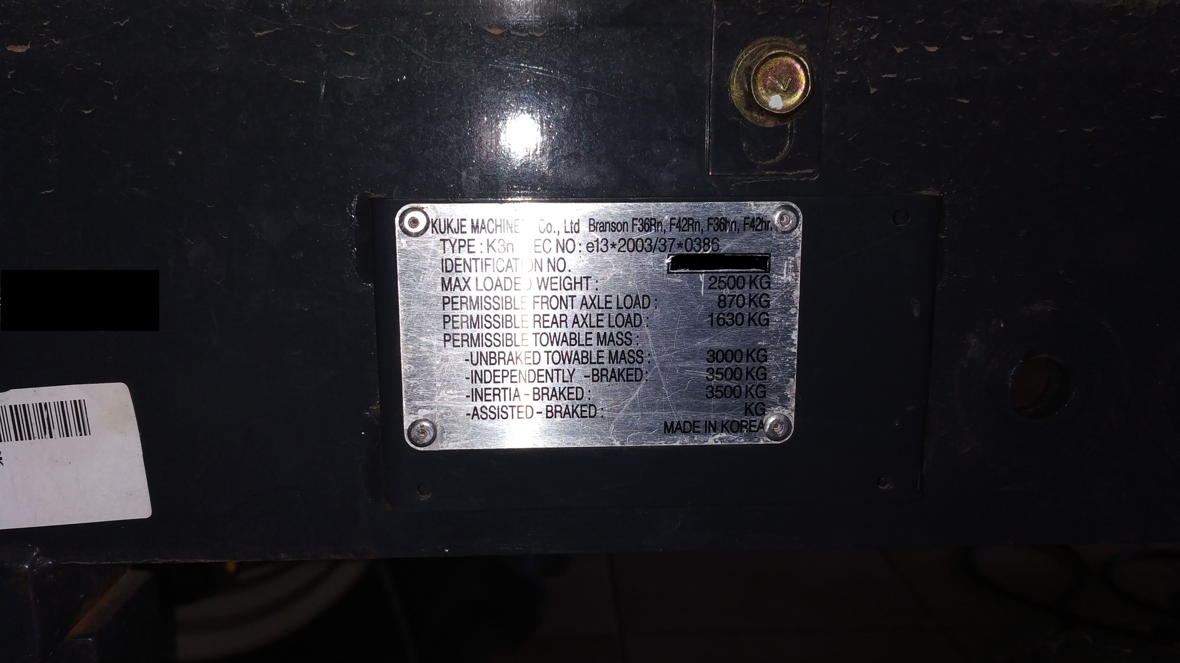

In the US, it's not that common to have see those permissible mass specs, but in Europe, all tractors will have a tag put on, listing the Max permissible mass along with the towing capacities.
Since we don't the OEM loaders here, the aftermarket loaders will have to be rated just under the max permissible mass of the front axle at max height.
Pretty sure these numbers are just a way to manufacturers kinda save their butt in case someone overloads the crap out of the tractor and breaks it in half. Either over loading the loader or the 3 pt, by doing something stupid. Of course the axles will handle much more that those numbers, but it's also not good to work constantly at and above those max permissible mass specs.
Oh and these weights on the tag shown in the picture, are also listed on the title of the tractor. If I get pulled over by the police and they want me to go on weight scales, I can get a fine if I'm overloaded above those specs.
Here is an example of the tag on my tractor:
   / Technically maximum permissible mass #14
